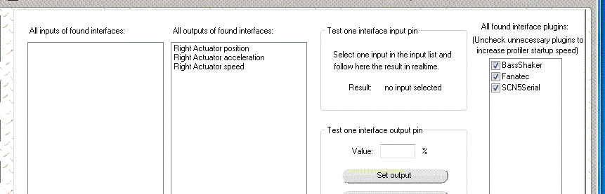

    My left SCN5 actuator is no longer recognized in X-Sim.
    When the software initiates, my chair pulls backward and cockeyed to the left.
    Is there a troubleshooting guide for this issue someplace?

    Try unplugged usb converters and restart your pc, connect then. With me works.

    No dice. Thanks for the advice though.
    All I see under interface settings are right actuator outputs.

    you must delite the regedit go to x-sim/other stoff/RegistryCleaner.but than you must rename the scn5 in the scn5 plugin to left and right again.

    This FAQ Addresses this issue. It is likely that the timing settings section will resolve this for you. Several folks have reported this after a Windows Update occured although it has not been nailed down to a specific update.

    That does it somehow. Thanks!
