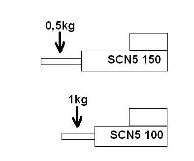

    Dear sirs,

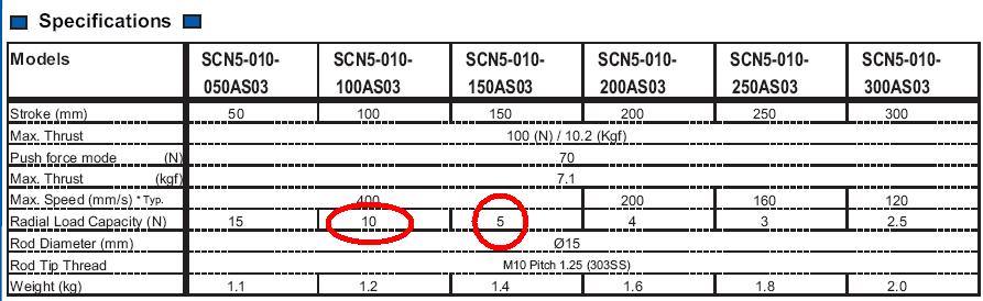

    I have attached a spec sheet.
    Radial load capacity for 100mm is 10N.
    It is 5N for the 150mm.
    I do not know what this even means as of yet but clearly 100mm is stronger in one way.

    However, it should be noted that this decreased rating for the 150mm is only because it extends further. If you only extended it 100mm, it would have the same rating. Dur to the built in limiter and the 25% limiter in the SCN5 plugin, you will have no issues with radial load, and will appreciate the increased travel if you can affiord it.

    Thats right!
    In the end it is not an important factor for the simforcegt desgin, as long as you dont kick them from the side ;D

    Dear sir,
    If you set the 25% limit on the 150mm then you will have only maybe 1cm extra length over 10cm.
    Like a woman say: Size matter :/
    Kind Regards.

    +10 / 1 / -0
    The 100mm have 25% safety limit as well :brows:

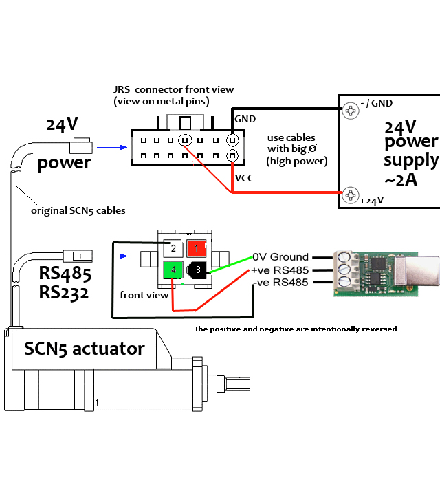

    Each actuator has a power cable and a data cable for a total of two plugs. If you make them yourself, this is a total of four cables. I believe that the Dyadic cables from Mirai combine the power and data into one cable bundle. This means that you would need two of their cables if I'm not mistaken. If you are able to solder, you would be better off to make your own. I believe that you were looking into a FT232R USB based adapter. If that is correct, then you would be able to wire it directly to the cables on the actuator yourself. Fair warning, if you cut the plugs off of the actuators the warranty is void so some folks have purchased matching plugs.
    Here is a wiring doagram that should help you. It depicts the way that my SCN5 is connected to the FT232R USB adapter.

    Dear sir,
    Thank you. I have coped this diagram into my folder on pc.
    Would this be the same diagram I use to 150mm actuator. I am sure that everything should be same design.
    Kind Regards.
  15. bvillersjr
    bvillersjr Active Member
    Oct 11, 2008
    1,174
    Ohio, USA
    438Coins
    +23 / 1 / -0
    I only have 150mm actuators, but I believe this will work for 100mm as well. If noone has told you yet, be sure to wire them up based on the pinouts, not the wire colors. I have been told that Dyadic is not consistent with wire colors.

    If you buy the power wire from them, the brown is the ilk wire as the extension cable colors don't change (or so they said), so the brown should go to the pin ilk from the drawing. If you make your own go by the pins.

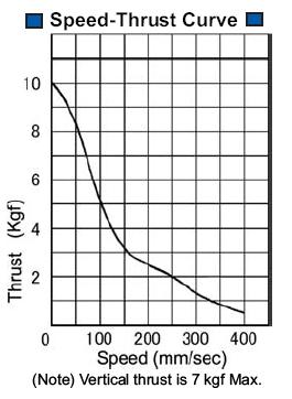

    Dear sirs,
    This is a diagram from spec sheet of a scn5 actuator.
    Vertical thrust is only 7kg max. So this maybe why you guys say have actuator angled. And not fully upright.
    Nice diagram though to see variation etc.
    I was thinking about posting diagram of SCN6 but it only does 200ms speed. I do not know if that is fast enough to react in accordance to that of a game (x-sim software).
    Kind Regards.
