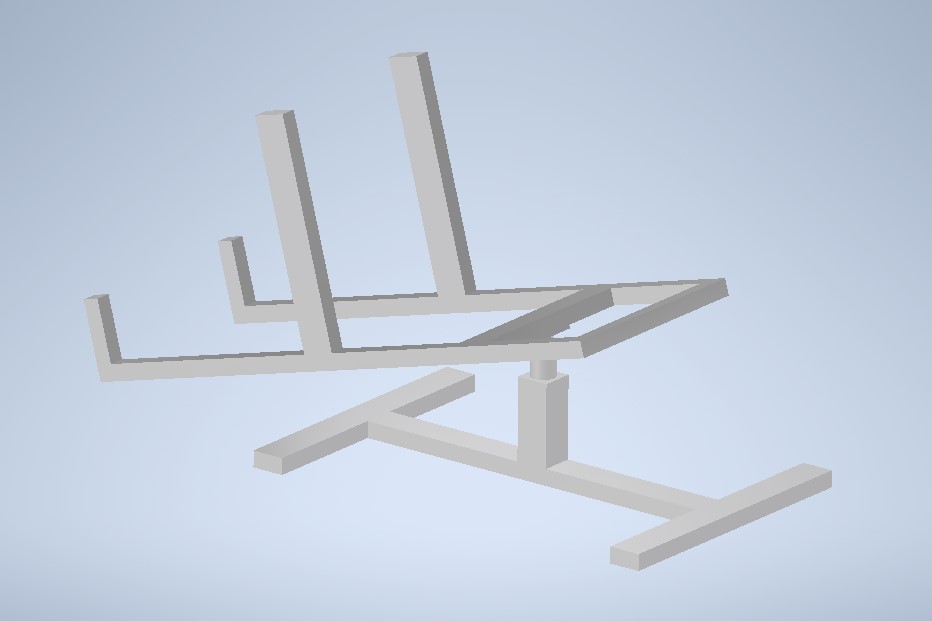

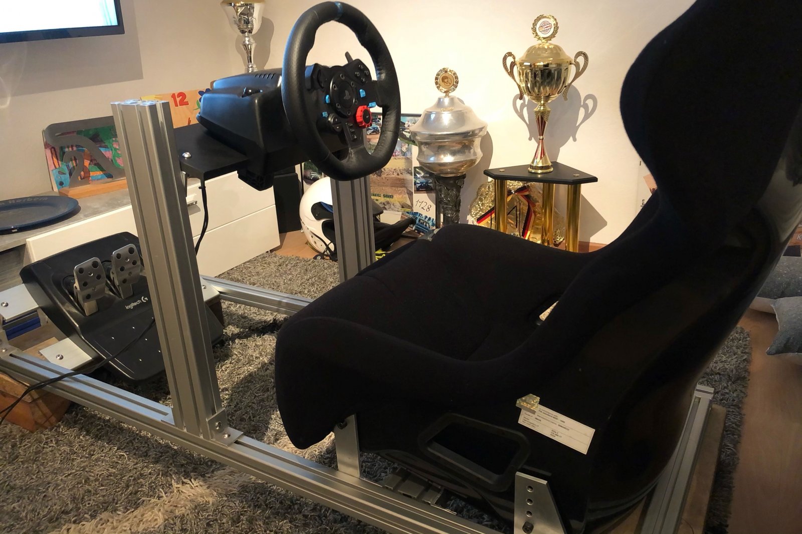

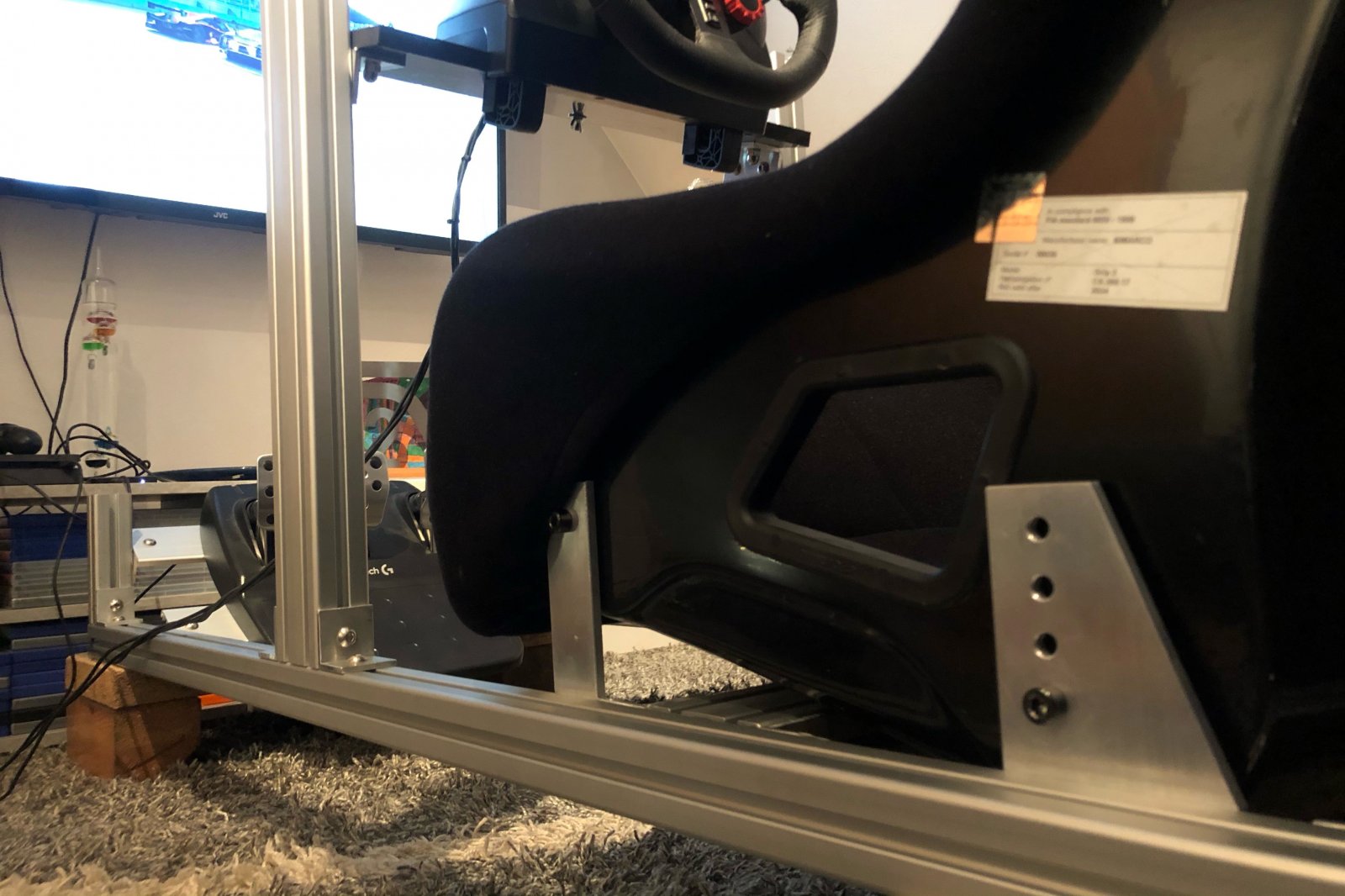

    Hey guys,
    My name is Lucas. I am 19 years old, come from Germany, am a hobby racer (rallycross) and go to a high school of technology. As a school project, I now set myself the task of building a racing simulator for Playstation4!
    For the beginning in Simracing I bought a cheap simulator scaffold and drove with the Logitech G29. Now I want to build a more stable and movable scaffolding. I'll document the progress of the project here in this thread:
    The Logitech steering wheel, as well as the pedals, will continue to be used for the time being. I take the seat out of my racing car for now, because due to Corona, car racing is currently rarely possible.
    And I opted for an aluminium structure for a lighter, stiffer and more scalable simulator.

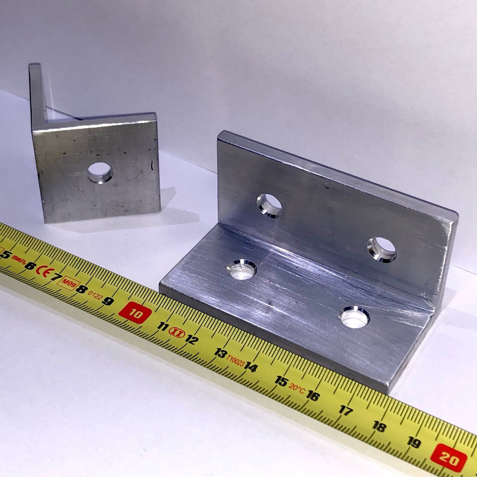

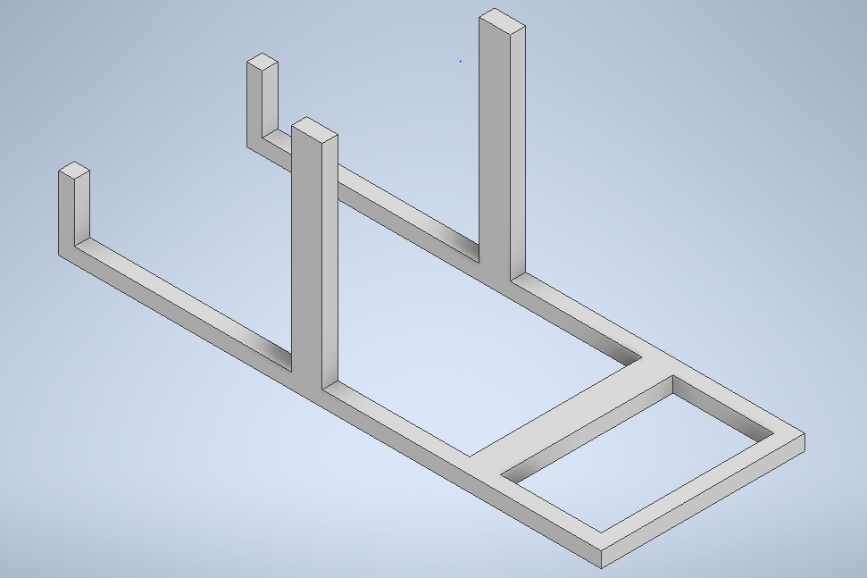

    First I made a 3D drawing of the moving part of the simulator, then the angles, as well as the seat and pedal mount made of aluminum and assembled everything. Since the steering wheel requires a larger base, I've made a light and stable plastic plate for this.
    This is just the beginning! I first need to calculate the force the two motors have to apply and then buy all the accessories.

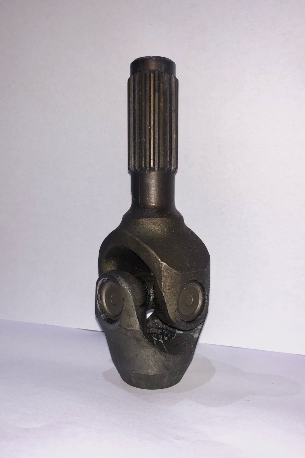

    Here's a cardan joint from an old BMW motorcycle:
    With some grinding and welding I repurposed it for the sim:
    Now the sim should look like this:

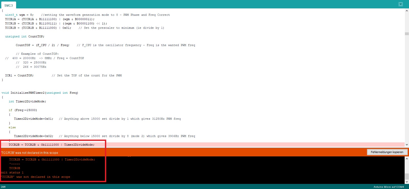

    I work with the Arduino Micro and IBT_2 and use SMC3. When I upload, this error occurs in my code:
    This is the entire error code:
    Arduino: 1.8.13 (Windows 10), Board: "Arduino Micro"
    C:\Users\Lucas\Desktop\SimTools\SMC3 v1.0\SMC3\SMC3.ino: In function 'void setPwmFrequency(int, int)':
    SMC3:259:13: error: 'TCCR2B' was not declared in this scope
    TCCR2B = TCCR2B & 0b11111000 | mode;
    C:\Users\Lucas\Desktop\SimTools\SMC3 v1.0\SMC3\SMC3.ino:259:13: note: suggested alternative: 'TCCR0B'
    TCCR0B
    C:\Users\Lucas\Desktop\SimTools\SMC3 v1.0\SMC3\SMC3.ino: In function 'void InitialisePWMTimer2(unsigned int)':
    SMC3:296:5: error: 'TCCR2B' was not declared in this scope
    TCCR2B = TCCR2B & 0b11111000 | Timer2DivideMode;
    C:\Users\Lucas\Desktop\SimTools\SMC3 v1.0\SMC3\SMC3.ino:296:5: note: suggested alternative: 'TCCR0B'
    TCCR0B
    exit status 1
    I'm not so far with coding of Arduino. But as I understand it correctly, TCCR2B does not exist and I should replace it with TCCR0B. I'm not sure. Can someone help me?

    Hi Lukas,
    in my trials I started with an Arduino Mega and also got some coding problems. Better to use the Arduino Uno as SMC3 is designed for it. I think coding of Arduino is connected to the Arduino Hardwareadresses and maybe the Micro is different to the Uno, this was the case for the Mega.
    BR
    Chris

    Thank you Chris, the motors are moving!

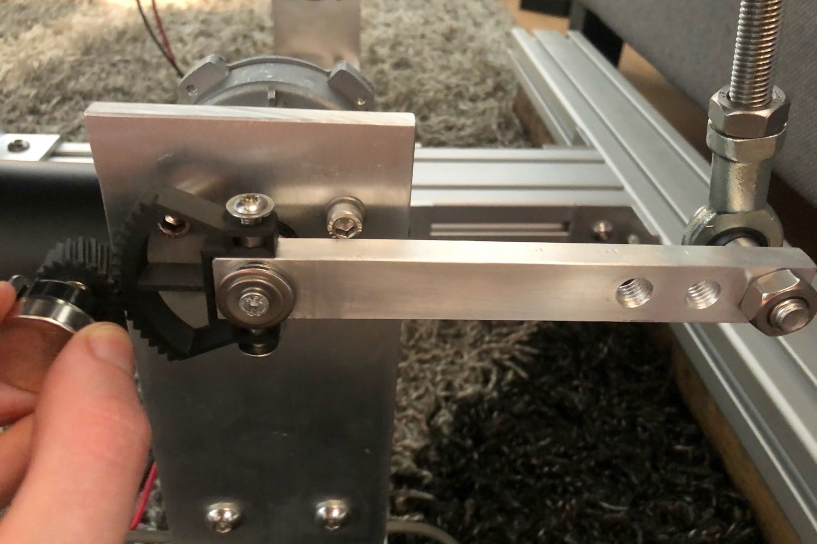

  13. noorbeast
    21,603
    151,275Coins
    +11,033 / 56 / -2
    Great you got the motors moving :thumbs

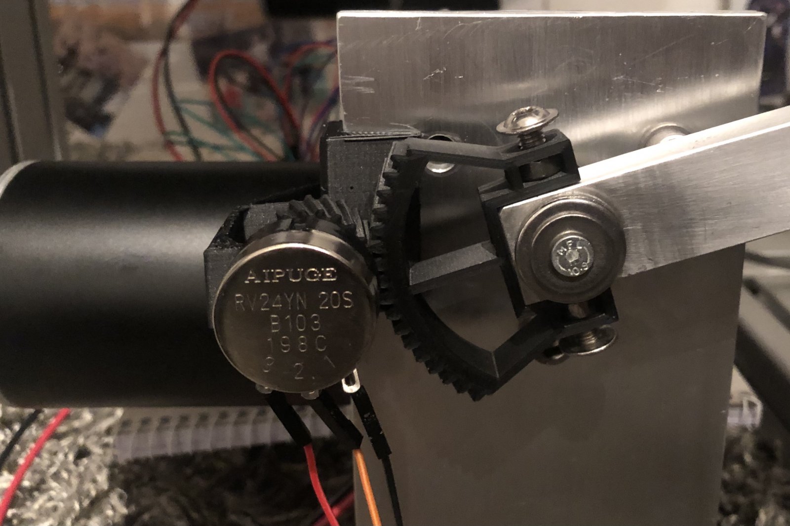

    The CTC distance on those levers looks really large, you may need to shorten that back a bit, particularly as it is a full frame rig.
    How are the pots going to mated to the motors?
  14. Lucas Wollering
    Lucas Wollering New Member
    Dec 11, 2020
    19
    Student
    87Coins

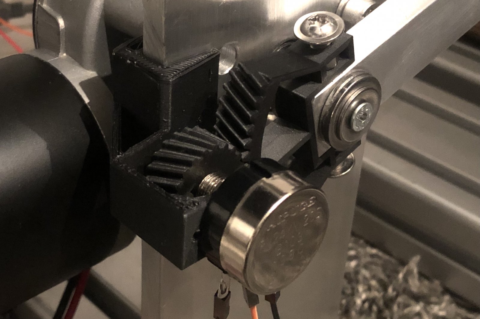

    I also think that it will be a bit too large, but I try. The lengths are 100, 120 and 140mm.
    I've already construct the gears to match:
    They're translating 3 to 1. I will print a mount for the pots with 3d printer in near future.

    Great to see your progress. First movement is a Milestone. :thumbs
    I really like your way to mount the gears.
    I agree with noorbeast, the Leverkusen may be to long, shorter CTC distance will be more torque for the motors and woth a full frame rig you won't need this large travel distance.
    BR
    Chris
  16. noorbeast
    21,603
    151,275Coins
    +11,033 / 56 / -2
    I think you mean they CTC measurements from the motor shaft are 100, 120 and 140mm, I suspect you will likely find they need to be about half that for adequate torque to drive the rig when fully loaded.

    I think you’re all right, especially because of your experience. Just want to try it myself and test the limits. That's why the sim is fully customizable.

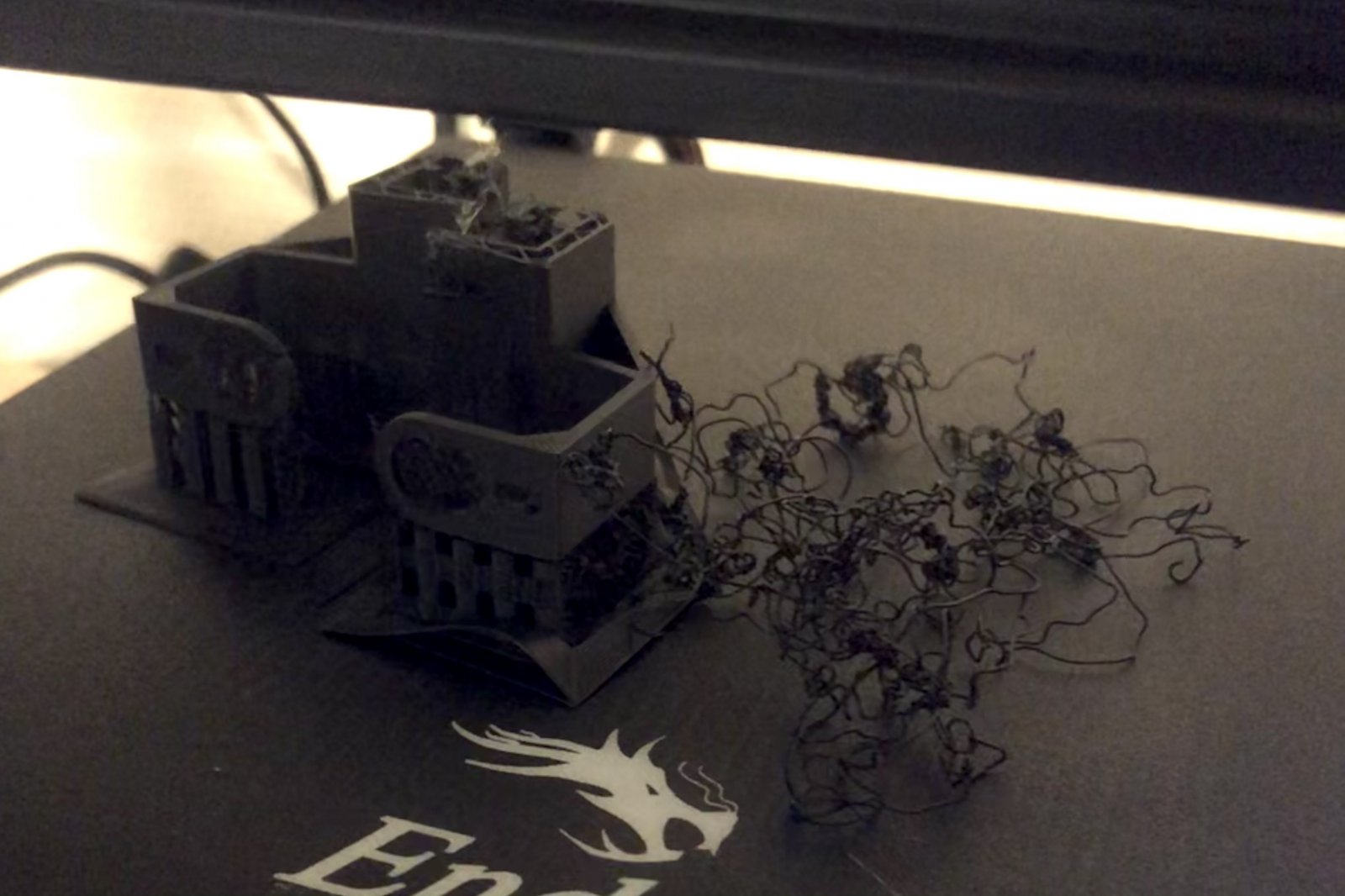

    Printed the pot mounts over night and something went wrong...
    But for testing it works fine. Looks good and stable:
