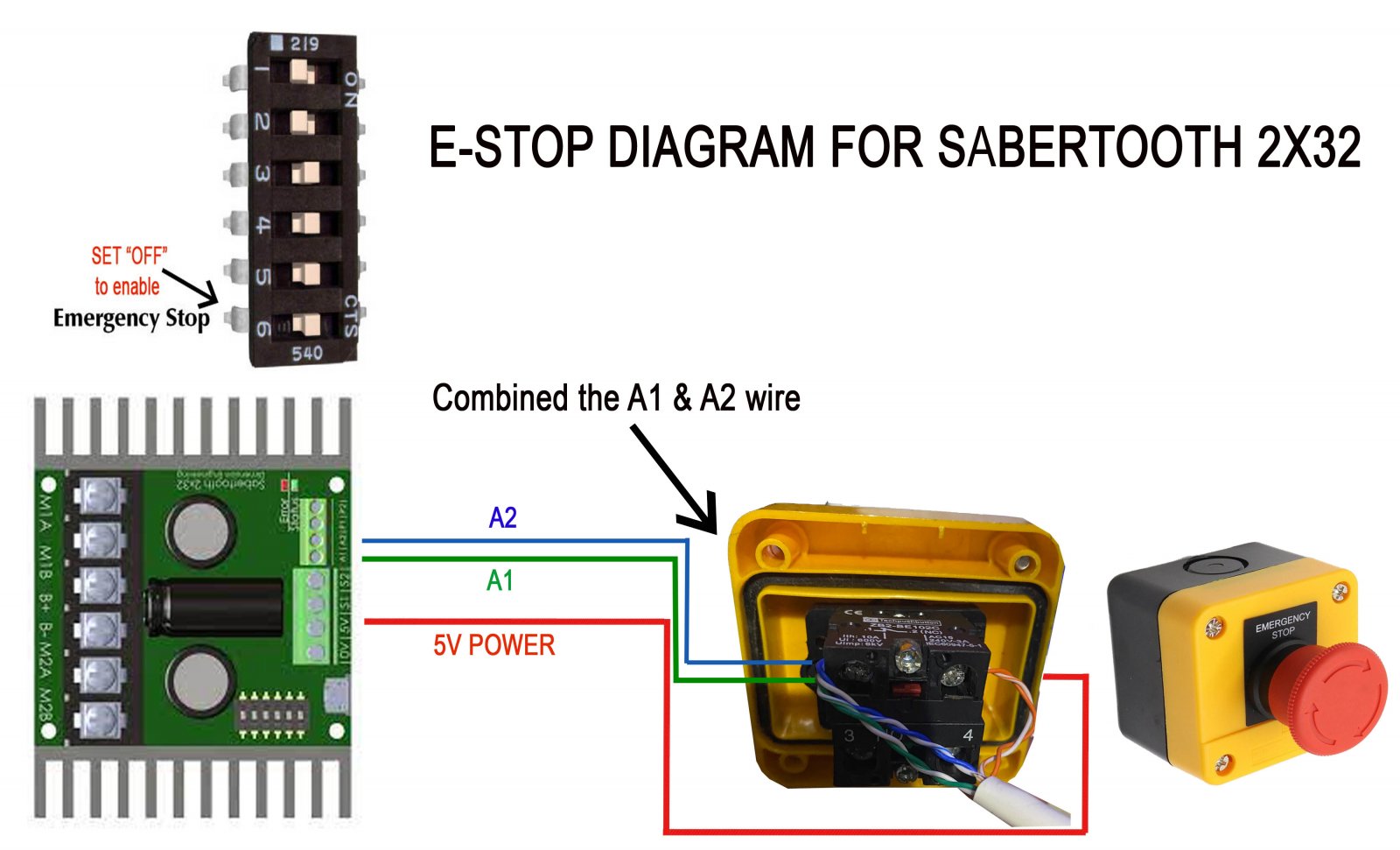

    I have seen some people use relays to stop motion while using the Sabertooth 2x32 V3 board. Reading at dimensionengineering datasheet I have found an interesting part:
    DIP Switch 6 enables or disables emergency stops. If DIP switch 6 is in the OFF position, emergency stops are enabled. This emergency stop is active low and internally pulled down. To enable the M1 output, connect the A1 terminal to 5V. To enable the M2 output, connect the A2 terminal to 5V. If these connections are broken and emergency stops are enabled, the motors will stop immediately. This might be used for a safety E-stop in a machine, to only allow motion while a dead-man switch is held, or to detect a disconnected control cable.
    Then my question is, why use relays to stop the motion if something goes wrong if we just can wire the E-Stop directly to the board for each motor?
    This is a diagram found on www.allaboutcircuits.com and you can see what I mean. Ignore Joystick part.

    I have wired that way my actuators, also taking the 5v from the Sabertooth 2x32 V3.

    Sorry, I had dismantled all for now, I hope I can continue with the project next month, but I did what the sabertooth 2x32 manual says, I put a cable on the 5v, run that cable around the end stops of the actuators and back to A1 of one of the sabertooths, or you can run each one of the actuator to every A1 and A2 of the current sabertooths.

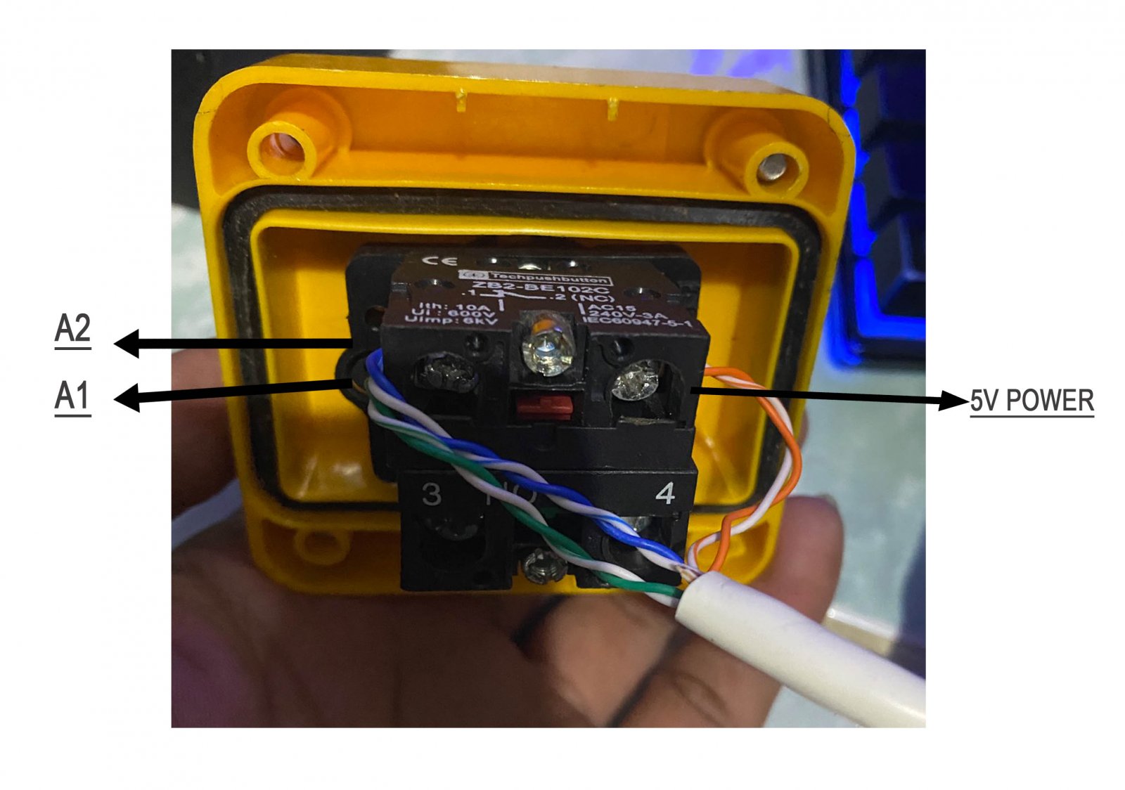

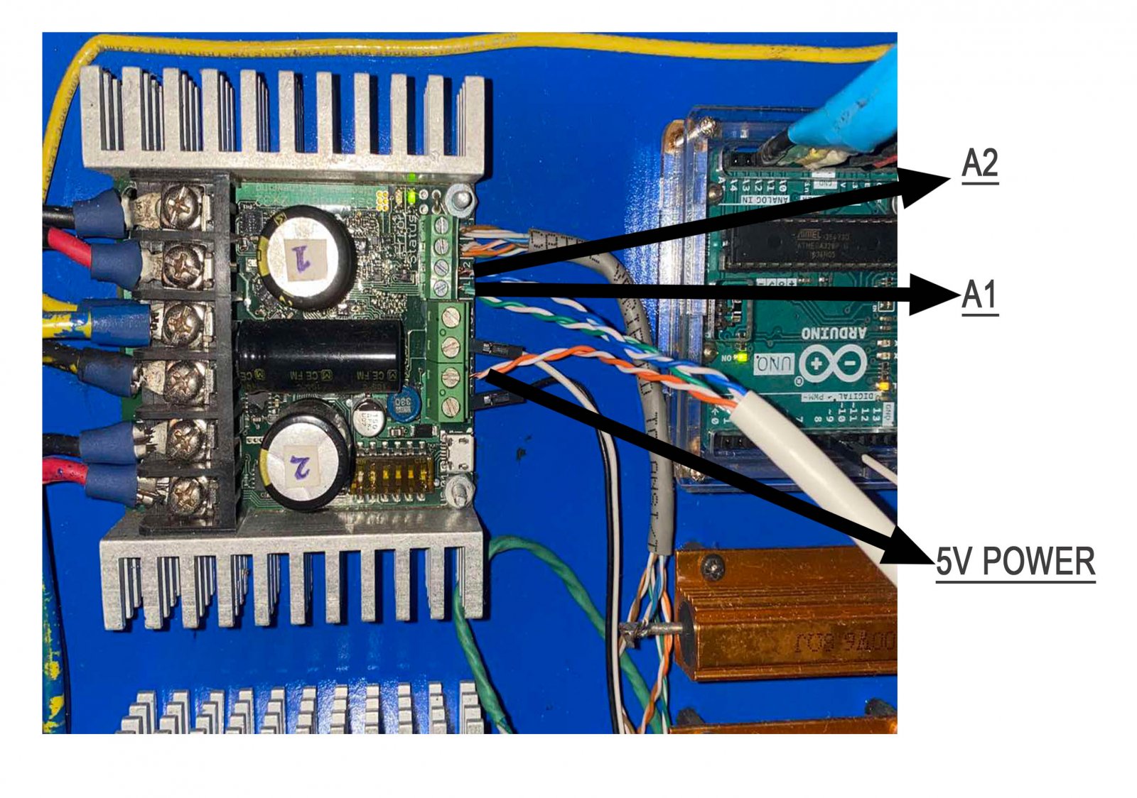

  13. MENANDRO DALIDA JR
    MENANDRO DALIDA JR Member
    Apr 19, 2019
    53
    51Coins
    +17 / 0 / -0
    Sharing my Emergency Stop diagram for Sabertooth 2x32. It works :thumbs E-STOP DIAGRAM FULL.jpg
