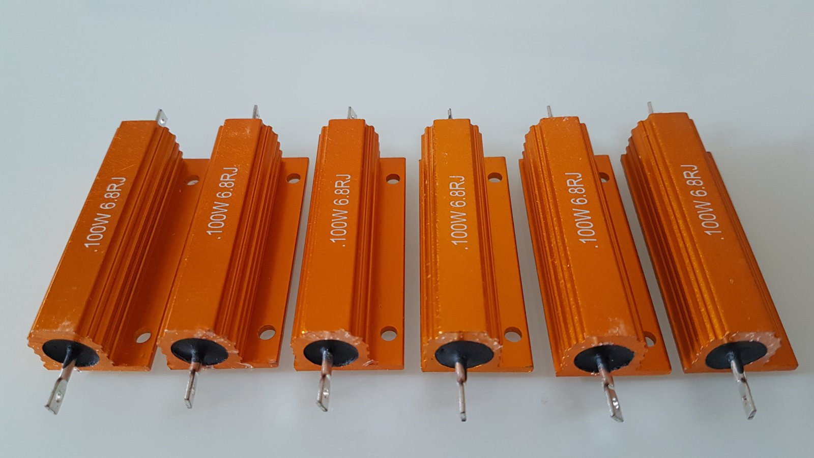

    I also had some difficulties understanding which resistors to use. I contacted Dimmension Engineering and as I understand it know:
    You are using 450W motors at 24 volts which comes to 18.75A
    The maximum current de Sabertooth 2x32 can disapate is 8A, so this is the value you have to use in your case.
    So 8A x 24V = 192W which you can disapate per side (P1 and P2) so in total 384W, please correct me if I'm wrong.
    And the resistor you would need per side is 24V / 8A = 3 Ohms which can handle at least the 192W so lets say 200W.
    The 200W resistors are expensive and not so available. So you can either use 2 x 1.5 Ohms 100W reistors in series per side.
    Or 2 x 6 Ohms 100W in parallel per side.
    The last one is also what I'm going to try I ordered 4 of the 6 Ohms 100W resistors from Aliexpress, which will arrive next week.

    I have 3 24v and 350w engines and with the calculator I also get a resistance of 3 ohom and 192 w for each motor.
    I bought this aluminum resistance of 3 ohms and 100w, but nobody told me ok, let's hope it's enough.
    I've seen photos of other systems, but with resistances of 1 ohom 10w ..... and I've never seen 192w resistors ..... bohhh!
    Perhaps the regenerated energy never reaches a maximum of 192w and therefore a lower resistance is also sufficient.

    Hello Fabio,
    I received my resistors last week and connected them to my Sabertooth 2x32. They do help but not as much as I hoped.
    My power supply is still tripping.
    What I also noticed is that on connection P2 more power is disapated than on P1?
    I checked this by measuring the voltage over the 3 ohms resistance while I had SMC3 generate Square waves.
    Didn't matter if Motor 1 or 2 was running.
    I haven't found out why yet.
    I'm wondering if this is the same for you?
    Also my resistors aren't getting warm at all, probably this is because they aren't in use constantly. So mayby your 100w versions will survive.

    I have just arrived ... here they are!
