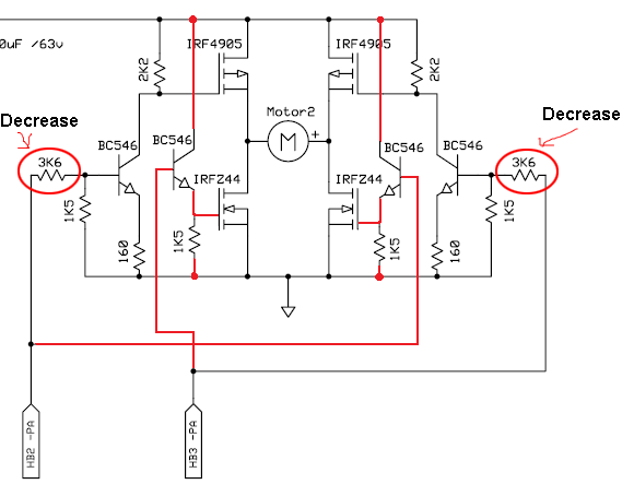

    Hi Adam!
    We have tested your modification and it works, but not quite. Now we have about 12v - z44, 8v - 4905. loss of voltage currently about 0,3 v on both mosfets's and much less heat. We think that it is necessary reduce the resistance as we have show in the figure. Today we did not have resistors and the time to check it. If possible, we try it tomorrow.
    WBR, Nickolay.
  6. Frakk
    Frakk Active Member
    Apr 15, 2009
    1,144
    328Coins
    Oops! You are right Nickolay! I overlooked that part.
    Now with the modification we introduce a parallel resistance, routing the current away from the top. You can take out the 1.5K resistor completely and replace 3.6K to 1.5K. It should work fine like that. For the high-side transistors, you should be measuring between gate - Vcc (source) and not gate - Gnd (drain). Fig.3 in the datasheet shows you should have about 8-12V.

    Are you referring to R5 and R7 in the original post?
    R5/R6 and R7/R8 is a voltage divider, and you are right, there is no actual resistor. The transistor acts as a variable resistor, you pump current through it's base, resistance between collector/emitter goes down. No current through base, the transistor has an infinite resistance (in theory). The 1.5K pulls the gate down to 0V without the signal, and also shunts the current down to prevent oscillation. I don't think anything else is needed, although I would love to look at the circuit with an oscilloscope.
    Gate driver ICs like the HIP408x or IR2110 will require a small series resistor because currents flowing directly in and out of the gate. With a voltage divider situation, the gate is only tapping into the current flow where the voltages turns it on.

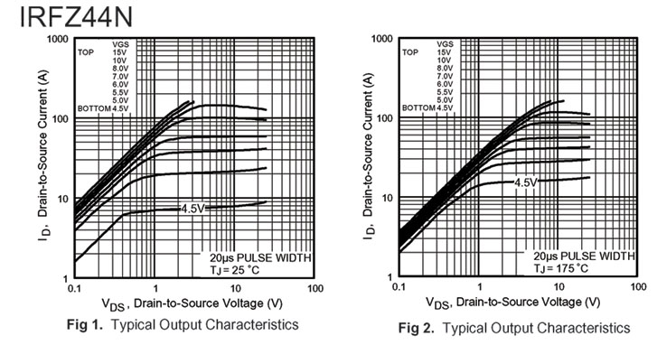

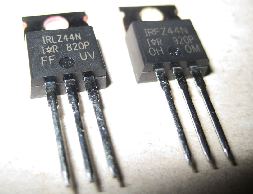

    Hi All!

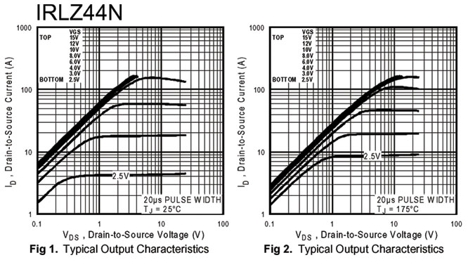

    We failed to alter H bridge on the advice of Adam. We are working with only one connected bipolar transistors. That is, we tested only in one direction. Once we set the second transistor, we obtain a short circuit. We tried various ways, but unfortunately we did not work. But we found a different solution. We replaced the mosfet IRFZ44 at logic level mosfet IRLZ44. They are heated much less. Now we have a normal working HBridge and now we continue our project.
    And so we are very pleased to see that Adam is continuing its project to develop HBridge. We are ready to do it immediately after the tests.
    WBR, ru.null
  17. ru.null
    ru.null Member
    Feb 24, 2010
    46
    Petrol stations tech support
    Russia, Rostov-on-Don
    290Coins
    Photos and pictures from datasheets of both mosfets.
  18. Frakk
    Frakk Active Member
    Apr 15, 2009
    1,144
    328Coins
    Perhaps the simplest solution is to use the logic level transistor. I don't know why you got shorts, but now that you fixed the overheating it doesn't matter. I will keep you updated with my h-bridge, it is hard to find time and resources I need for development :(

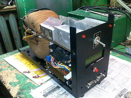

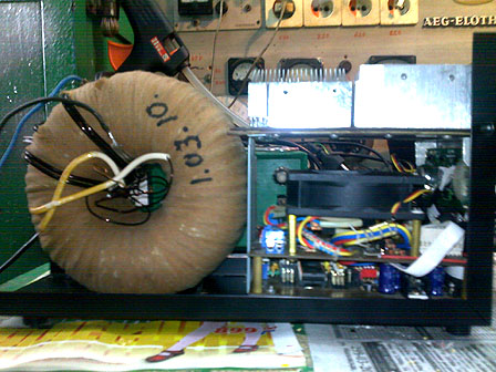

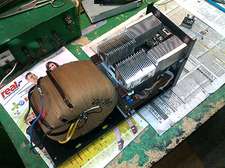

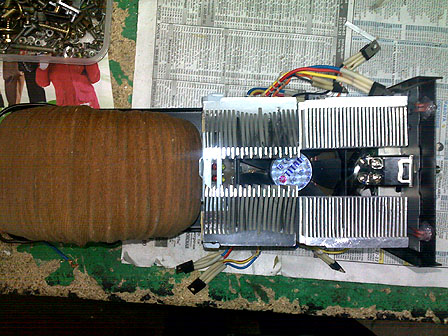

    Hi All!
    Some updates. We install the electronic and electrical components in a single enclosure. Old UPS.
    And also we filmed the video with all connected components in action.
    http://www.youtube.com/watch?v=ZwB7ODoS0g8
