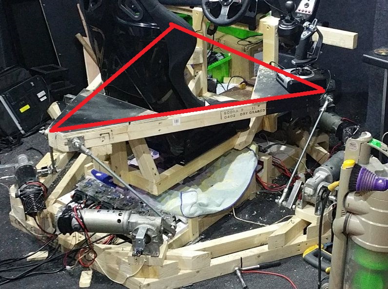

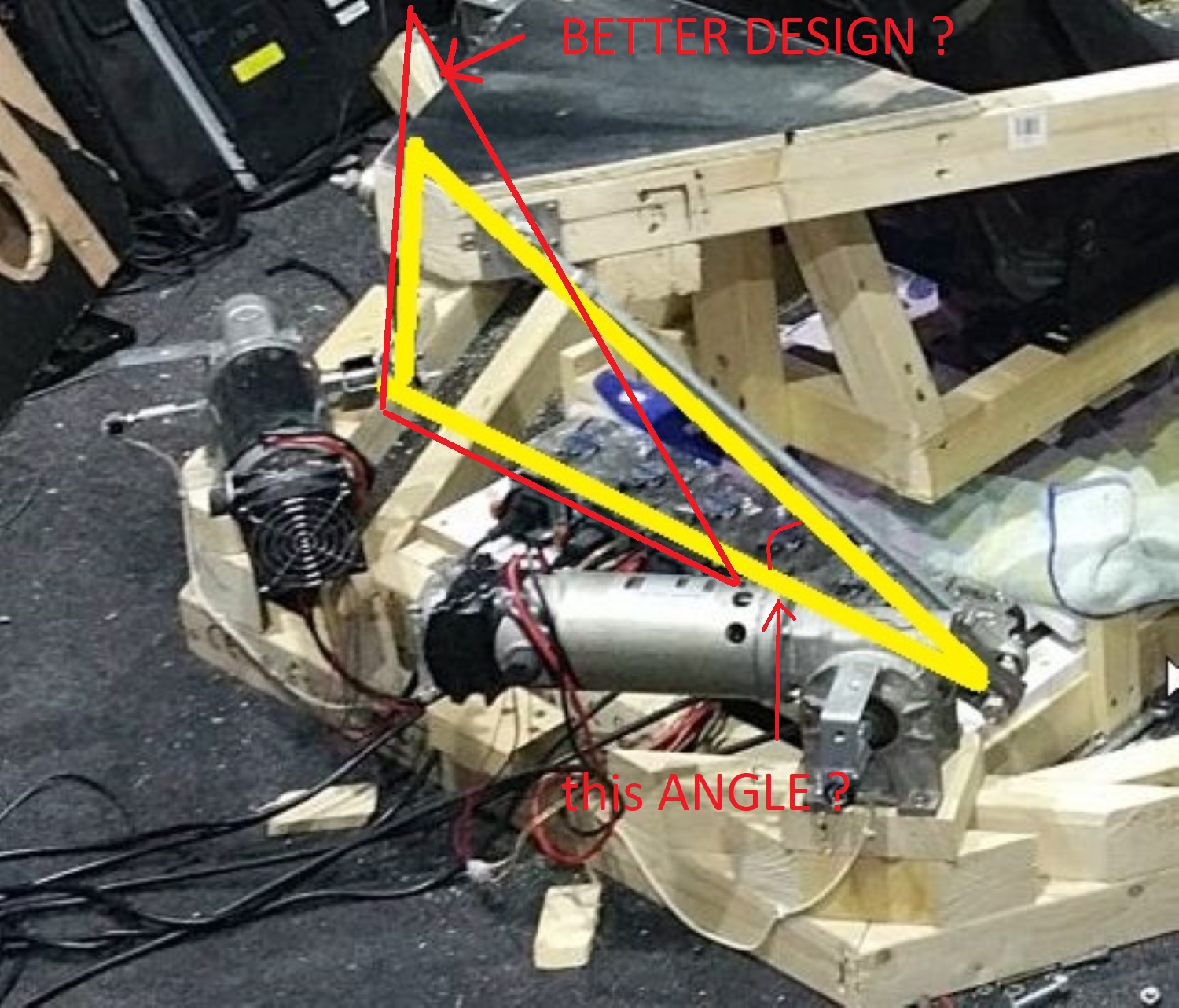

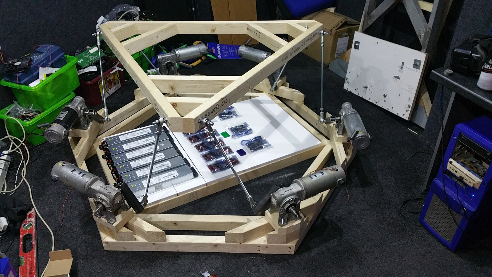

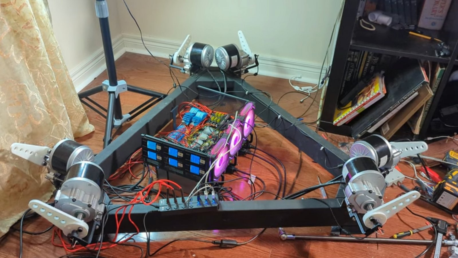

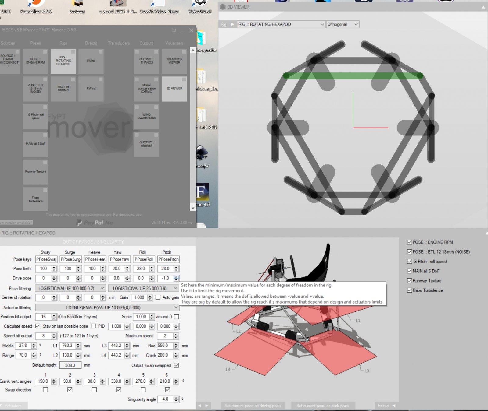

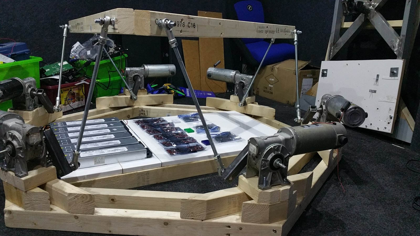

    I have a question if the arrangement of the motors in the rotary 6DOF has any meaning as to the platform performance ? ( pitch, roll, heave, sway ) or other parameters ?
    Below two 6DOF rigs to illustrate what I am asking.
    sillenchill  motor mount .jpg ronan motor mount.jpg .

    3DOF, AC motor
    The short answer: yes
    The longer answer could fill books....
    Just the most important considerations:
    • If you don't have weight support (gas springs) the static weight of the rig is the most important reason for motor heating. So if you don't have plenty of motor power (no AASD servos or similar) the most important thing is to keep the static forces low.
    • The higher the angle in the triangle in the picture the higher the static forces are. It has proven that an equilateral triangle (when viewed straight from the rear) is a good compromise.

    • The smaller the red triangle the more roll and pitch you get for the same actuator movement while the static forces remain the same. So make it as small as possible without generating collisions with the seat in the extreme positions.

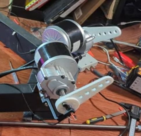

    Having crank arms with multiple bore holes is a good idea. This way you can always trade force for speed and stroke if necessary.
  5. Attyla.pl

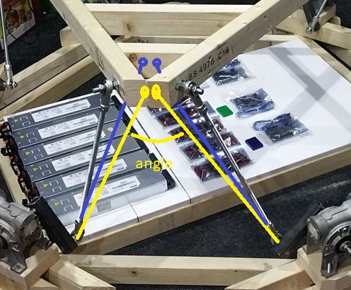

  6. Aerosmith
    Aerosmith Active Member
    May 30, 2024
    409
    self employed
    2,397Coins
    +243 / 0 / -0
    3DOF, AC motor

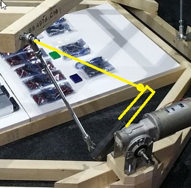

    More than 90° for the upper angle in the lowest actuator position is definitely bad. Close to 60° in the lowest position is good. An extremely acute triangle would also be bad because the forces for sway, surge and yaw become extremely high (pushrods almost parallel).

  8. Aerosmith

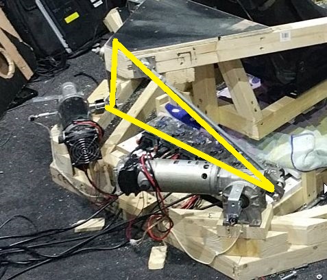

    And yes, the red triangle would be better than the yellow if you want to optimize motor load and heating. But the yellow one gives more heave for the same angular arm movement but less force per motor current. There are always pros and cons. If you tell me what the problem is or what you are aiming for then I could hopefully give advice.
  9. Attyla.pl
    Attyla.pl Active Member
    Oct 1, 2023
    278
    Polska
    1,233Coins
    +81 / 2 / -0

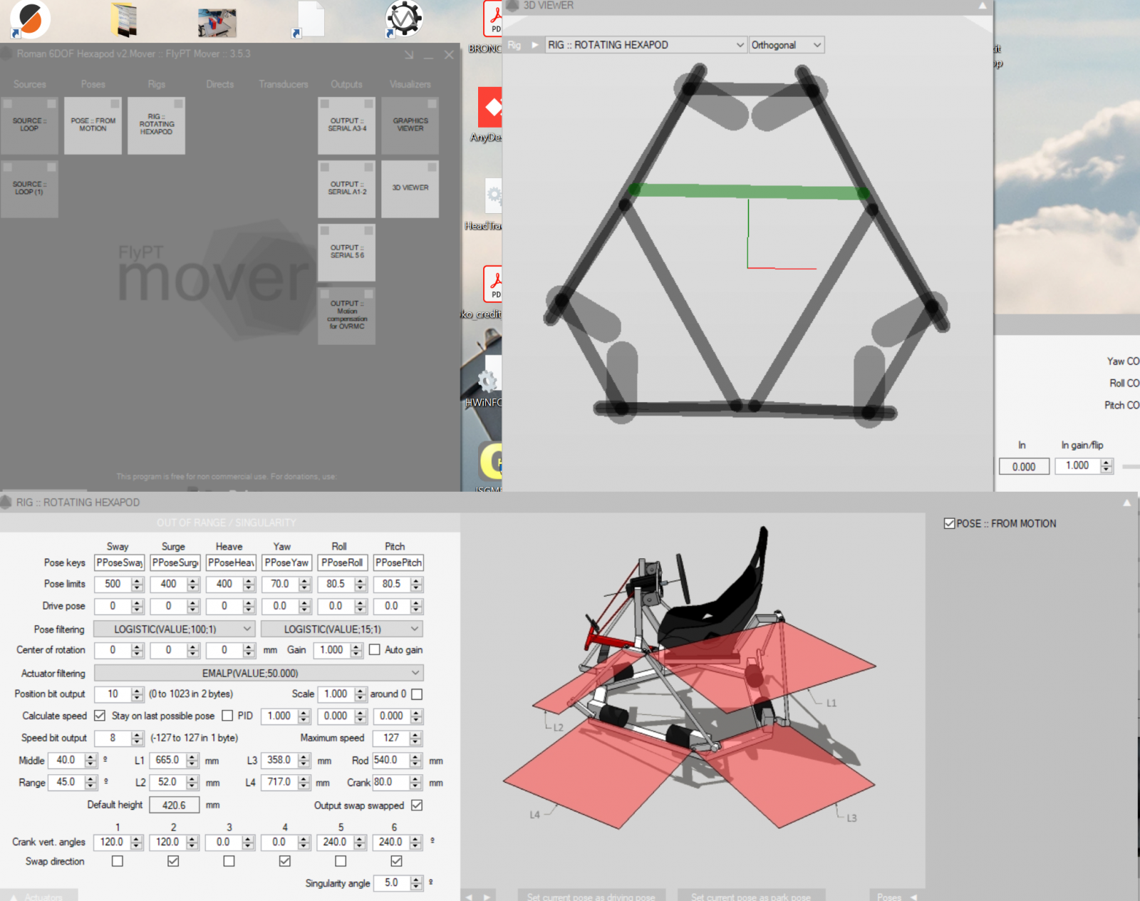

    I am thinking how to make 6DOF on 24V 250W motors, there are two threads on the forum
    SilentChill
    https://www.xsimulator.net/communit...bertooth-2x60s-was-mms-and-arduinos-osw.6948/
    Ronan Design
    https://www.xsimulator.net/communit...g-msfs-smc3-flypt-transducers-controls.19053/
    The arrangement of the motors in each of them is completely different and I wonder what effect this has on the swing ranges achieved by the 6DOF, tilt which arrangement of motors gives stronger tilt and which gives heave motion, is it completely indifferent and it is just a matter of choice of the designer?

    3DOF, AC motor
    Can you please provide links to pictures of the rigs you are referring to? If I go to the latest pages of the threads of @SilentChill and @Ronan Design I see that one of them has linear actuators and the other rotary ones. But that's not what you are asking, I think. You mean SilenChill's design has the motors in a symetrical star arrangement while Ronan's motors are in the corners of a triangle, right?

    Yes , exactly I mean the differences between SilenChill's design has the motors in a symmetrical star arrangement while Ronan's motors are in the corners of a triangle, :)

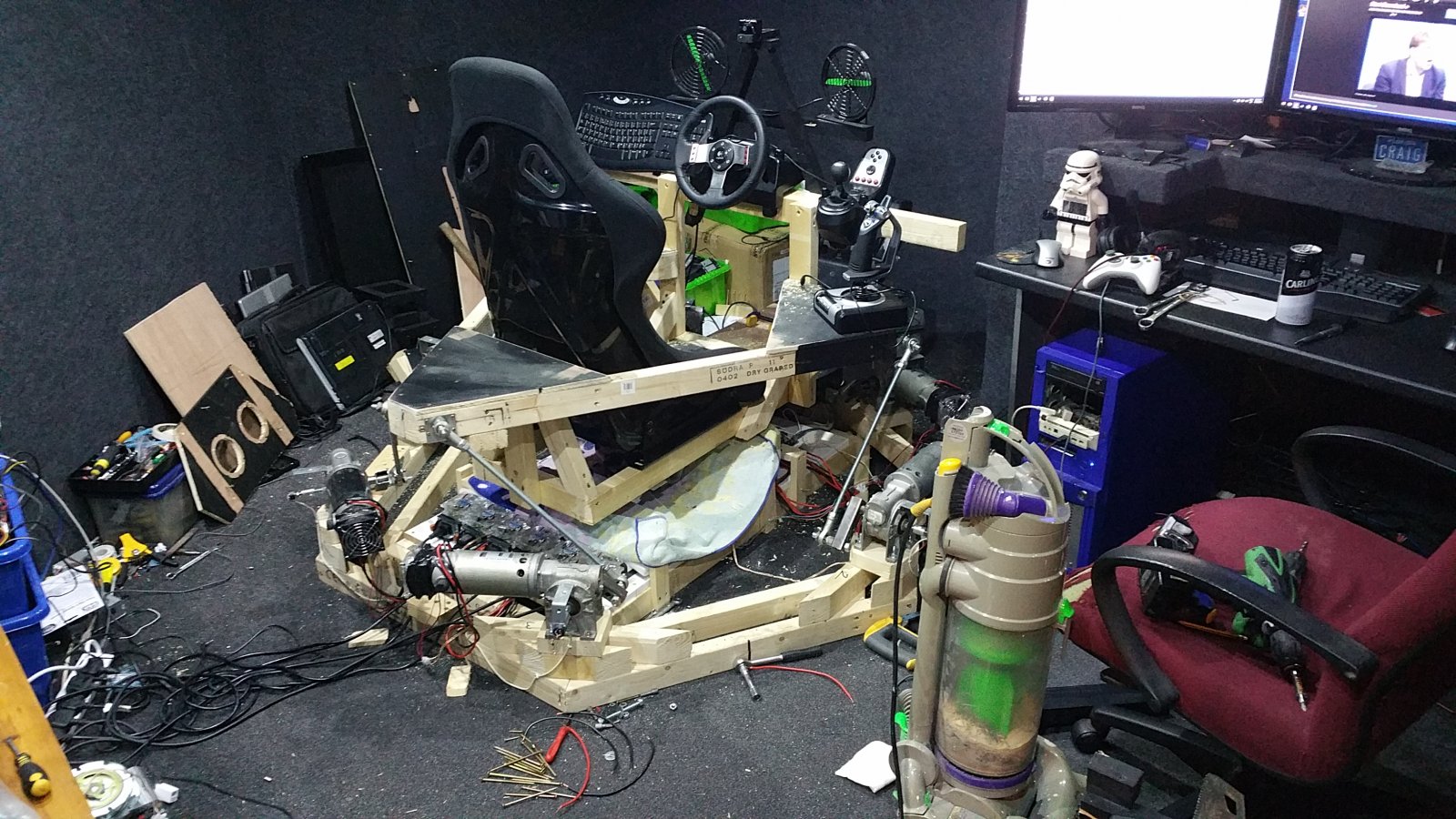

    +243 / 0 / -0
    3DOF, AC motor
    The picture in your first post with the wooden frame is from SilentChill's platform, at least one of them, isn't it.

    Ok, some more hints:
    When building with wood I would reinforce the attachment points with metal plates or at least put very large washers below the bolts and nuts. Pinewood is very soft. Beech or plywood is better. I know it costs more but I'd use it at least for the parts which have to take the largest stress like motor support or joint attachment points.
    I'd attach the upper joints as close as possible to each other. A large distance introduces torque into the rig which could cause bending and wobble (and creaking noises). As I already said, an angle around 60° is good. Avoid >90° or <45°.
    The placement of the motors can be changes as you like. You can mirror the motors 180° or rotate the crank arms by 180° to save space.
    Just make sure that the angles are right and there are no collisions for the full rotating range of each motor.

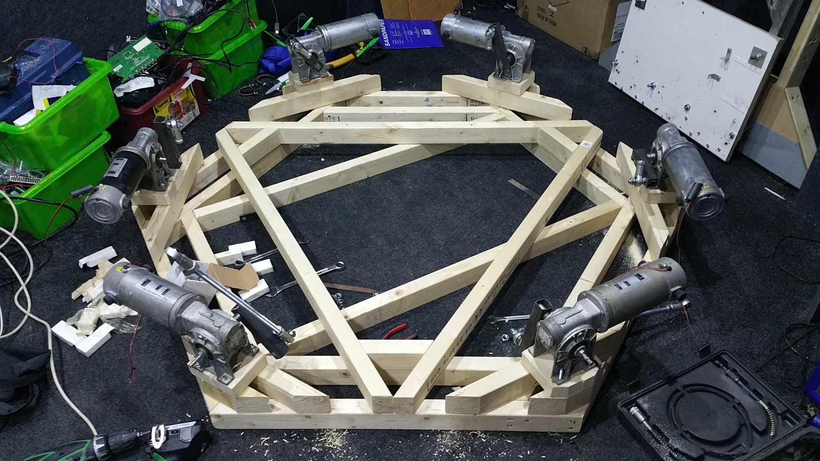

    If your cockpit is completely on top of the upper triangle of the rig you can also adjust the size of the triangles as you like. The smaller the triangle the higher the possible roll and pitch angles. But be careful, the forces and thus motor current also rise. The motors share the load evenly only in the neutral position. If you tilt too much the rig could collapse or break due to "singularity" cases.
    If your feet are below the plane of the triangle ("bathtup configuration") you need to make the triangle larger to avoid collision with the seat or the pedal area.

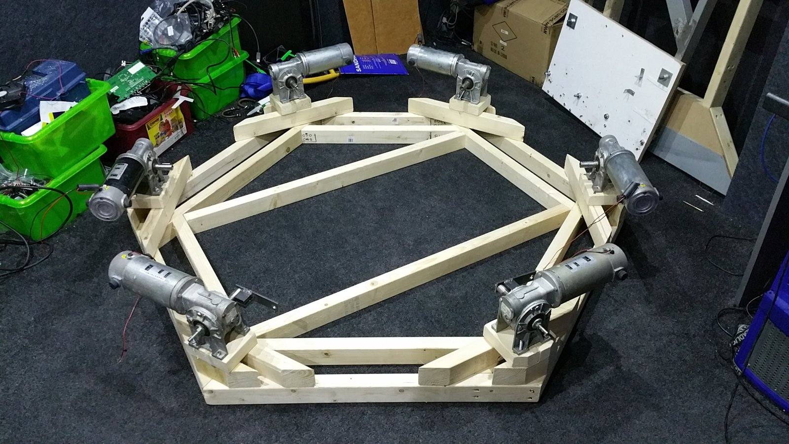

    Wooden frame is only for trial assembly whether it will all work, so far trying to understand how it all works :)
    Thanks for the hints :)
