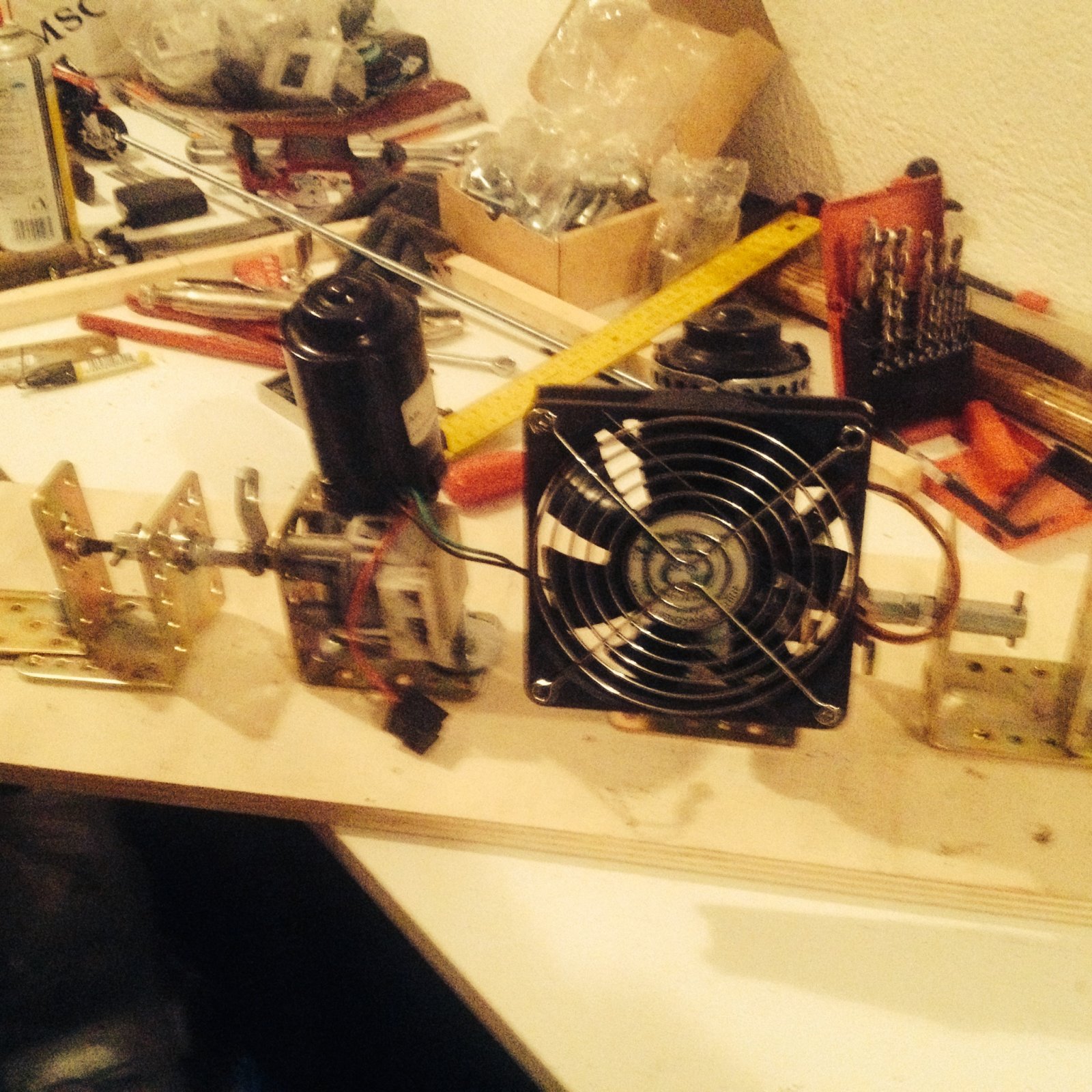

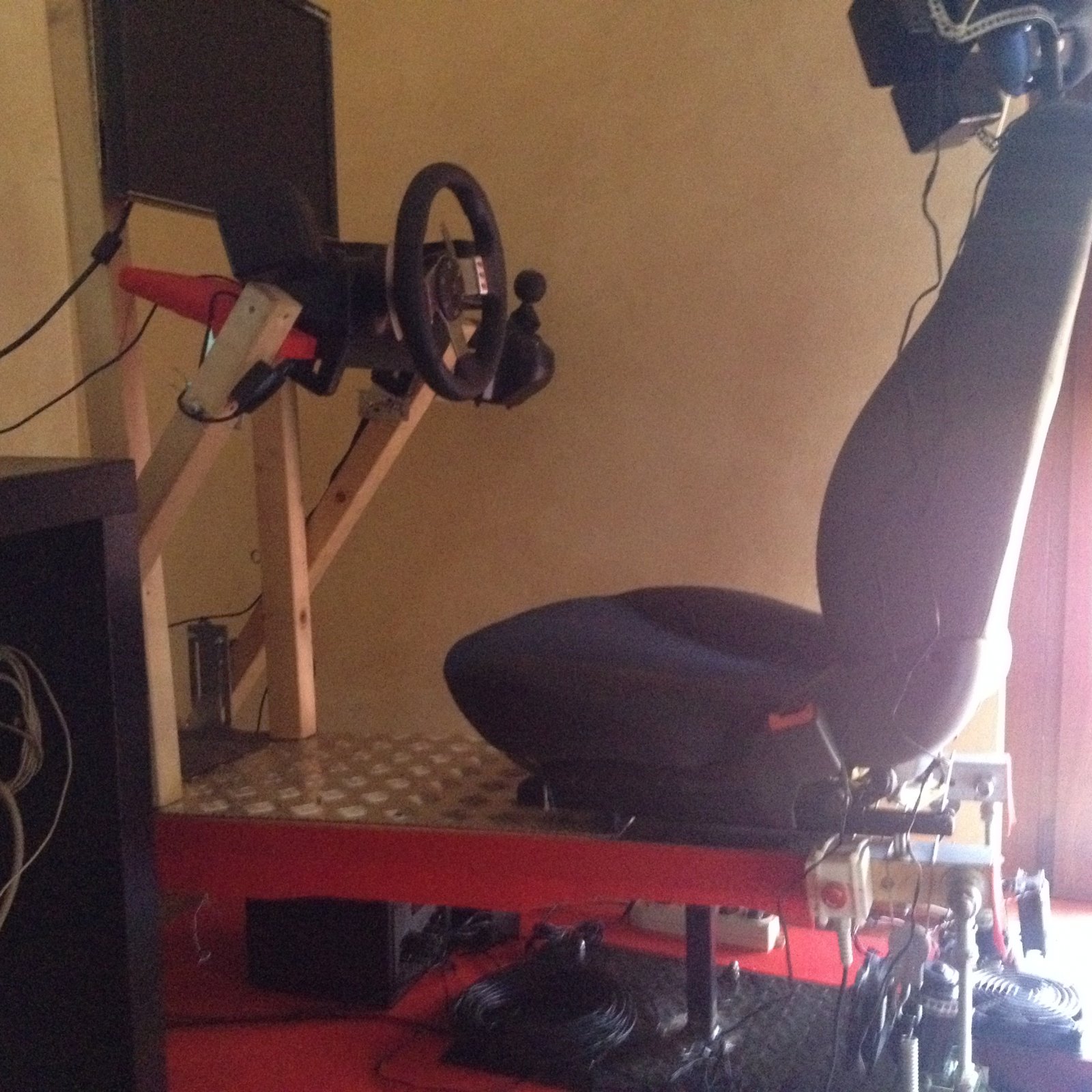

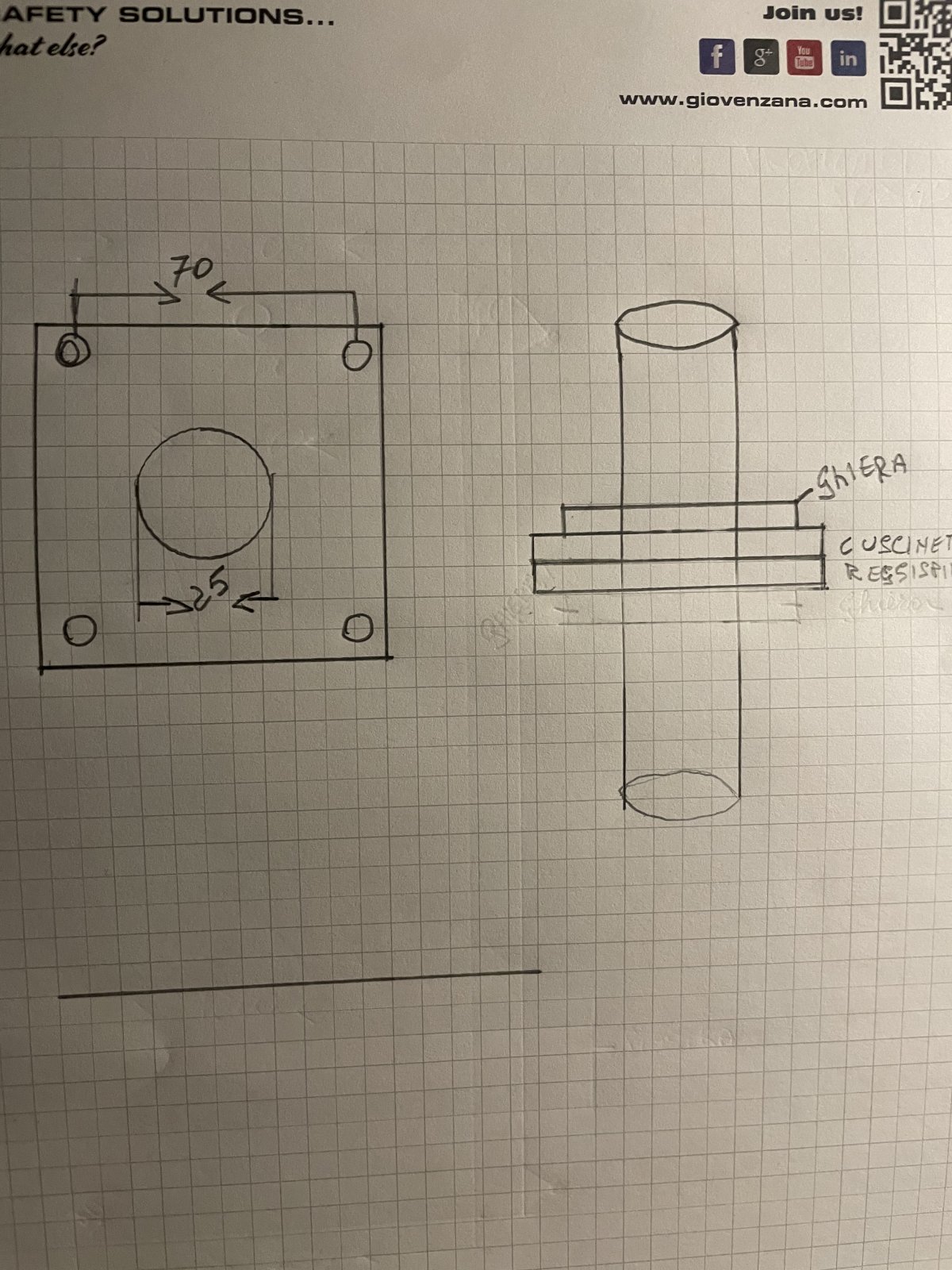

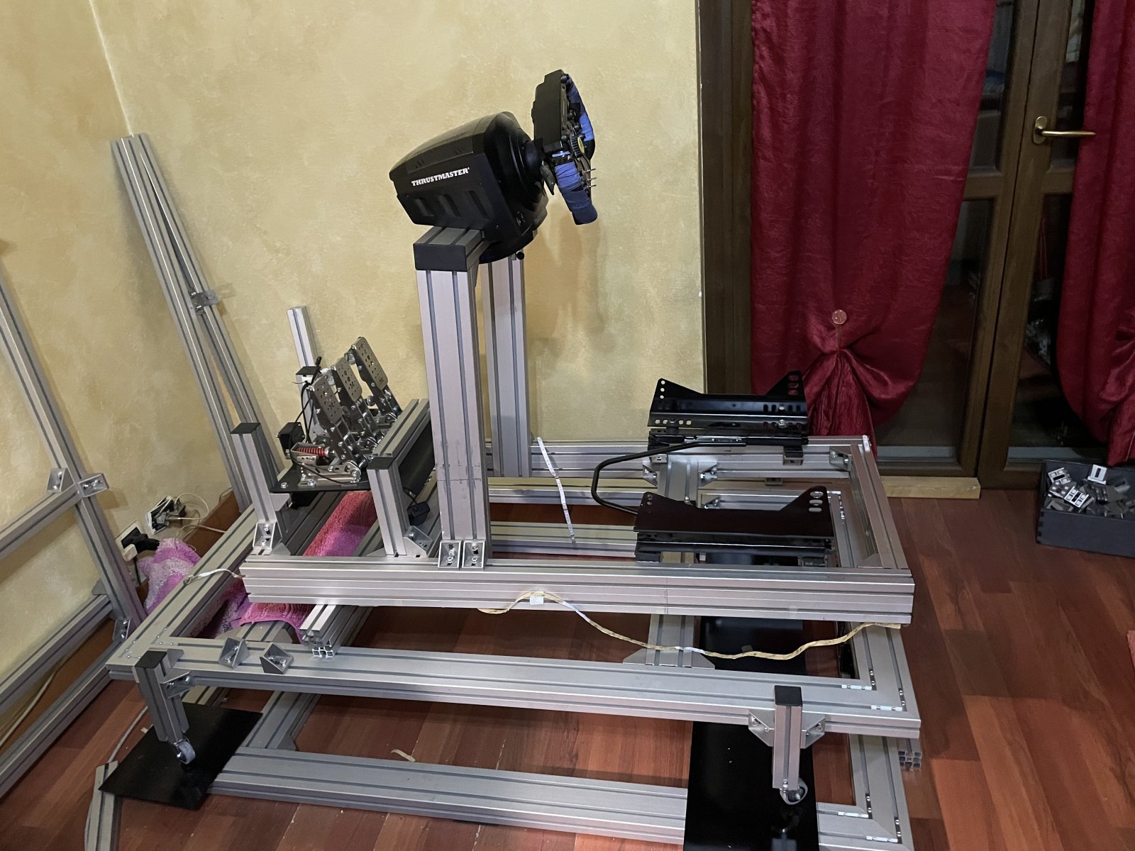

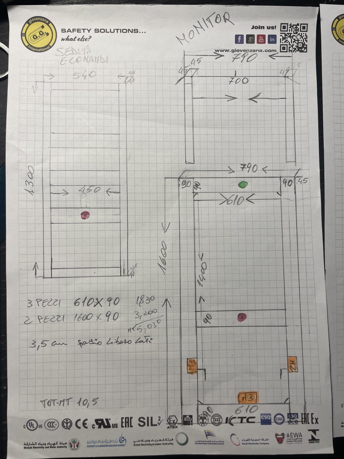

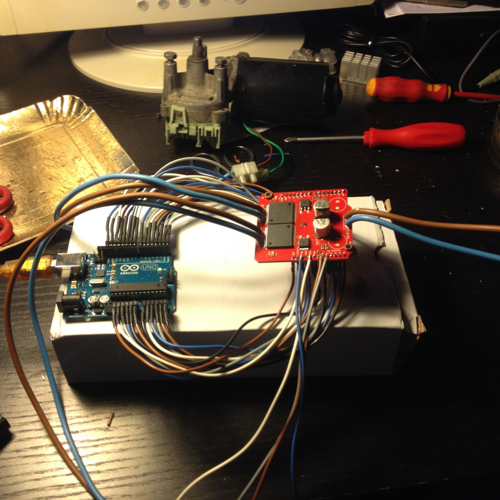

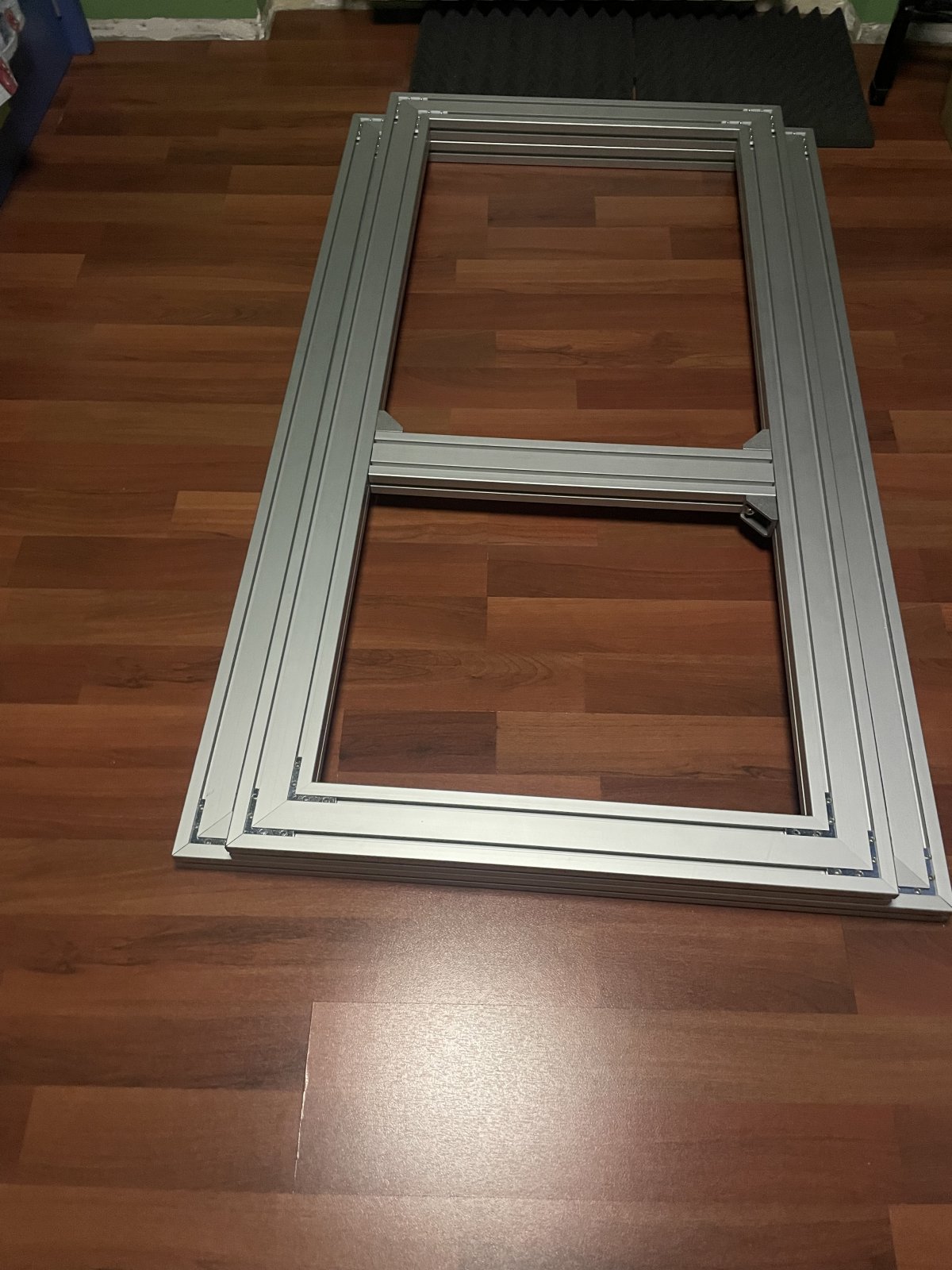

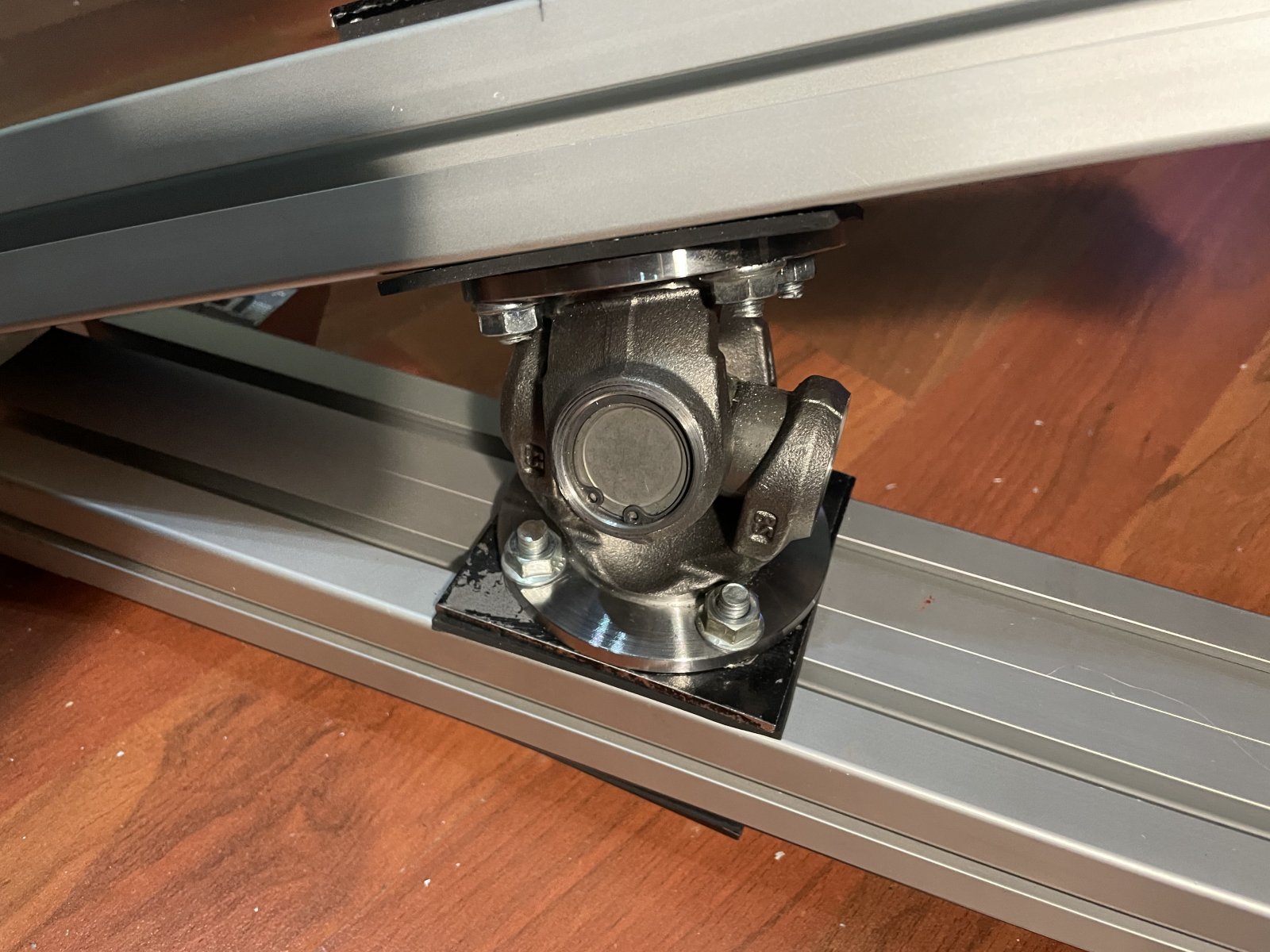

    Hi everyone, I'm Rosario, I've been passionate about simulators for years now, I started with a wooden structure with a 2dof movement with arduino and mister moto shield at 12v and I only recently switched to simtools!! 2B853BA3-5A12-4AA8-A545-50881C1E9F96.jpeg 2D9988B0-A407-43B2-8888-5CE4B1331E38.jpeg 152C4AEA-CCC3-441A-AFD0-B0987DEEA7CE.jpeg

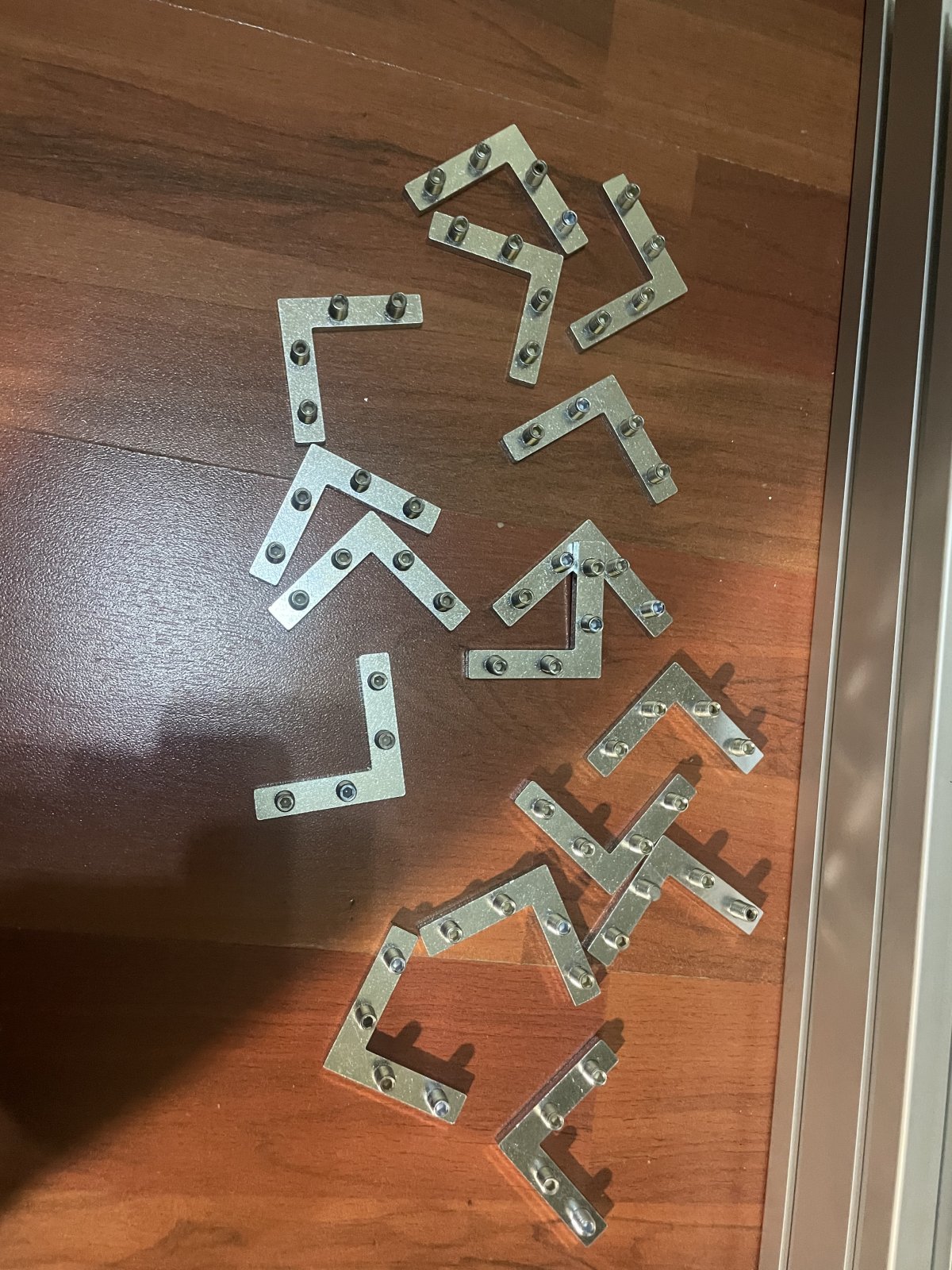

    Today after years the structure is in aluminum keeping the 2 dof!!

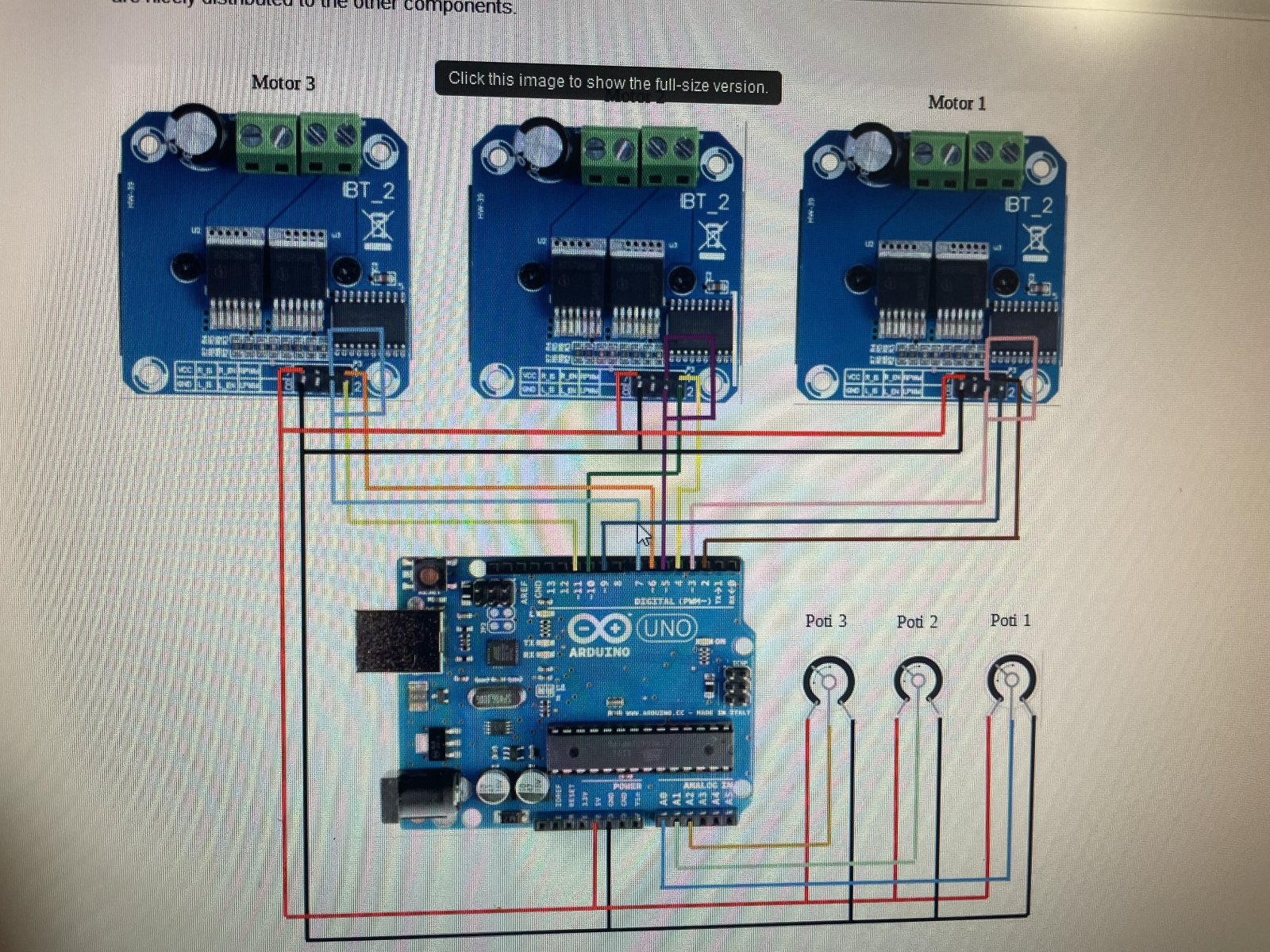

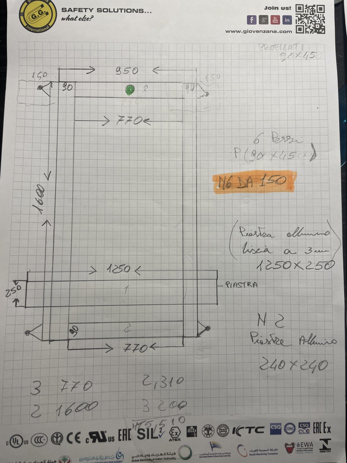

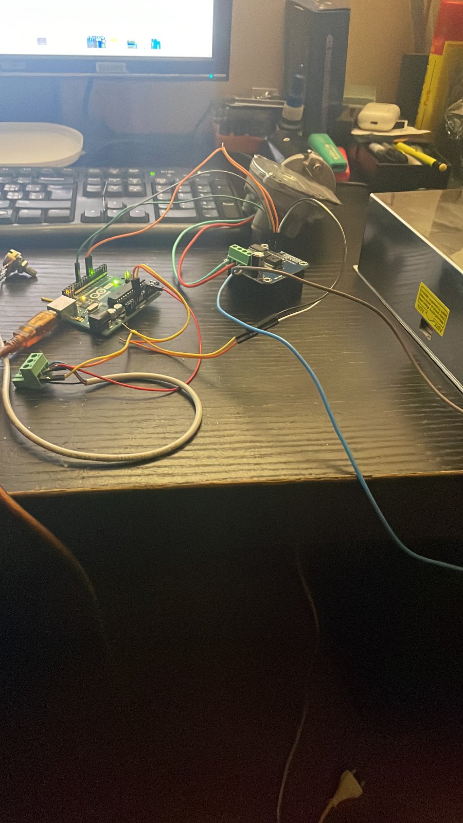

    Now I have decided to transform again by implementing the 3rd movement of which I insert some photos of the project in evolution and imminent realization and transformation at 24v with arduino and ibt2 board even if at the moment I am experiencing some problems on the configuration of this system !!

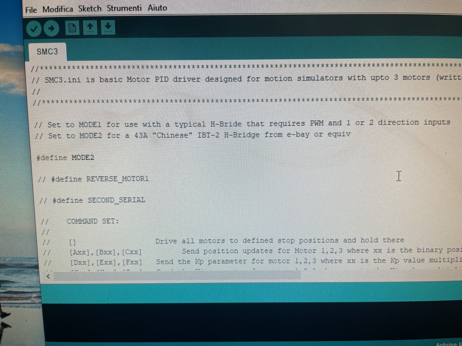

    Can you please detail the configuration difficulties you have encountered.

    Hi, in detail I see the movement of the potentiometer in msc3 both positively and negatively but the motor only moves in the positive direction! It doesn't reverse ..... I'm posting some photos that might help! Mod2 set

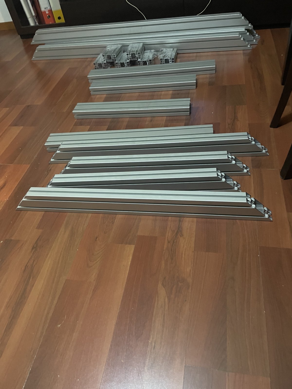

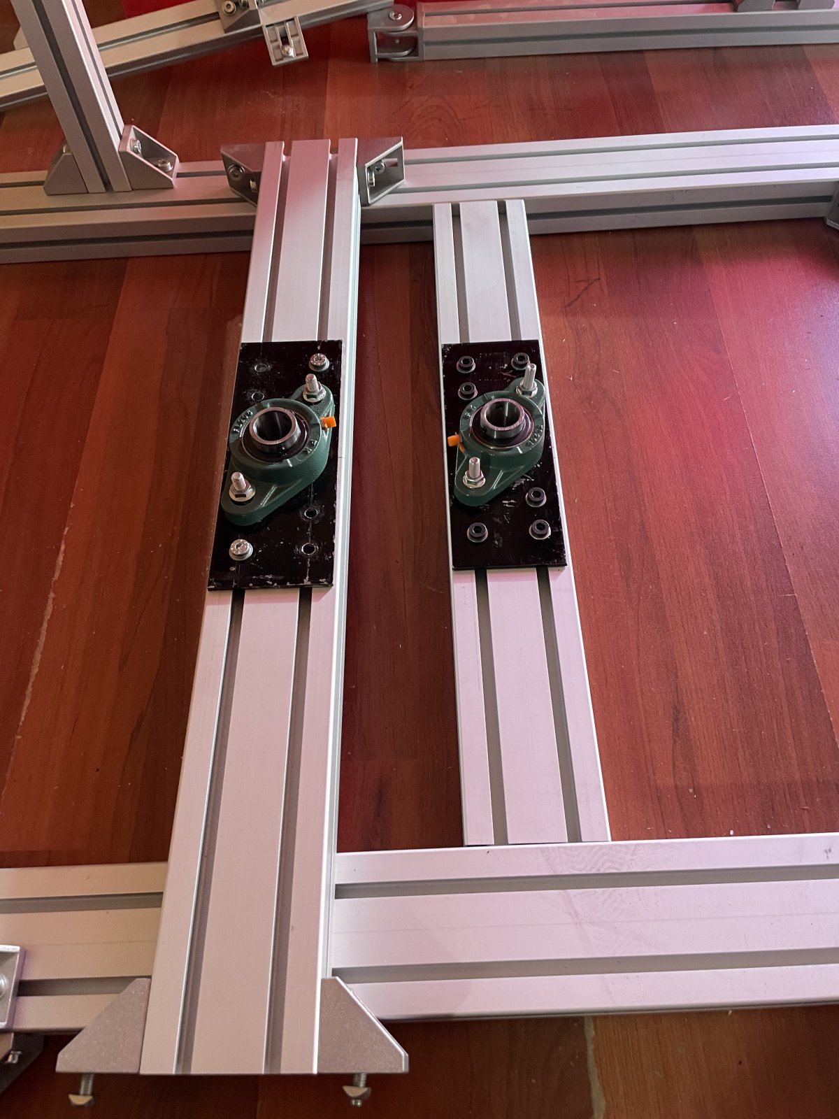

    I continue the realisation of the structures to carry out the transformation project at 3dof
  7. rosario
    rosario New Member
    Jan 20, 2023
    39Coins
    Since electronics with ibt2 are currently blocking me !!! I go on with the assembly of the structure to realise the 3 dof
