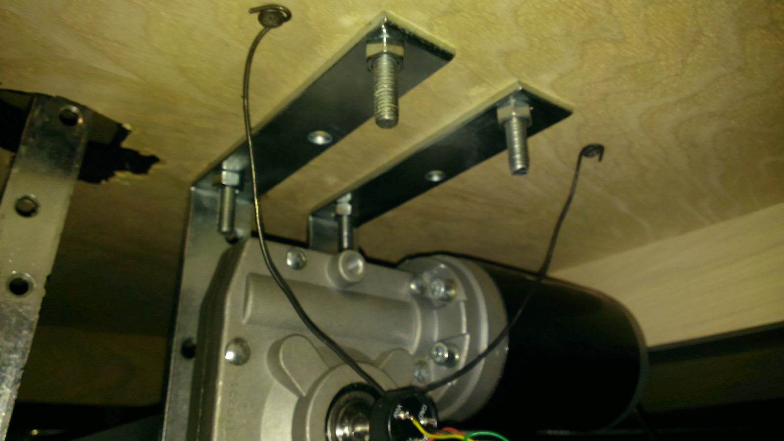

    @bsft , I was referring to its voltage requirements due to this statement, “Sitting still and zooming in on the output graph shows them fluxutating about 2% of total value”. This is not normal!
    I have yet (knock-on-wood) to have any problems with my cheap magnepots sticking and requiring lube. I'm not sure how many hours I have on them but I estimate around 50 each on three of them. How many hours before you started having issues (I wonder)? They are rated at 500 rpm so I don’t see how being twitched up and down rapidly should make a difference because I doubt they are going faster than that. If your bearings are wearing this quickly, they are probably still getting forces applied to the shaft that causes friction and wear. Do they practically float on the shaft? A standard pot requires a stronger mount because they have more turning resistance. But since the hall effects are non-contacting, they have very little resistance. So all you need is a small flexible wire to mount them with. I use bailing wire which is stiff enough but flexible too. Then mount the wires ends to two points where it keeps the body of the pot from rotating but still allows it to move up and down and sideways with the shaft. This is how I mount mine.
