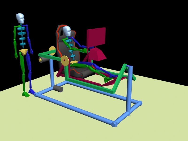

    Hello All,
    I'm Rens from the Netherlands. I have my own gamestudio which develops games for the internet, tablets en phones. So you can say I'm intrested in gaming.
    I had to sell my MX-5 racer last year and since then i've been looking for a new thrill. It seems a simulator looks like a great way to have some fun.
    Stuff i've had lying around from other projects. Velleman K8055, two wheelchairmotors + Gearing, Racing Seats (BucketSeats) and a Sabertooth Motorcontroller (2x12).
    So i've already got some of the more important parts.
    Things i'm gonna need: The steeringwheel + pedals, a frame, and some gears.

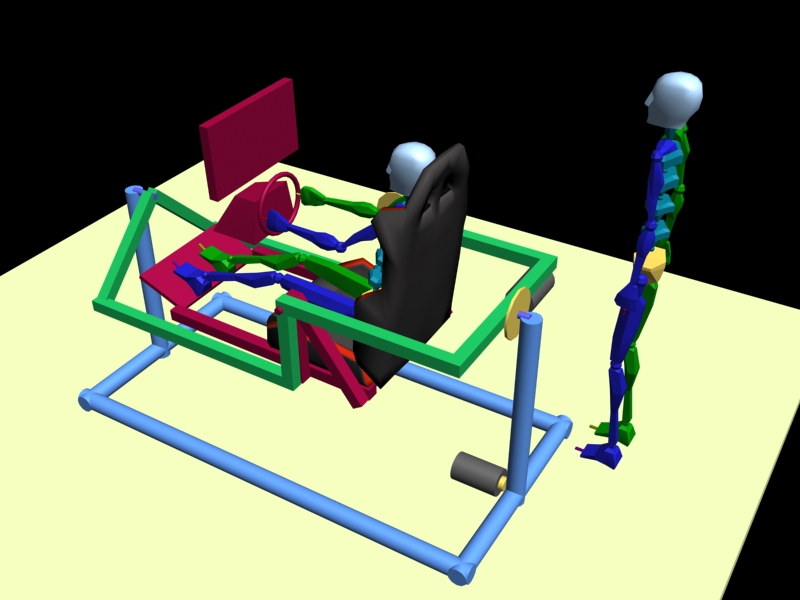

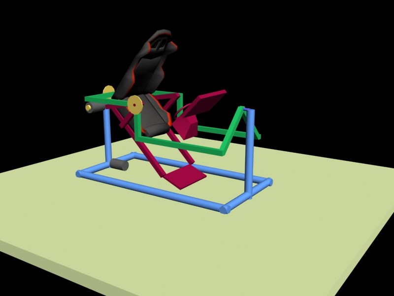

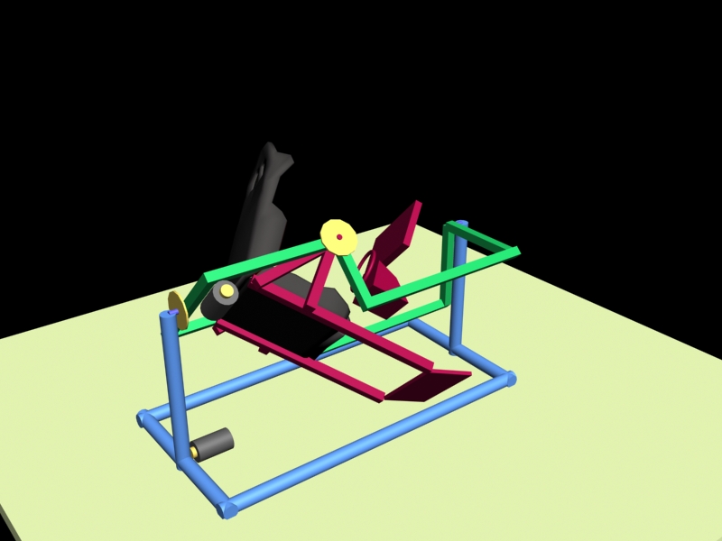

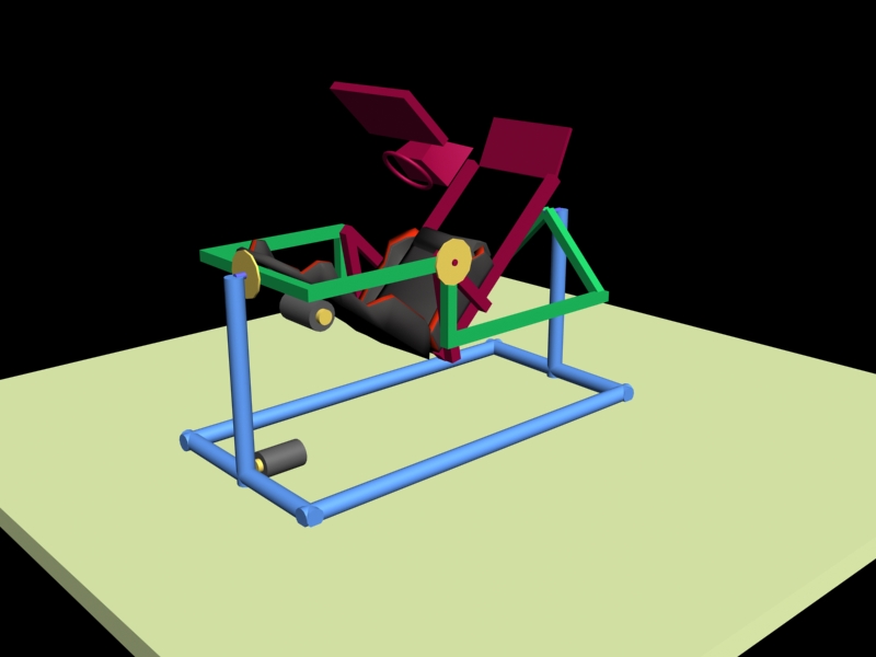

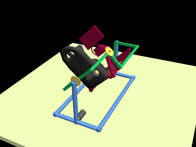

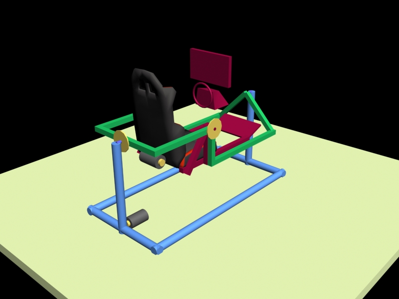

    I want a +45 -45 degrees for both longitudinal and lateral forces.
    Below is my design for now. I know I miss some crossmembers. But it's a start to see if All the angles are possible.
    It's made up from 3 different frames.
    The blue frame is the base.
    The green frame is for lateral forces
    The Red frame is for longitudinal forces
    The grey blops are the engines i've got
    The yellow discs are the gears/sprockets i'm going to use.
    The engines are 160RPM (without the gearbox).
    meaning 936 degrees a second.
    I want my simulator to move from one end to the other in 1 second.
    so -45 to +45 = 90 degrees in 1 second.
    Meaning i'm going to need a 1:10 Gearing ratio.
    I'm not sure if it's going to work like that... but will see.

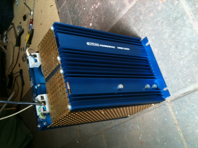

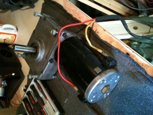

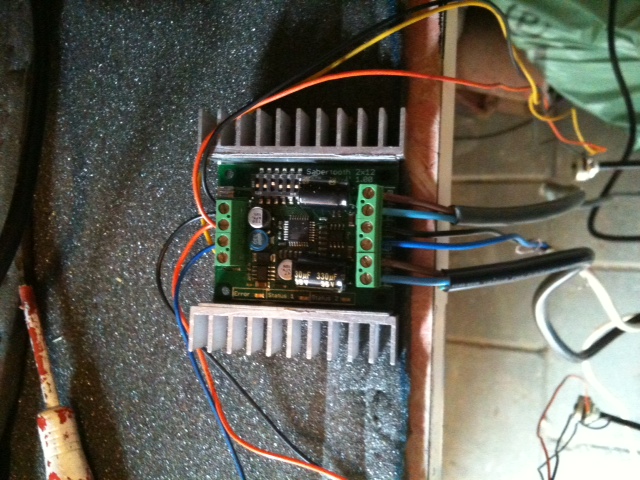

    I've received some goodies over the last few days.
    Also i've been testing my velleman and Sabertooth.
    Here are my motors + Gearboxes (1:25) and Sabertooth all connected for testing.
    But the best thing is my PSU. its 24volts and 20AMPS! it weighs 14 kilo's and delivers a great deal of power.
    Also, my testing supply couldn't handle the regenerative volts of the sabertooth. This one doesn't have a problem with it at all.
    But as always... pictures say more then words.
