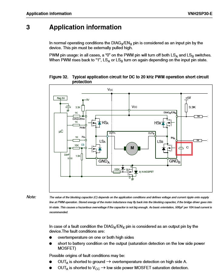

    Just for your information, below is something that I have posted before in regard to the chips used in the MMs. Just something to be aware of - Manufacture recommends 500uf per 10A load . MMs comes with 470uf fitted for each chip and there is spare space on the board for another. Read the note below:

  7. tronicgr
    tronicgr
    So 500uf per 10A... There will be peaks of 100A... At least

    I will get some caps and put them on the mm's . I will have to measure the current coming back from the motors see what it is.

    I've ordered some 1000uf caps to go on the MM's so will have to see how they go.

    @SilentChill you are using the MMs as a dual half bridge so really I cannot imagine you are going to overstress the MMs in any way

    No neither do I @Pit but the back current from the motors could be why so many MM's have died.

    my MMs did not die while "working", one died due to bad soldering, one died due to a short circuit. I have driven 1000 hours now on the MMs - no (more) fuses and no caps.
