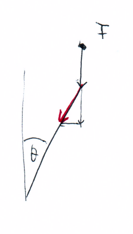

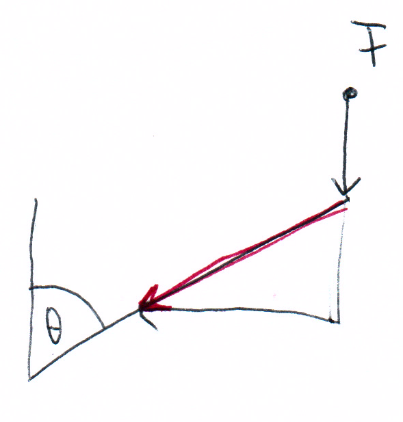

    i've one more point according your power problem @SilentChill
    The one point i mentioned in wannabeaflyer2's post, the other thing is the resulting force due to the angle of your actuators. I think someone mentioned it already...
    Here are two graphics.
    This is your design. The diagonal line is your actuator. The force F is the weight of the rig.
    The angle theta is quite big, so the resulting force is big.
    Here would be the actuator with a smaller angle theta.
    So if your weight of your platform is 120kg with. every actuator has to handle 20kg, but the motors have to fight maybe against 40kg.
    and soooooorry if this is all clear to you, i can also delete this trash:cool:

    I have made it so the actuators are at 45 degreen so they maybe just are to low. there is nothing I can do about it tho as I have no head room.
    Perhaps shorting th bottom of the actuators some how maybe be the way to go get more of an angle on there

    You also could lower your seat;)
    with an angle of 45° your motors will see the weight with a factor of 1,4. But this is at the middle position. If your platform goes down, your angle theta decreases. Maybe up to 60°? Than you'll have the factor 2. so about 40kg static per actuator.
    If you're in the mood of some testing you could take one actuator and test it under different loads. 20 kg 30 kg and 40 kg for a while and see, if there is such a gigantic difference in power consumption and heat development. If so, you know how to solve your problem.

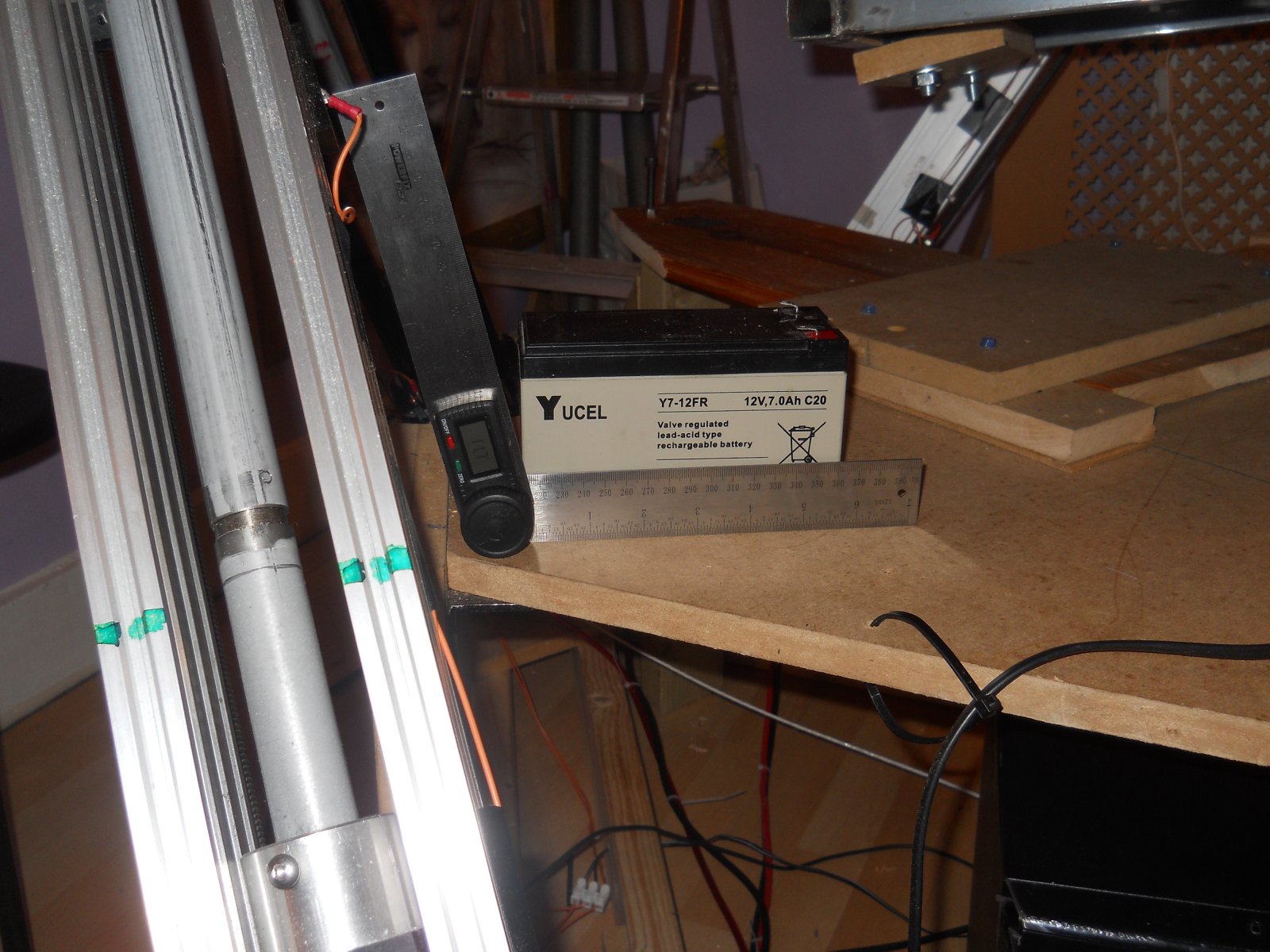

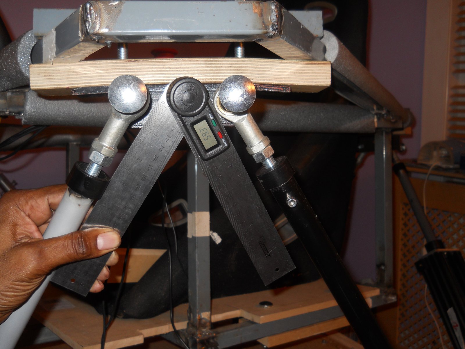

    @SeatTime and @wannabeaflyer2 quick question for yaz :) What angle are your actuators set at in the middle position ? Just wanna see if this could be the issue

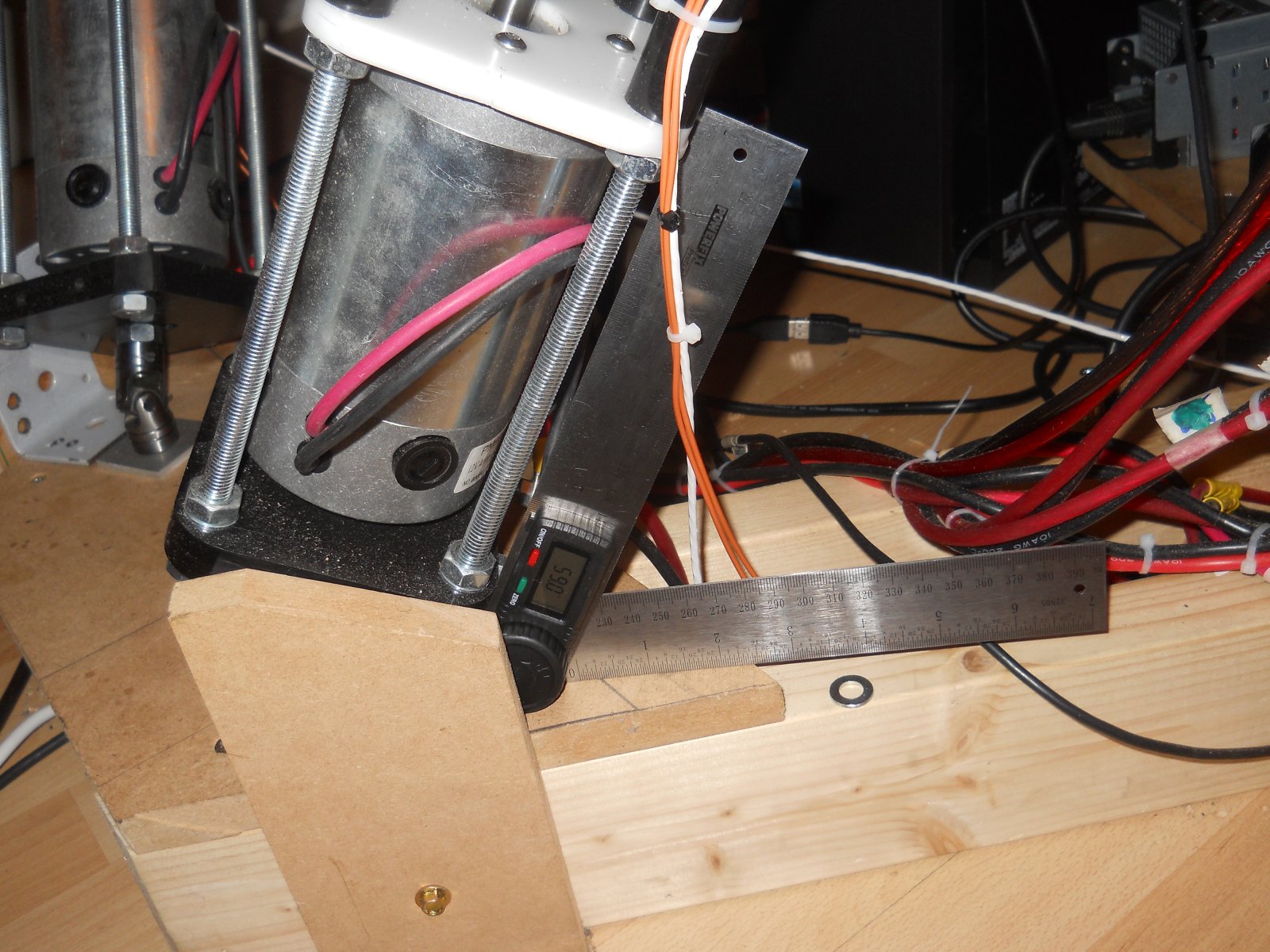

    Hi Good Buddy @SilentChill will try to get those angles for you when I get home later , I have more headroom to play with so I'm guess that with my upper platform Radius being circa 670mm and the lower one being 640 mm ish that my angles are not as steep as yours, but will confirm later :) well this did not leave the workplace pc LOL so later at home is now ,,
    ok just fired up the beast and the angles of the actuators at mid level is circa 60 degress so pretty symmetrical I guess ( that was more by luck than judgment LOL ) and the incline from vertical ref roll seems to be 10-15 degress ( this one is not so easy to measure see attached Pics not meant to hog your post good buddy so when done looking i will shift the pics to my post Cheers

    Thanks dude !! Could possibly be the lower angle I have that is giving me the problems like @My.stAr suggests. No hogging going in its all informative ;)

    2,572
    Mine are also around 60 degrees.
