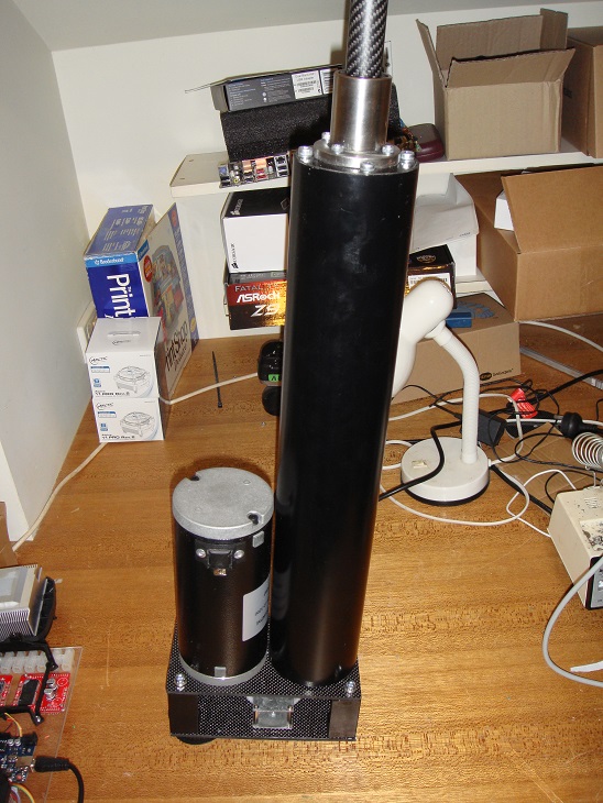

    The cruise was great as always - actually on leave until early January, so hopefully can finish off allot of projects that I have on the books. I use 3 x 1100mm/100N gas struts which only lift 10kg each, but I think they are a good compromise for balancing the rig without dampening the movement too much. Talking about motors - don't know if this is relevant but, I did tests on one of Motion Dynamics industrial spec motors early on when I was building my actuators (see picture below from my thread), which were quite a bit larger (size wise) than the motors I ended up going with, but found in testing that they would not track properly - from what I could tell it seemed to be how the motor was wound and there seemed to be a bigger gap between the magnetic poles when it turned (it could not turn in small increments like my other motors - so would stop either just past or before the target). Don't know if that may be relevant to your motors or not - but figured worth mentioning?
