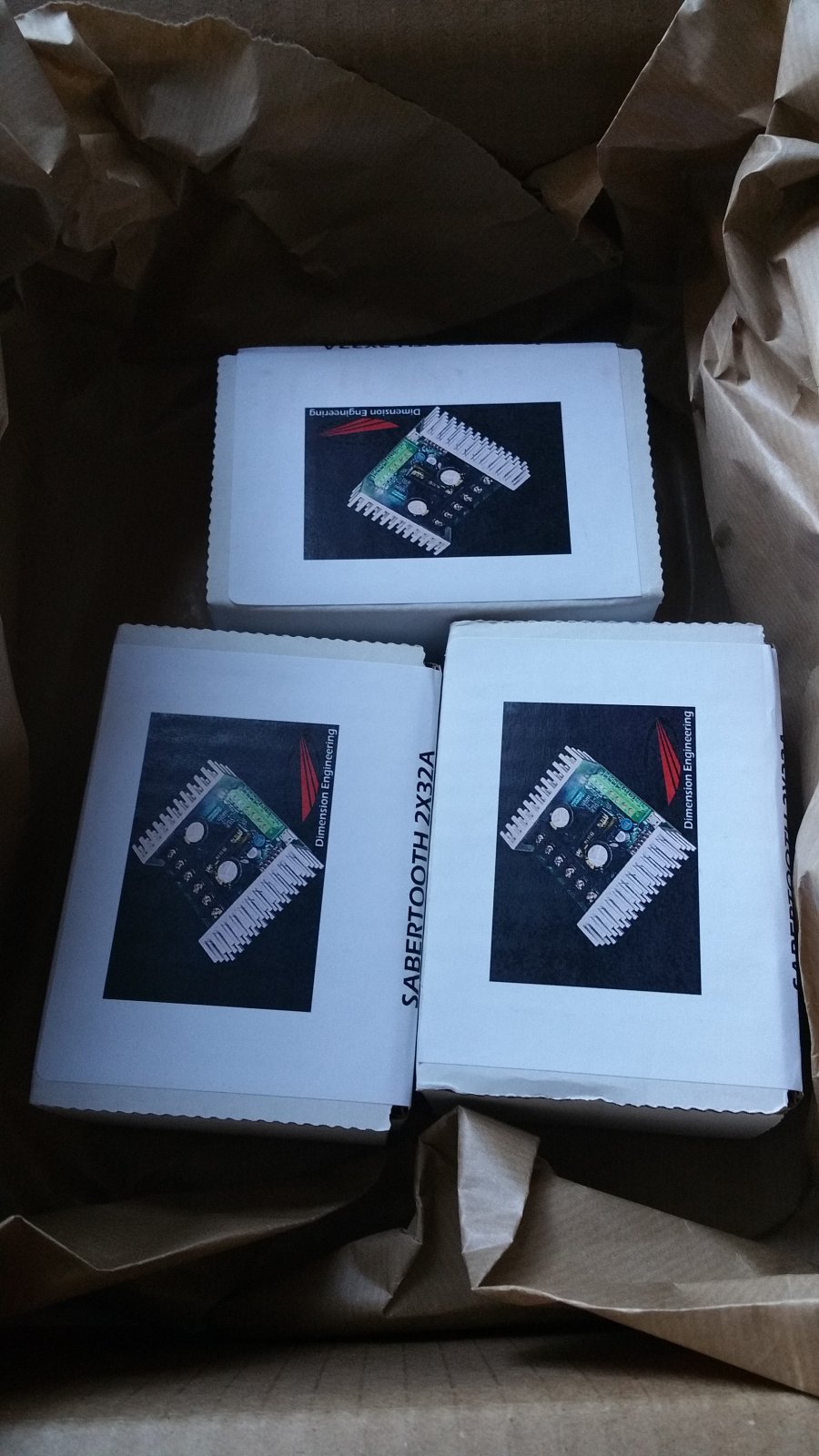

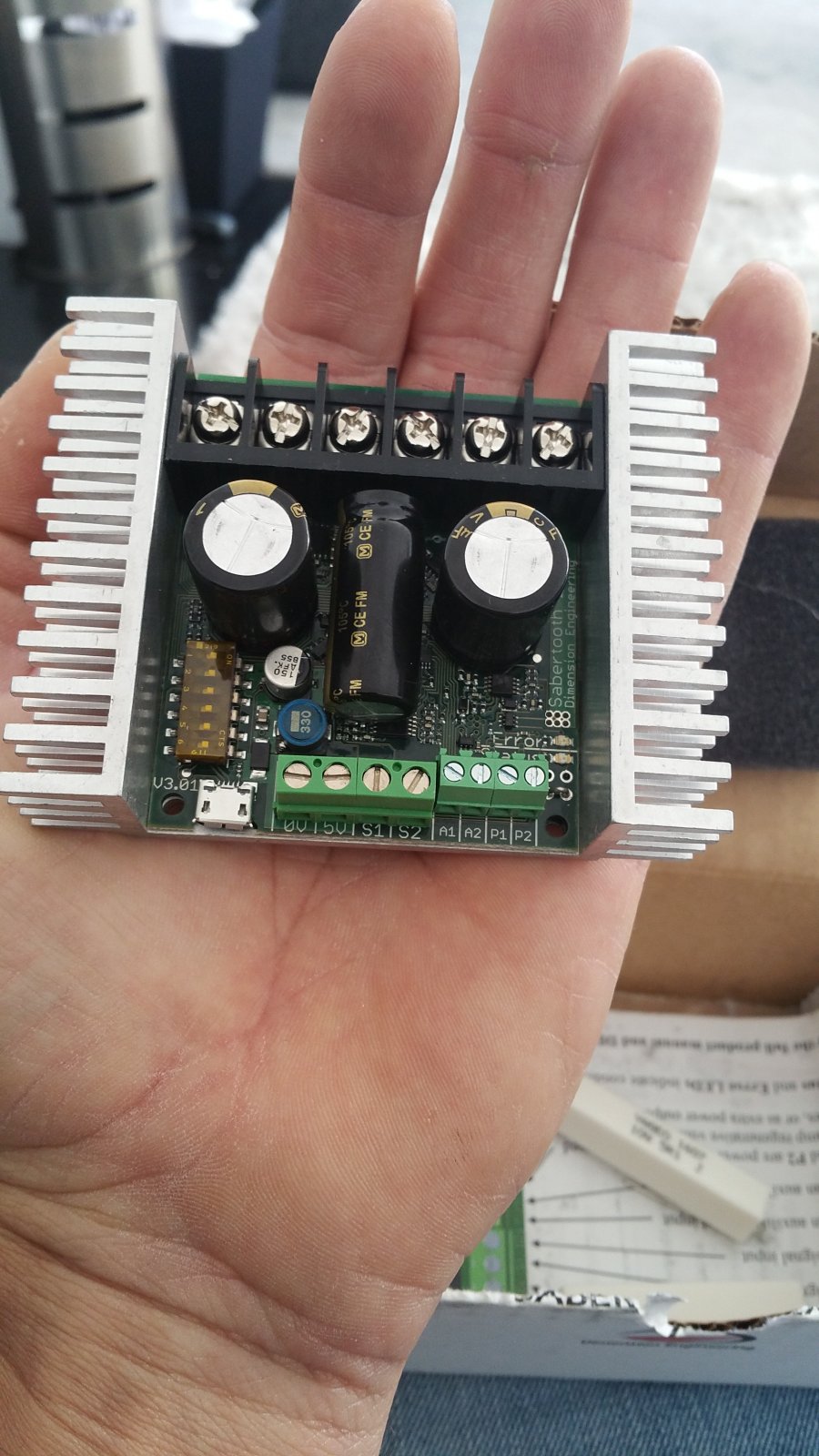

    Now you can crank up the power, plus test out @BlazinH's new SMC3 code :thumbs
  3. SilentChill
    2,645
    20,592Coins
    +3,567 / 34 / -0
    Wow these things are beasts !!

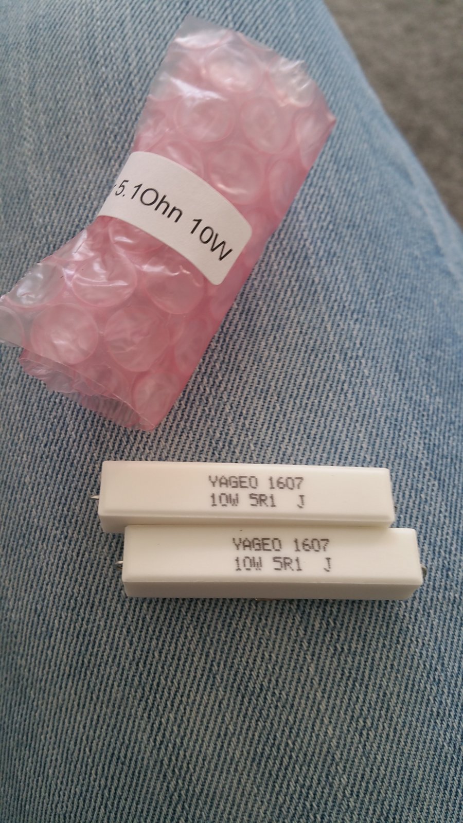

    And I got free back current resistors. I went and bought some the other day too grrrrr :D
