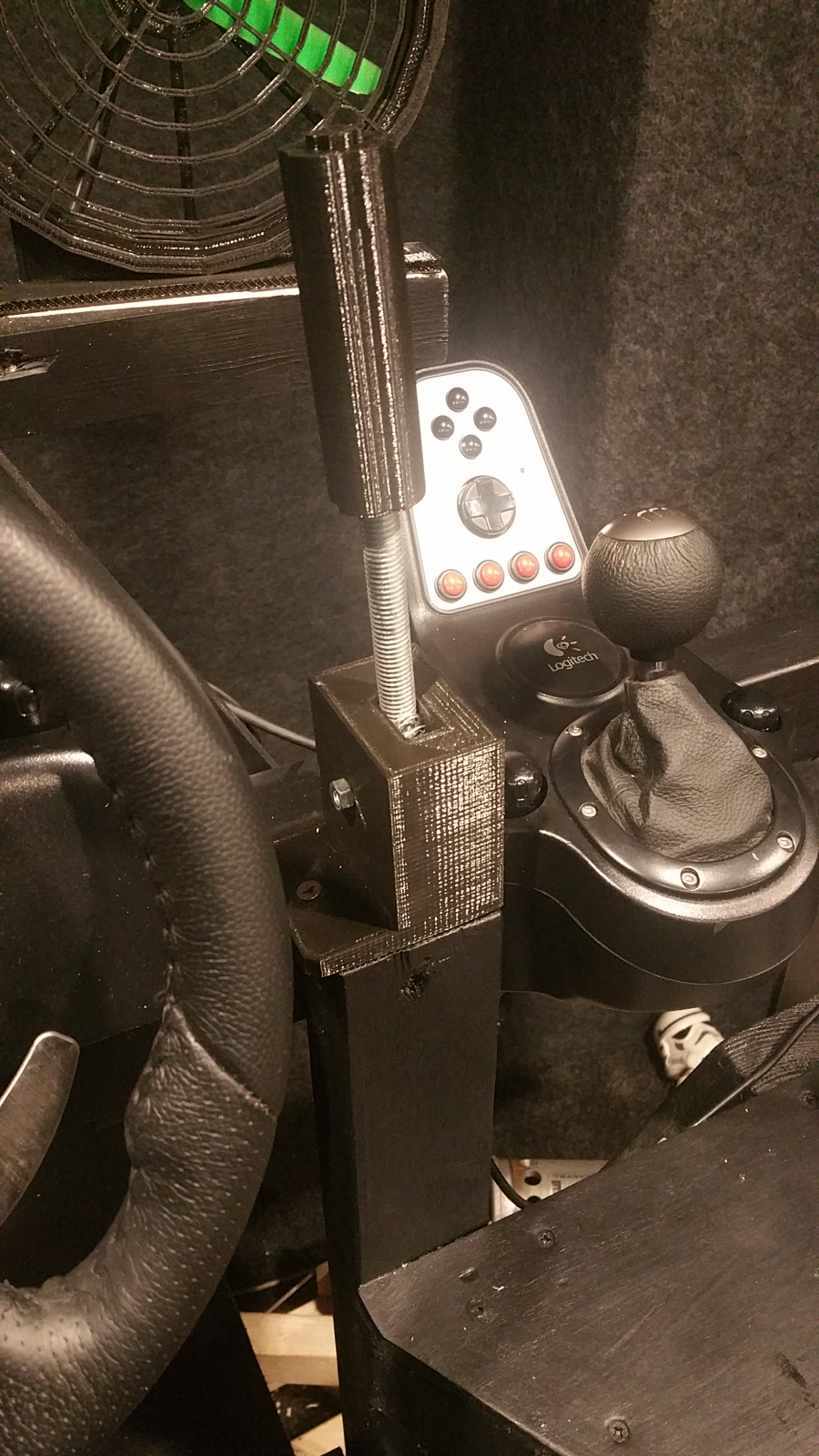

    Always wanted a Handbrake I'm waiting for bits for the actuators, so I printed one off thinguniverse. Not as good as most on here but it will do for me :)

    That 3D printer has paid for itself and then some , another example of making the most out of our boys toys , Very nicely done , you def are not hanging about .. im seeing threaded rod and 3d Printing combined with a mega dose of inspiriation = good stuff magic :)

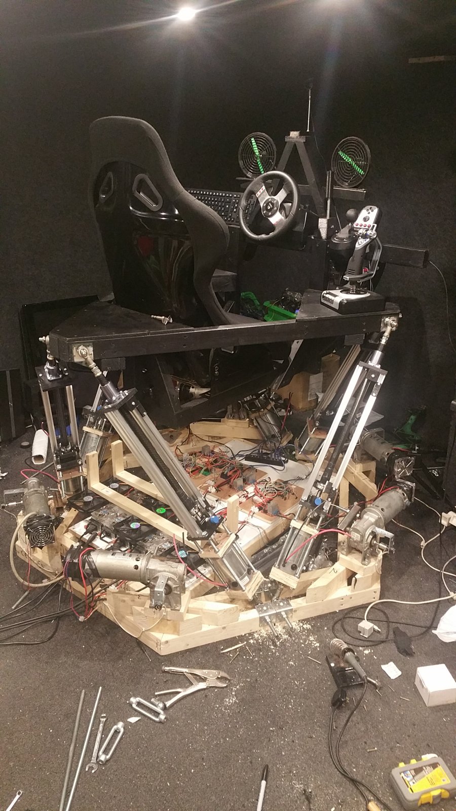

    Nearly there, room us an absolute shit tip lol :D
    Leaving old motors there until I know this works ;)

    Safe to say mate your not hanging around , lol you weren't kidding about possible motion this weekend .. Niiiiiccccce :) and once again innovative take on solution to UJ anchor ....Yes I def like that method Great stuff @SilentChill

    @wannabeaflyer2 think I may need to extend my top platform as the angle is too little. I will see once I get it all sorted.
    Think my head may touch the ceiling also :rolleyes: got 350mm range and 350mm clearance above the seat and my head is a bit above the top of the seat lol DOH !!
