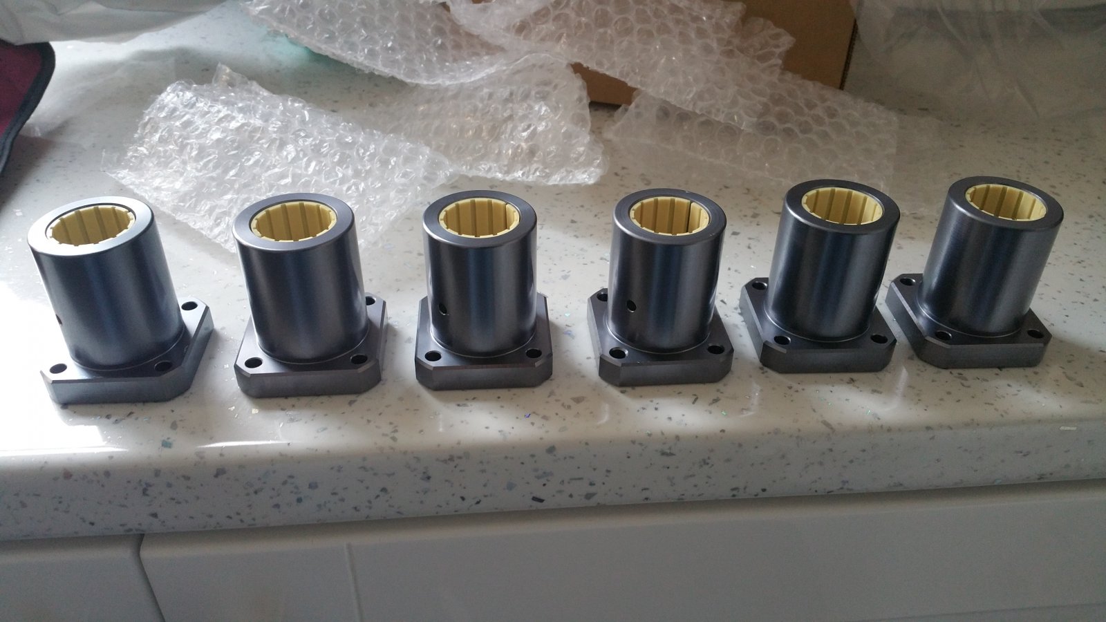

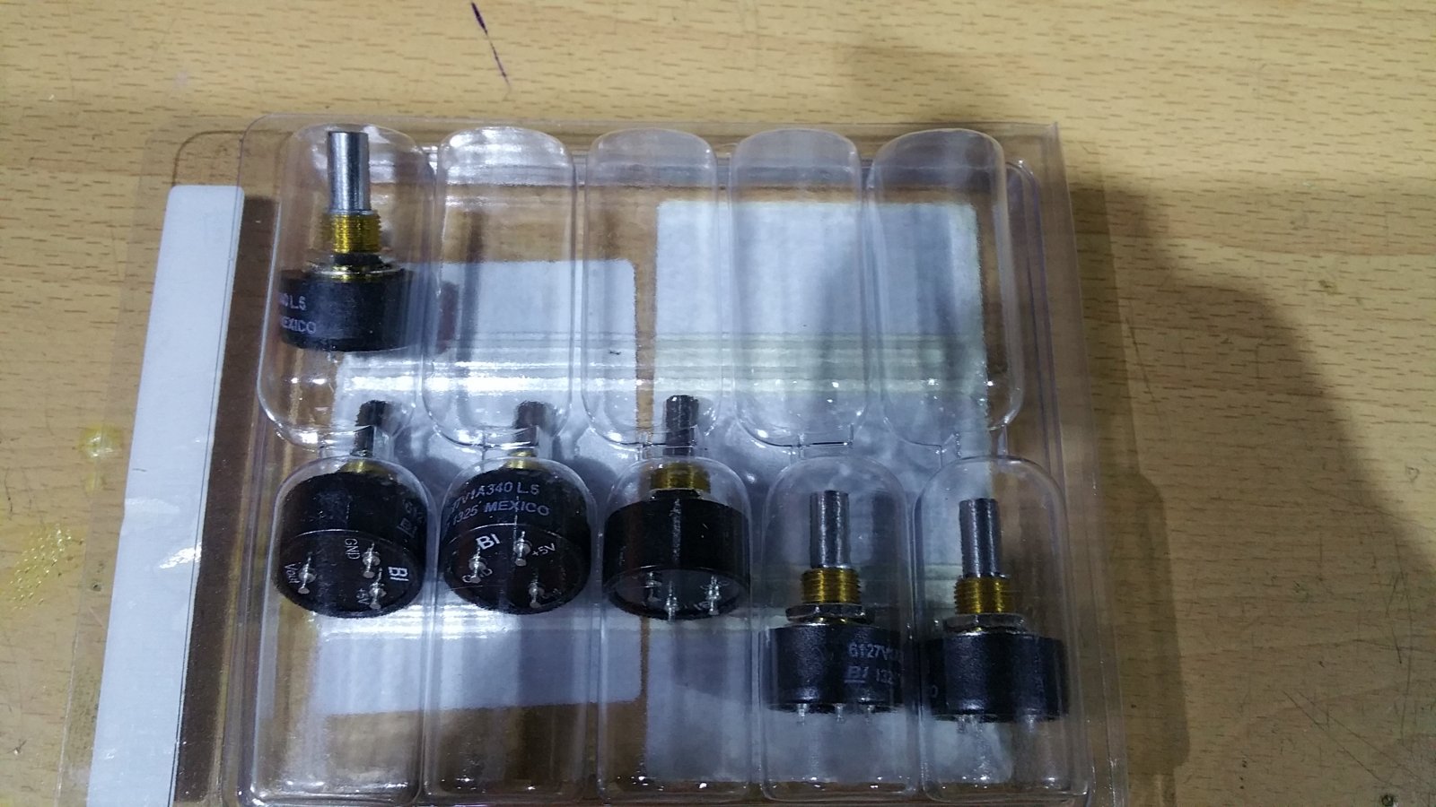

    I asked for some samples like @wannabeaflyer2 did but thought I had no chance as they were expensive were talking £35 each that's £210 !!!
    Well today UPS made a delivery !!
    1475246522173-636497827.jpg 1475246594999-43913638.jpg 1475246676652-355105202.jpg
    www.IGUS.co.uk !!!!! Wow just wow you guys are amazing !
    My mind has been blown !!

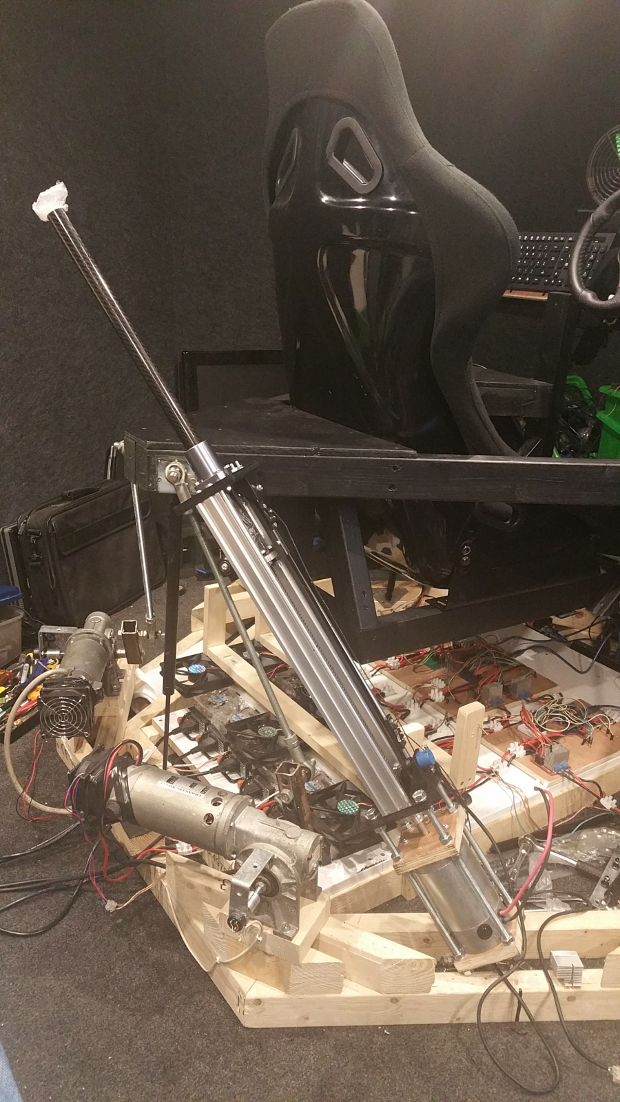

    Ok 1st test hooked up to SMC tool. Crappy MM overheating and seems an issue with the pot maybe, but it is a promising start :) Lots more work to do to iron out little niggles and then make the rest once I have this one perfected.
    That's all folks :D
    edit: please excuse the mess lol

    Looking good @SilentChill, don't know the quality of your pots, but I ended up going to Element 4 and purchased some reasonable quality ones. Gave up on the cheap Chinese spec ones some time ago. Also just warning you that I have recently ordered parts to build a low weight G seat to complement my sim - sorry :oops:. More will be revealed in my thread as it develops:).

    Yeah the pot is just a cheapo Bourns one off ebay, I will look into something better

    I had it working properly yesterday with a decent MM running it. Really good response but I only have 1 of my old PSU's on it so it keeps tripping on hard reverses but should be fine once hooked up to my current 6 which are in parallel. Ball screw seems noisier than I thought and its echoing down the carbon tube, hopefully that will quieten down once its all hooked up.
    Another thing I put the actuator in place at full length and it looks like I will have about 100mm of head room above me when the rig is at its highest :eek: Which is ok really as I'm the tallest person I know :thumbs

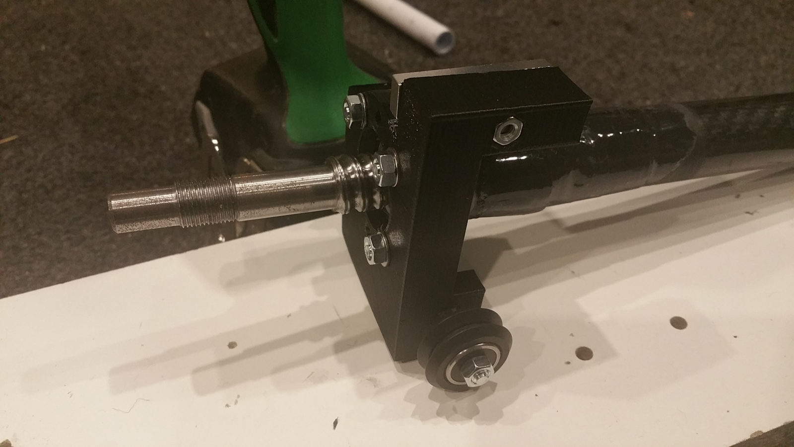

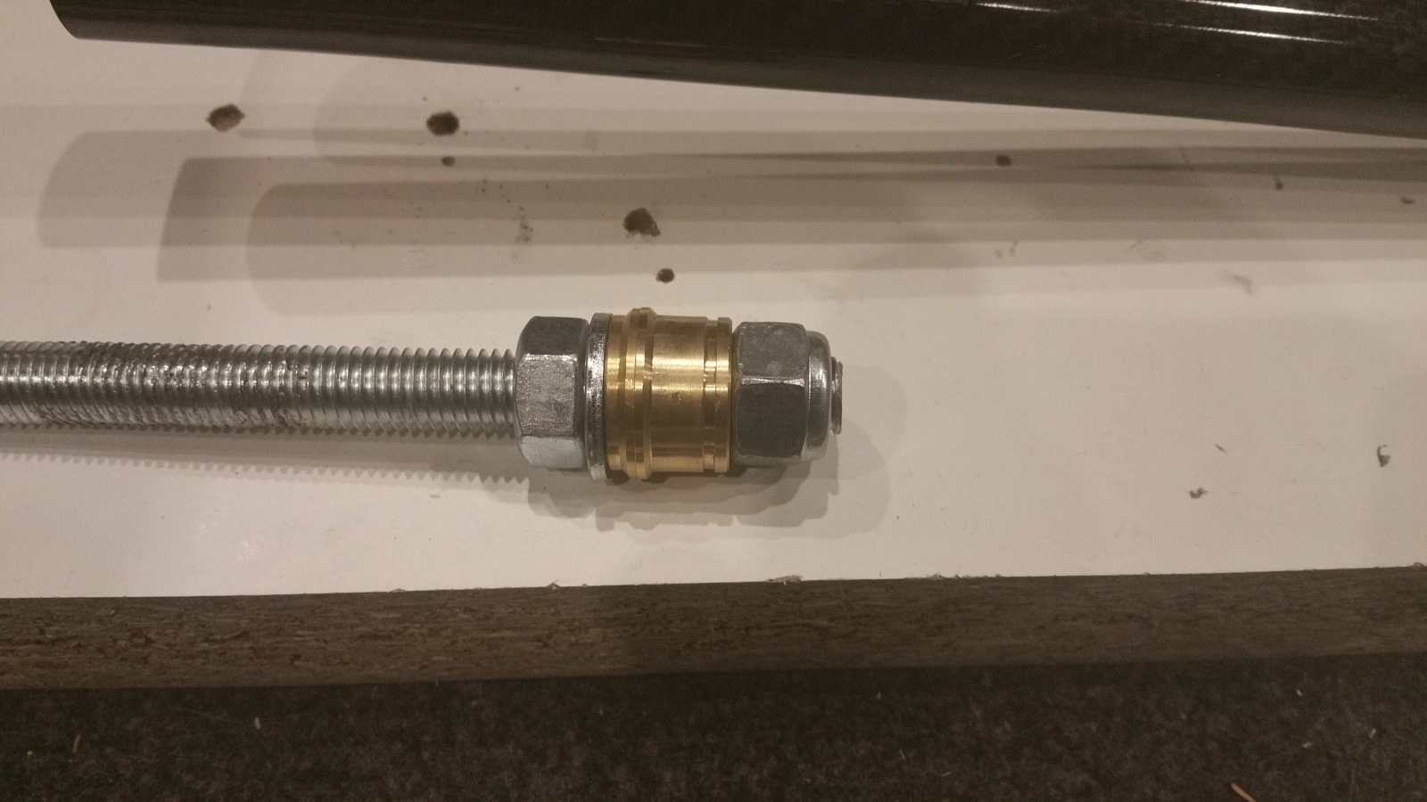

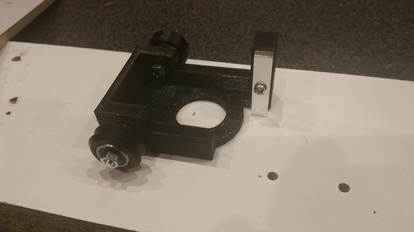

    Sorry @SilentChill but I'm liking some of your enhancements especially the Belt tension clip used to secure the Belt to the Ball screw nut ... OK Cough up where did you get those Clips cos I'm in a mood to spend money and change my design LOL :) see this is why we swap ideas .....Cheers

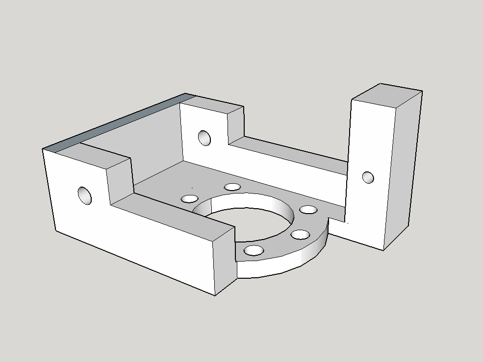

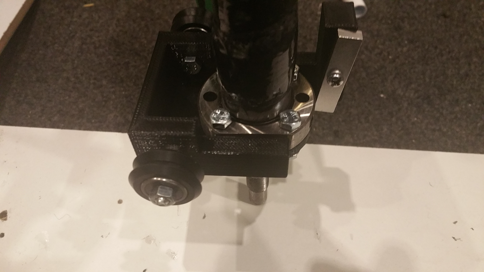

    I will share my 3d print bracket which bolts onto the bottom of the ball screw which now holds the wheels to stop spinning and also the belt holder which doubles up as the limit switch push. You would have to adjust it as you used 20x60 profile I only using 20x40. I can send you the sketchup if ya want

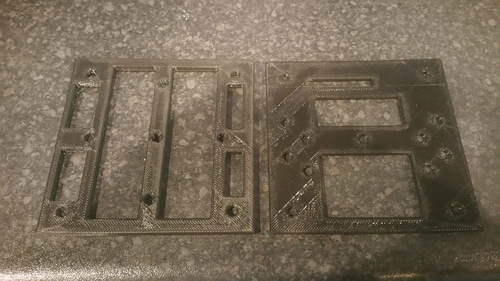

    1st prototype works great and I've finished the design now for the next 5.
    Because I cant afford a CNC just yet I have made a template from the 3D Printer so I can make sure all my holes marry up to each other on the 4 plates and one for the motor bolt holes using a Bench drill and my trusty mitre saw.
    My final design for the bolt screw plate to carry the vslot wheels to stop twisting, hold the GT2 belt and it also acts as a limit switch trigger.

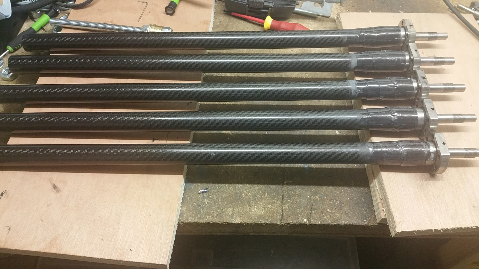

    Wish I had @SeatTime quality working with Carbon Fiber mine just looks a mess but hopefully it will do the job, ended up using Teroson PU6700 adhesive I welded them first with it and then used it with the carbon fiber cloth and they are all straight although the picture doesn't look like it lol. They did withstand me standing on them so fingers crossed they will be strong enough o_O
    Maybe I could sand them down a bit and put some lacquer over it make them look more presentable.

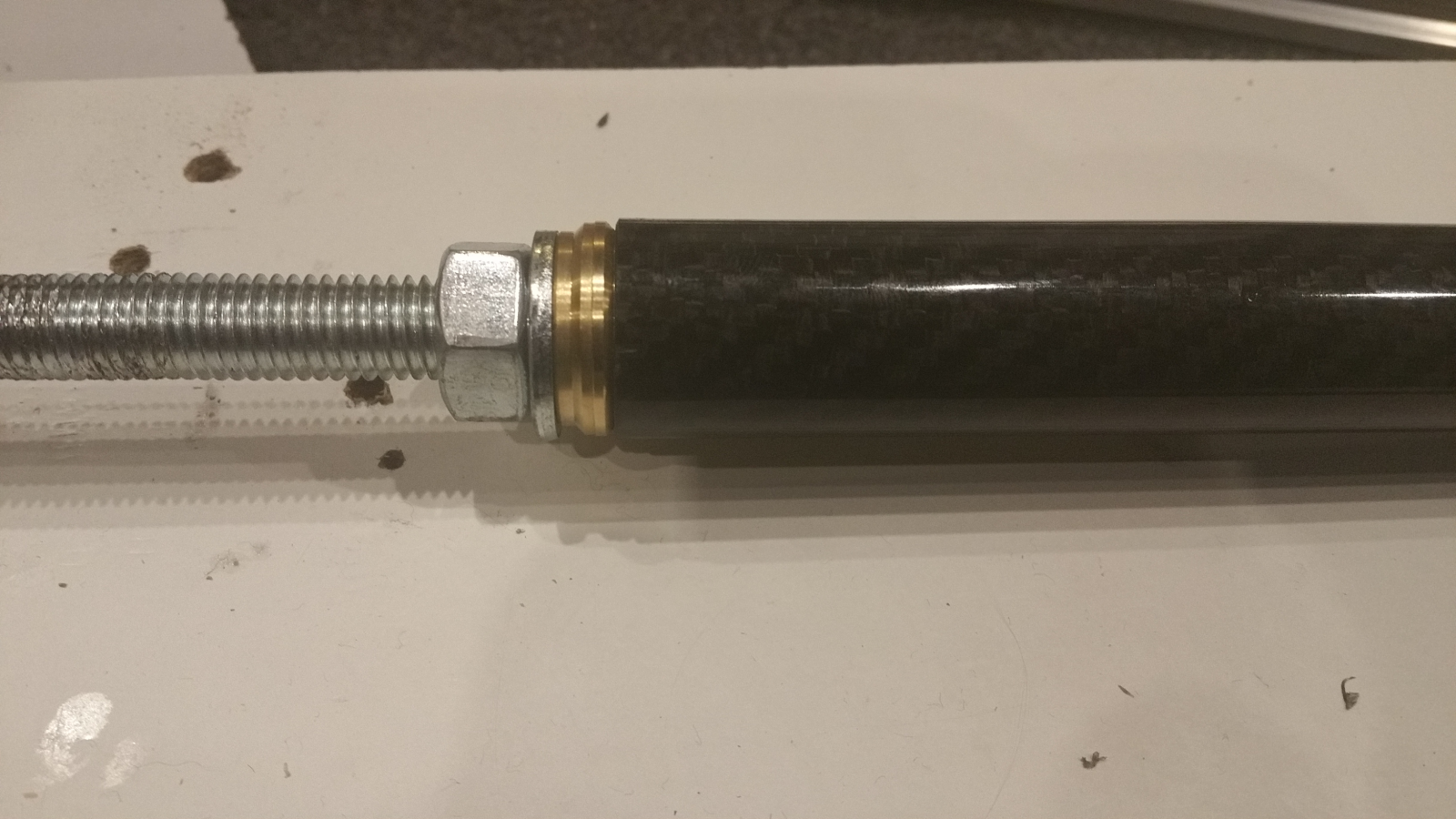

    In the end of the tube I am going to use a 22mm reducer for plumbing it fits really nice and snug so once bonded it shouldn't go anywhere. Again I have no idea if it will hold out or not but as always time will tell :)
    I will either attach the UV's on the end of the M12 thread or use the Rose Joints I already have on the rig.
    And my 1st Actuator kinda in position. Thats at full stretch so the rig will be around 200mm higher than it currently is at centre. :cheers
