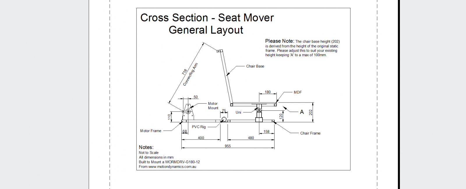

    Seat mover could be added to this easily , a good option because it will allow you to mount 3 big screens and not worry about the weight issue.

    Brilliant. Thank you.

    No problems. Might have to extend the rear a little bit is all.
