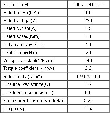

  7. RacingMat
    2,234
    21,094Coins
    Hi!
    The driver you linked cost 300$... the IONI from Granite Device will be much more cheaper!
    About motor, the torque 20N.m is fine.
    You have to check the inertia: if it's over MIGE's, it's not worthy... I haven't see this information on http://www.leadshine.com

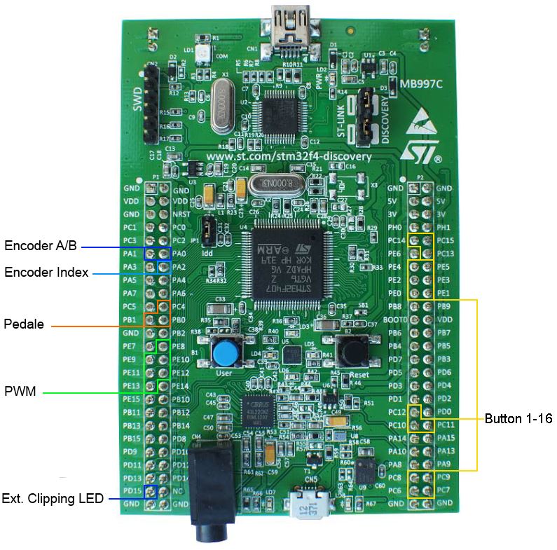

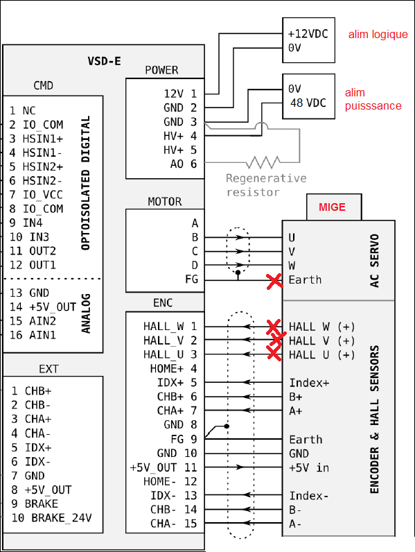

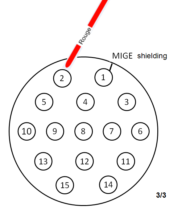

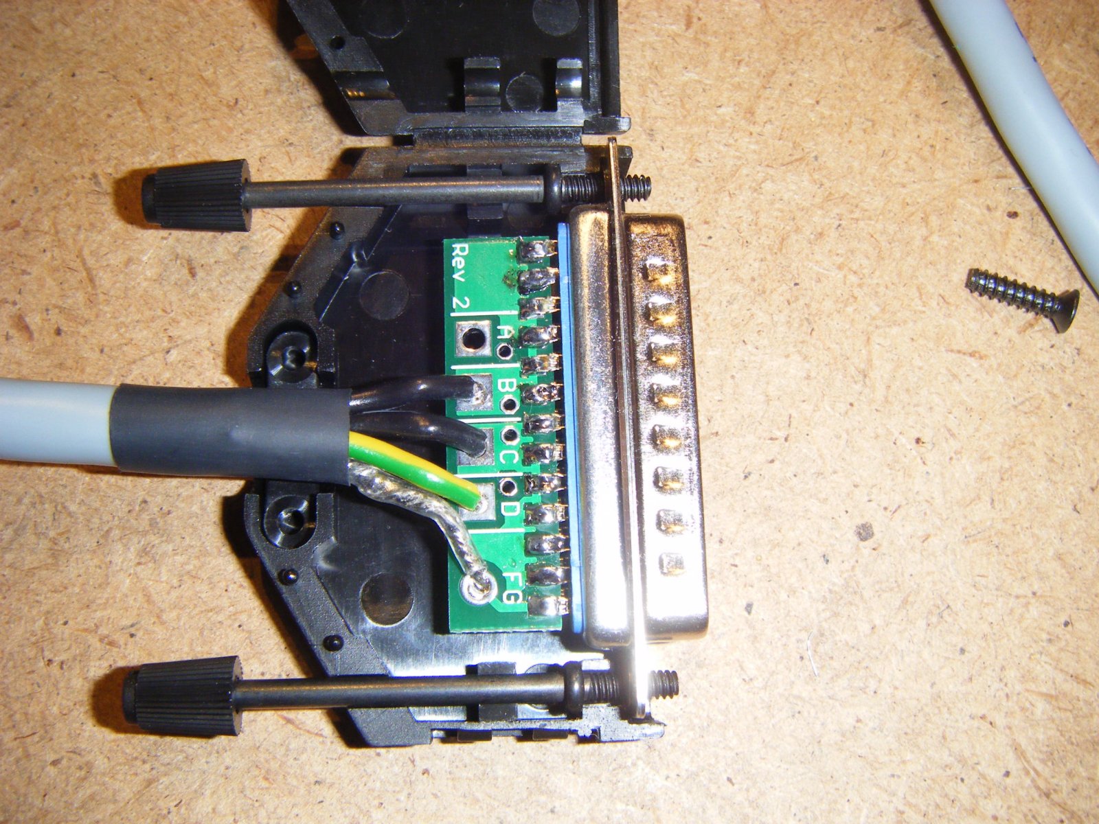

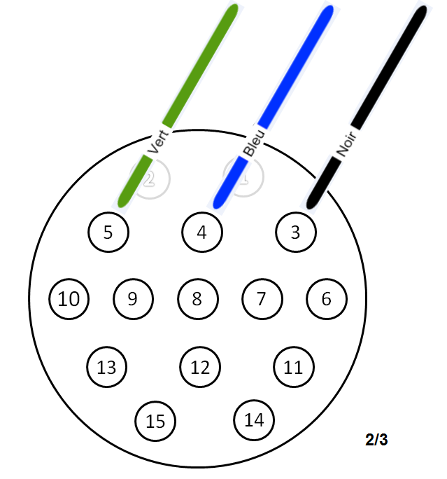

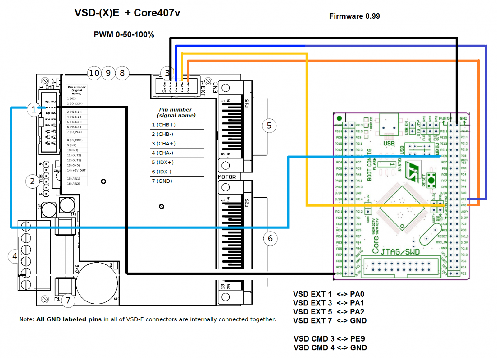

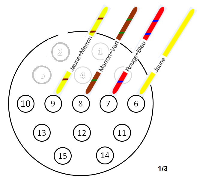

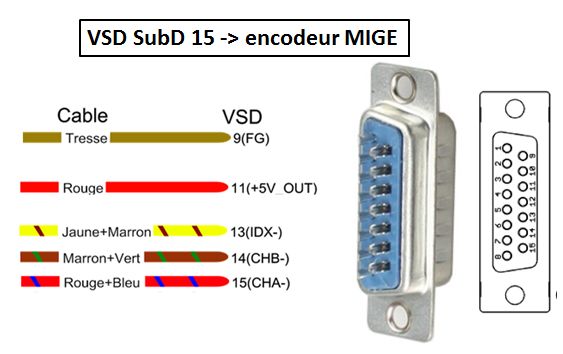

    Hi Racing Mat,
    I have been following this project on iRacing with the Argon.
    I have just made a deal for a VSD-E and I already have the small mige and disco.
    Is your wiring diagram between the VSD-E and the Disco for the same disco that I have attached a pic?
    Also the breakout board that you have on the 25 pin connector. Where did you purchase that?
    Thanks,
    Joe

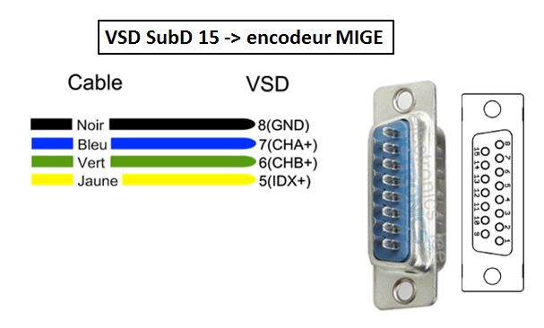

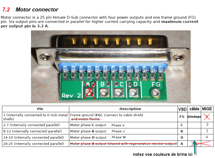

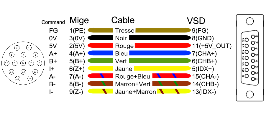

  16. RacingMat
    2,234
    21,094Coins
    @slingshot you bought a Disco
    (I recommand a Core because it's simplier: only 1 cable)
    but Disco is fine and here is wiring diagram!

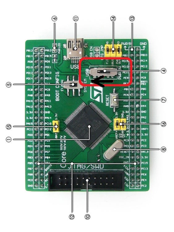

  18. RacingMat
    2,234
    21,094Coins
    hello!
    yes, pinout is different but pins serve the same function
