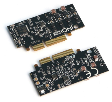

    looks like the IONO will be around 200 USD....looks like a PIC-E board....do you know @RacingMat if its supposed to have something it plugs into? Im trying to decide on the IONI for the VSD-E. IONI is less expensive but looks to need more bits to put it all together....Im also leaning towards the tutorials...im good with pictures and instructions....and I know the IONI wont have much of that for a while.
  5. RacingMat
    2,234
    21,094Coins
    Connector is standard PCI-E 8X ;)
    Yes of course, no tutorial on Ioni yet...

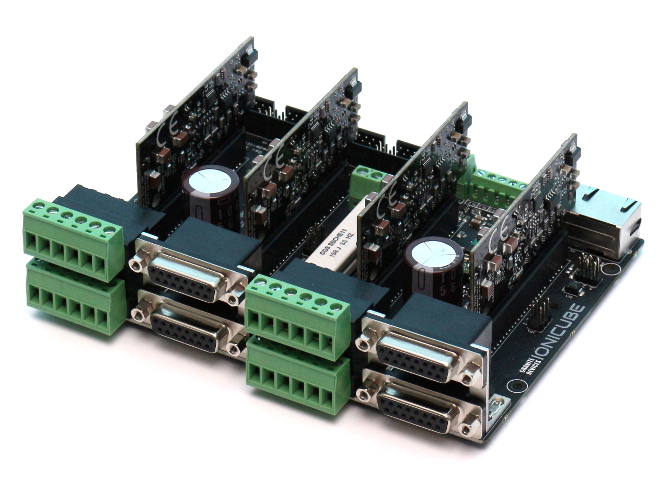

    But where do you connect the motor? From the picture of IONI it seems it doesn't have any connectors?
    It looks to me one will need that IONICUBE motherboard too, with connectors for motors and connect to PC.. Using only one board as one axis (one motor) to control?

    Right, that does 4 though. I didnt know if I could just use the pc or would need a brekout board like the one above...then Im thinking about how you would send power to this thing,..woudl I need wires hanging out the back of my pc?

    I think you should avoid to use this into a computer...
    Use it with a socket: you gather some pins for power supply and use some other pins to encoder reading and communication with Disco or Core.
    Just like VSD

    The only pics I see are those on the board that would fit in the pci slot....doesnt feel like a good solution to get stable power in. I think I am back to leaning against the Argon.....just looked at the schematics...o crap....im scared im going to blow up something expensive

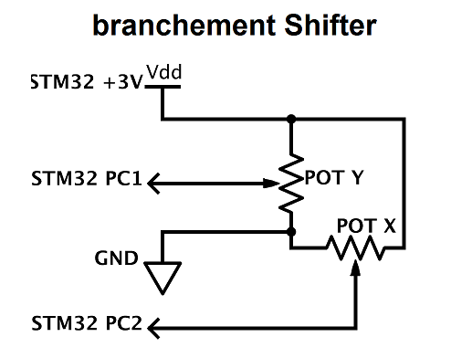

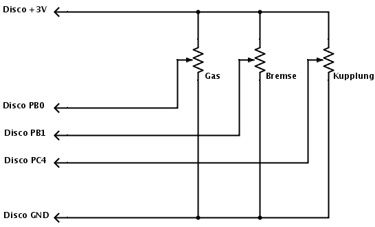

    Would I be correct in understanding that -
    The STM board CORE407V is used to directly wire up buttons too - so in essence a DIY shifter and pedal (mixture of buttons and pots) could all be hooked to this board along with the servo driver.
    Thanks again! (and the rest of you guys!)

    @Bobsyouruncle187
    yep! you can wire pedals, shifter and button box with the disco or core :)
    shifter in H mode is possible with the firmware as it uses 2 pots.
