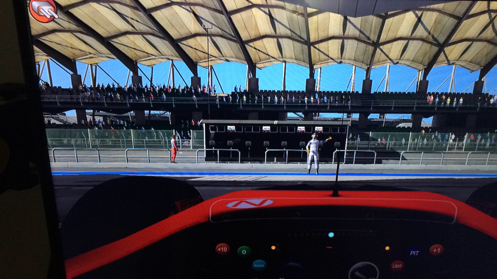

    when i get in a race and while sitting in the pits i see a icon like this (top left corner) IMG_1061.JPG you should too i guess and numbers in tuning center don't appear immediately they appear after a few seconds and then motion comes alive.
    with the g button on your keyboard you can enable disable hardware.
