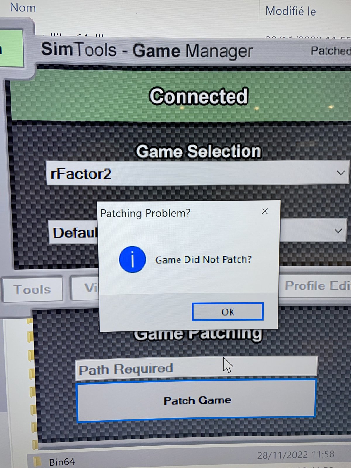

    I'm getting "Game Did Not Patch?" error after selecting game's path in game manager (screenshot attatched).
    I've already tried reinstalling it to C:/ but it didn't change anything.
    I'd be very glad for a solution to this problem.

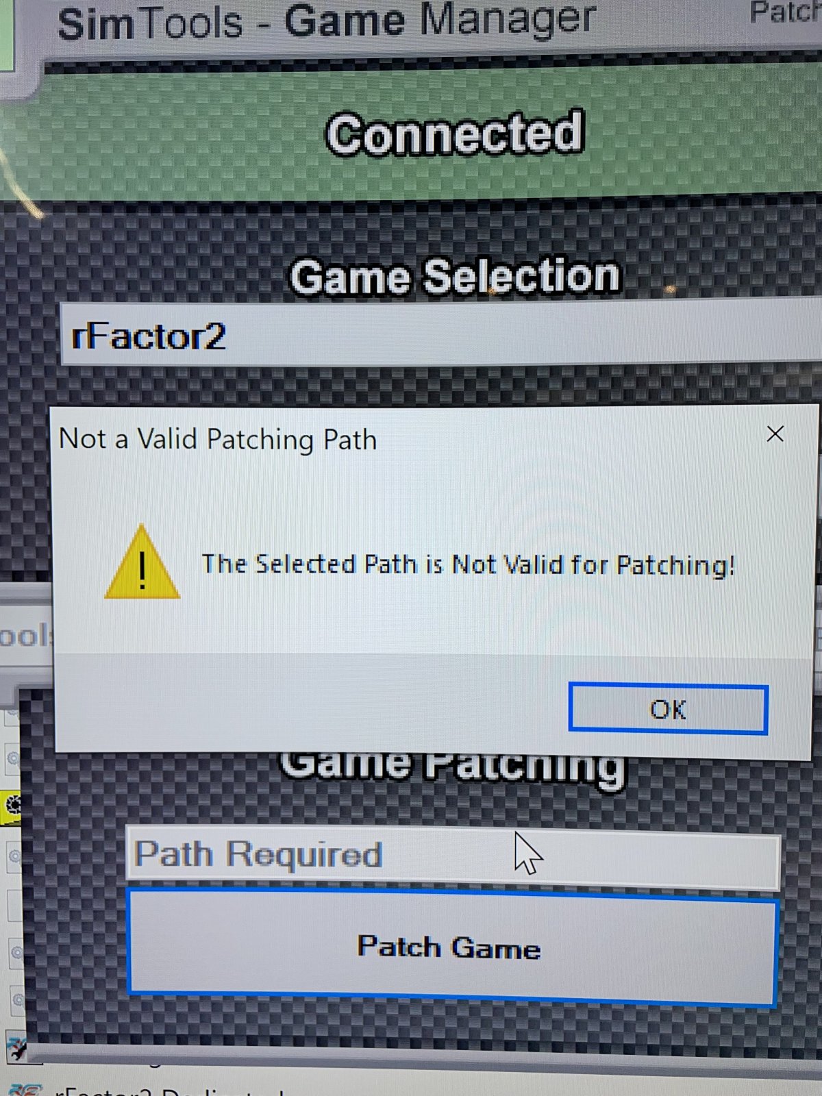

    Okay, I did it and now I'm getting "The Selected Path is not Valid for Patching" error. At least that's some progress I guess. Do you have any further tips?

    Hi @Pawel it has to be root folder for patch (your install folder)
    ie
    C:\Program Files (x86)\Steam\steamapps\common\rFactor 2
    not plugins folder but the plugins folder needs to be there for it to work

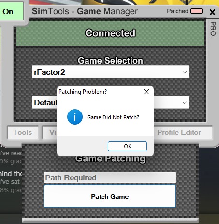

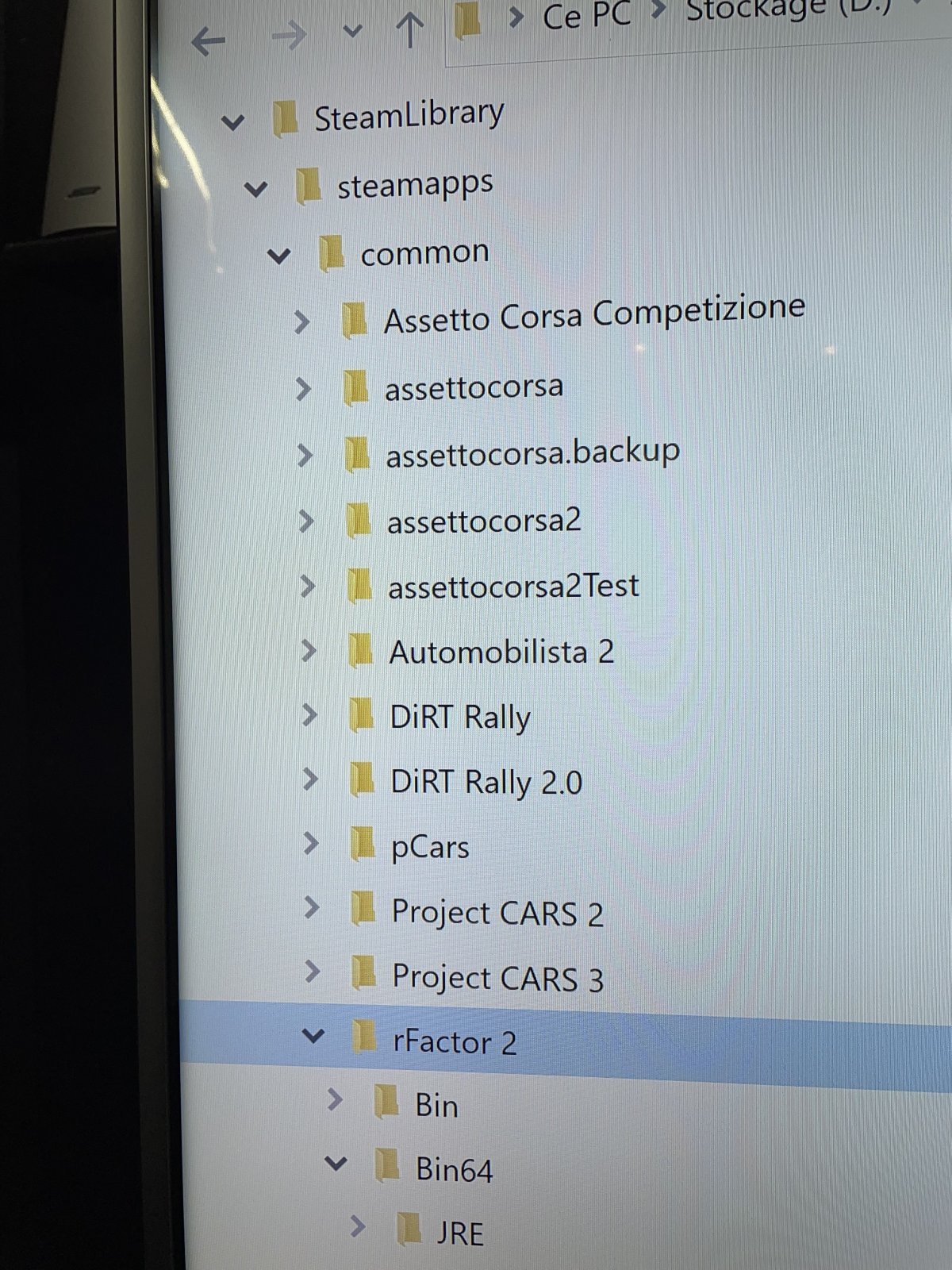

    I shared some pictures for clearer explanation of the issue
    Image 5922 shows how my gamer appears: Steam library,/steamapps:....
    Image 5923 shows the message I have when I clic on RFactor2: the patching fails
    Image 5924 shows the message I have when I clic on whatever folder into the >RFactor 2 folder: wrong directory.
    I have to add that into the Bin64 folder, there is a folder named "pluggings"
    Any idea to help?

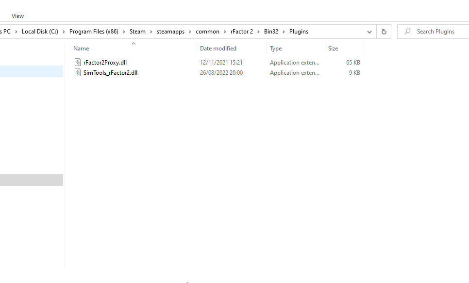

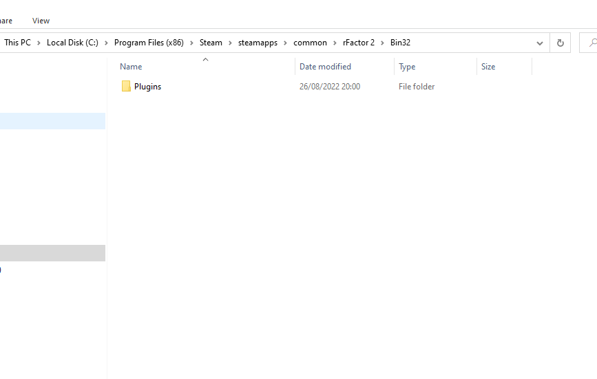

    @Gouffy56 You need to create a folder in the root of rfactor 2 called Bin32 and then open that a make another folder called Plugins then patch the root folder of the game :thumbs

    I did it (creating a Bin32 folder and copying the folder plugins into it and patching rFactor 2) and it worked great! Thank you for this efficient help. That's the kind of stuff you cannot guess.
