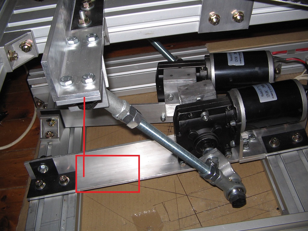

    Cool a lot of people still dont treat stuff like that with care if you notice what's in the picture 240v is all exposed only takes a child or a drunken friend to put a finger in the wrong place and they are in a serious way, even if the circuit breaker trips.

    eaorobbie,
    I can wire a home, but electronics, don't know squat...but yes, I noticed the open exposure on the pic...only assumed it was around the builder - BUT, we never assume around electricity....will get you killed in less than a heartbeat......you and I are on the same page when it comes to electrical power.

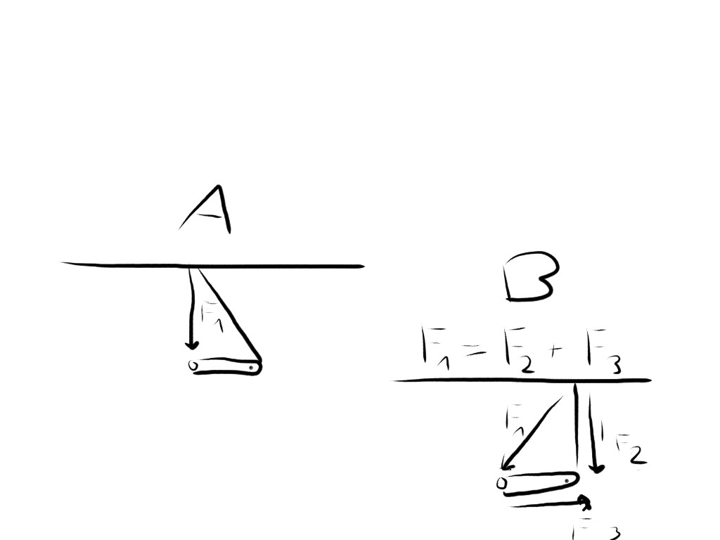

    Hey Mat,
    i think Rob means that the stress is less for the motor lever when the connection rod is more above the pivot like that:
    F1 on example B is larger than F1 on example A

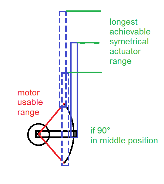

    So are we saying that the mounting point on the platform should be directly above the motor shaft? Obviously the angle of the connection rod would depend on the length of the crank arm Like So:
    BTW. What is a recommended crank arm length? My platform is going to be used for flight sims only so quick motion is not the main concern.

    It will depend on what motors you plan to use, design of frame that will determine lever length. If you plan to use a similar design, you are going to need 12v boat winch motors. 24v motors or 240v and the load is higher up than where the lever connects to the frame.
    Lever length will need to be calculated depending on how far you want to swing it. For flight, obviously more than race, but take into account the frame design.
    As for lever placement, in the pic, I have drawn a red line from where the motor lever should actually sit. Ideally, keep it at a 90 deg angle to the top frame, so its all square. The motor shown in the pic is in the wrong place. I advised that builder ages ago to move the motor so its more level, It worked first go for him.
    If I have made a mistake, please advise.

    This is not a simple calc mate, Need to take in consideration the torque of the motor but would recommend a lever that has multiple holes on it, save working out all the calcs , but rule of thumb does apply, you can draw it in Sketch Up to test how long a lever is needed for the amount of roll and pitch that is needed. I prefer AutoCad but that's not free and takes a while to build a decent drawing, but I am trained in it. I would work on about 20 deg for all. Any more results in a ridiculous feel once you sitting on top, like the CKAS way too much to feel real, keep your pivot point under the frame as closed to base as possible as the further it is away the forces increase badly. Resulting in loss of motion due to over stressed motors.
    And no the top mounting point doesn't need to be above the centre of the motor. Just make sure in the full range of movement , the connecting rods doesn't go vertical ie 90 deg. I like to use 160 deg of rotation for the motor arm movement which results in the connecting rod not equaling vertical.
