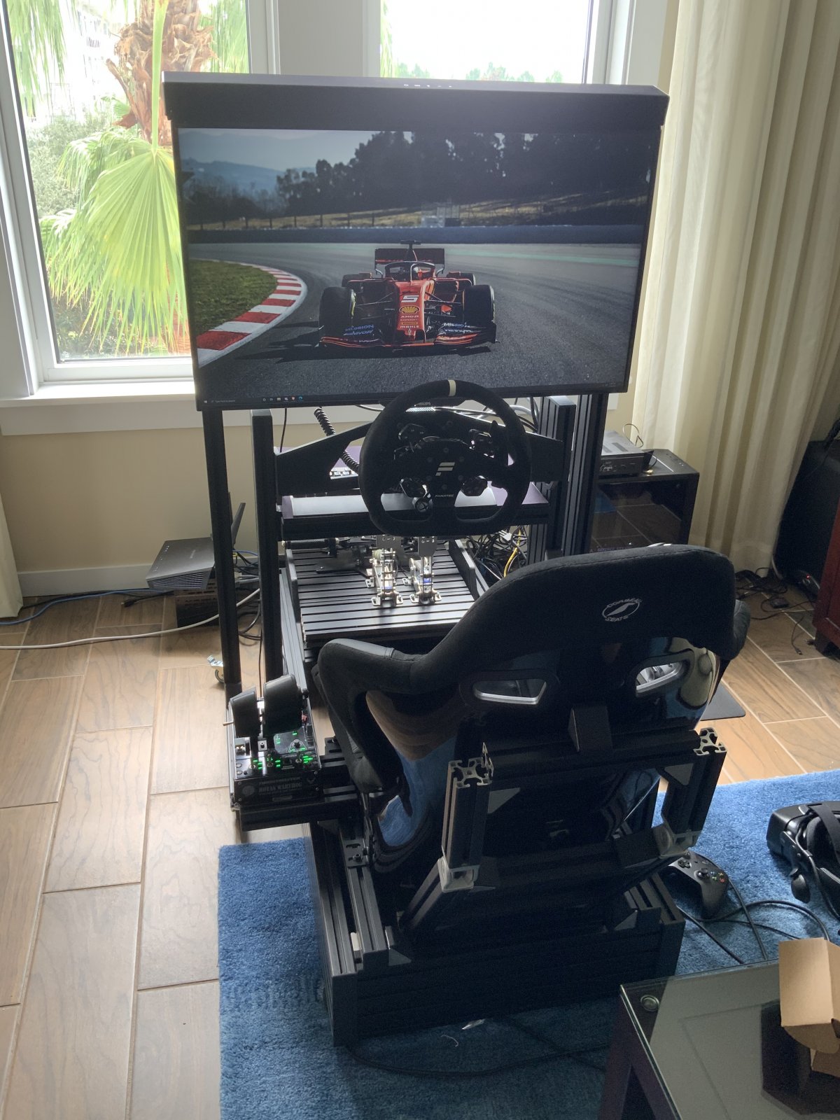

    Hi guys,
    I've always been a big simulator fan; primarily flight sims but more recently racing sims as well. My two favorite sims at the moment are IL-2 Great Battles and iRacing. I use Valve Index as a VR headset for both, as well as a Buttkicker Gamer2 for tactile. I started off small 5 years ago with an Obutto Revolution for a frame, but it wasn't sturdy enough for direct drive FFB and I knew I'd be looking at platform motion at some point in the future, so early this year I went with a Simlab P1X, which seems more than sturdy enough.
    Here's my rig in racing mode:

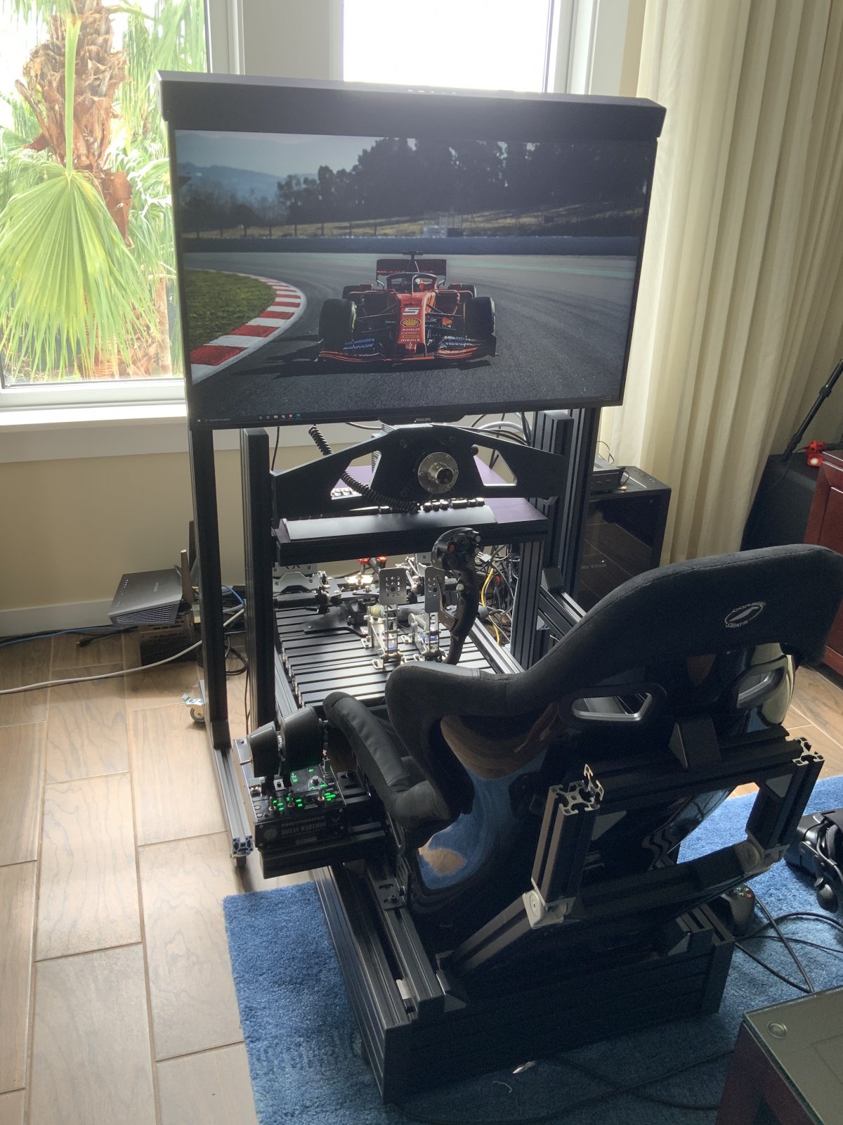

    And here it is in flying mode:
    In flying mode I have to remove the racing seat cushion because there isn't enough room for the stick extension. This isn't a problem because I'll be fabricating new seat cushions anyways to go with the GSeat paddles.
