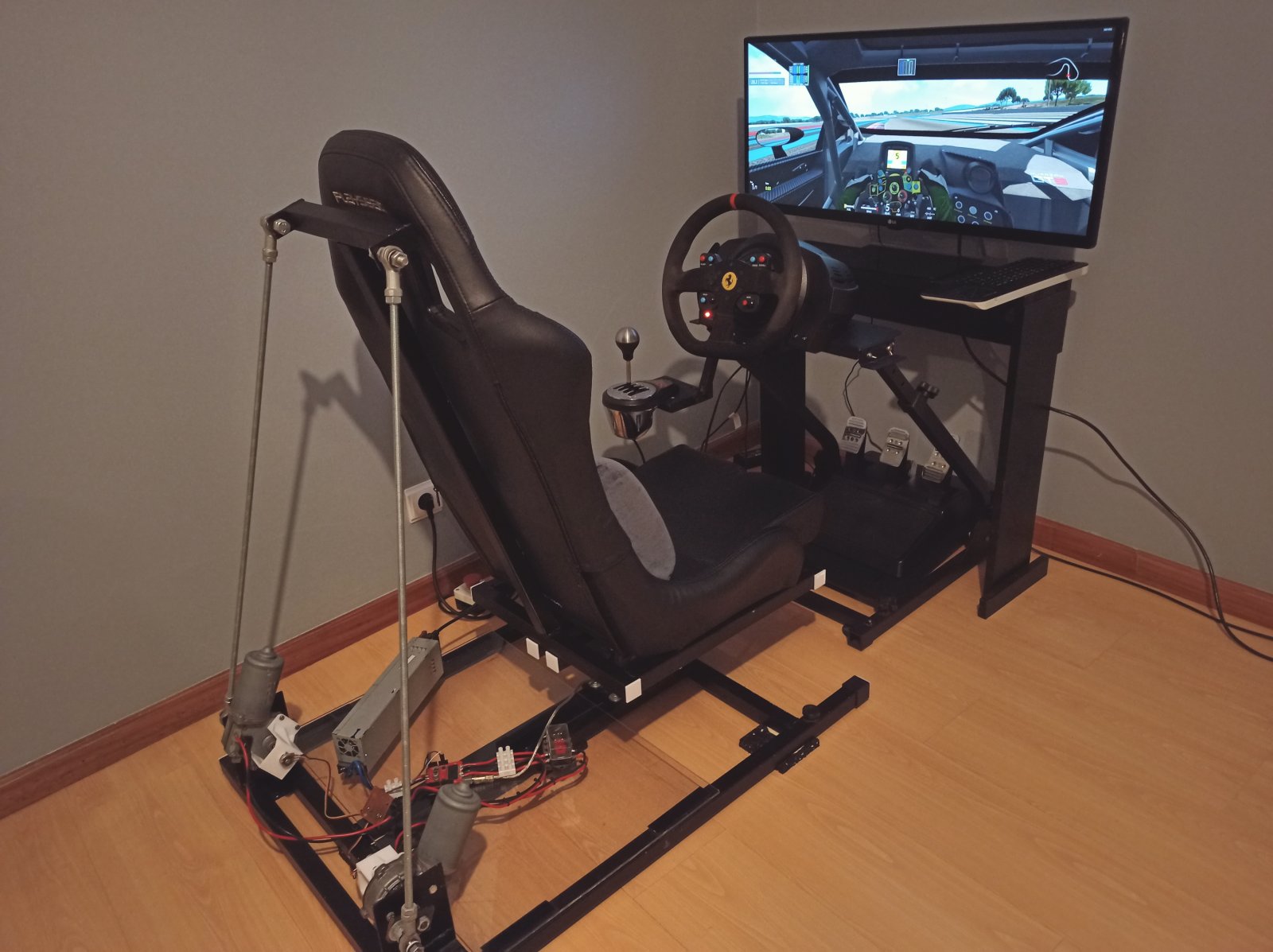

    Hi OP. I have a 2dof seatmover with wiper motors (https://www.smolka-berlin.de/online...Getriebemotor_24_V_DC_-_Sonderangebot!!!/4398) connected with rods at shoulders level. I wanted to make the whole thing more compact and was wondering if I could use the same motors and place them right below the seat like you did, or is this going to stress them out. The motors you use look significantly more powerful. Any idea?

    The shoulder mount design you have is ideal for wiper motors, as they are not very powerful and the shoulder mount design maximises inherent design leverage.
    A compact rig like mine needs lots of torque and hence wiper motors are not a good choice. Personally I use 200W motors with 60:1 gearboxes because of the torque they can provide.
