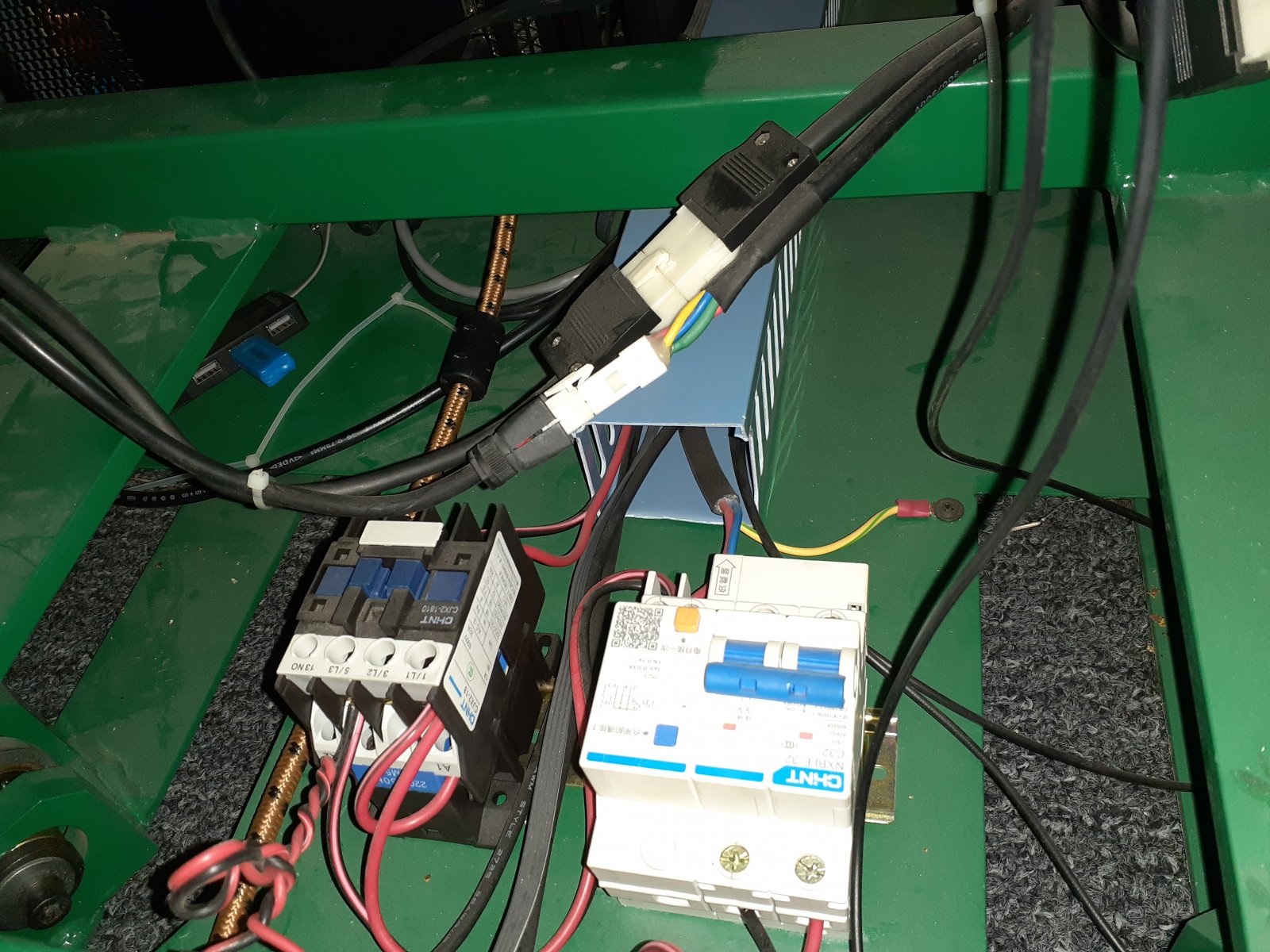

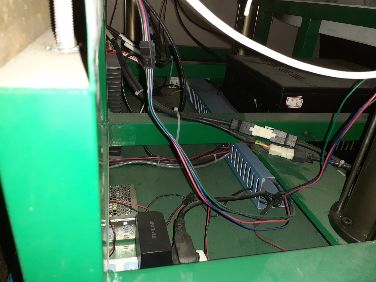

    So I bought out this virtual reality arcade and they had NineD VR rides. I am pretty sick of trying to get the Chinese games that came with them dialed in as they are not great even when they work. So here are my goals before I tear into them.
    1. Fresh installs of Windows 10 that free the machines of authentication through China and regular intrusions of Baidu junk etc.
    2. Install Steam on Each machine and update the outdated headsets.
    3. Install motion control software best suited to run existing hardware smoothly and efficiently.
    4. Covert Gun Seat into Flight Sim
    I am pretty well fresh off the boat with the Dof thing. I built a static 3 screen racing sim which led me into the VR arcade opportunity but as far as actuators and controllers I am at step zero which I hope will be of benefit to whomever might be willing to send me on the correct path. @Thanos has come up in my searches so perhaps that will help.
    Hardware pics of project 1, Tank to follow.
    List of current machines.

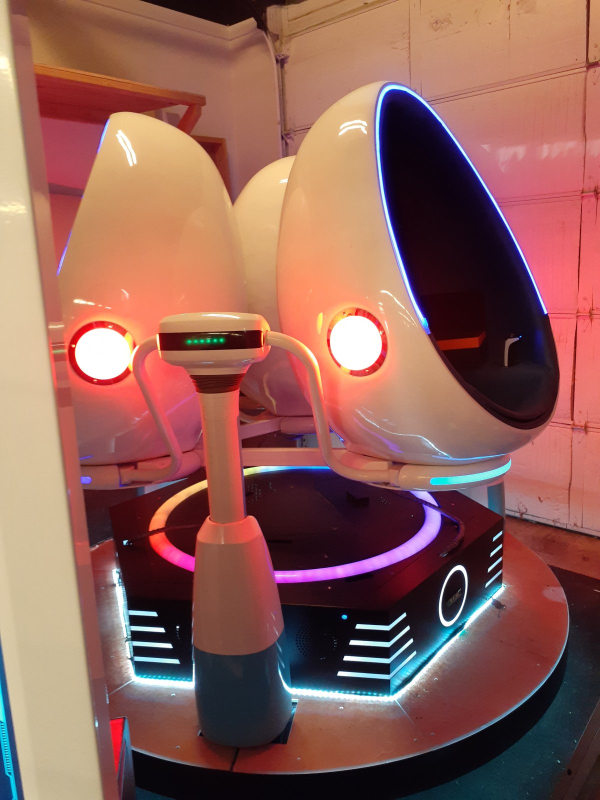

    1x Double Egg VR experience, plan to leave as is for now
    1x Triple Egg VR experience, Never plugged in by seller, 3x actuators and spins
    1x platform, spins, no plans to use

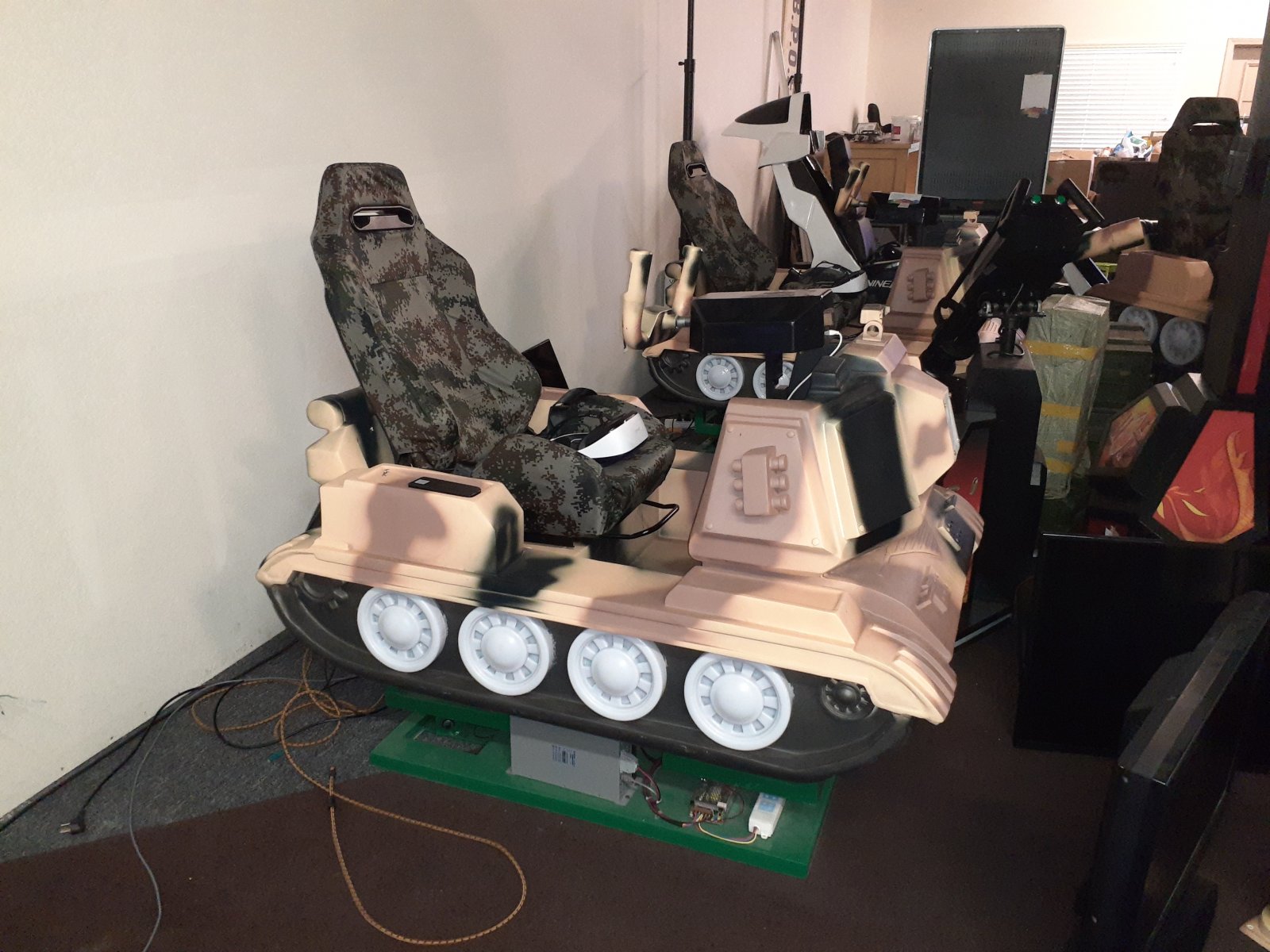

    3x Tank, uses 3 linear actuators, 2 in back 1 in front.
    2x Seats, 1 currently set as racing sim using PS4 Force Feedback and one with weird gun.
    3x linear actuators 2 in front, 1 in back.
    Currently running Project Cars and motion is actuated by pedals.
    1x Space Car. Same as car above but with more Body Work.

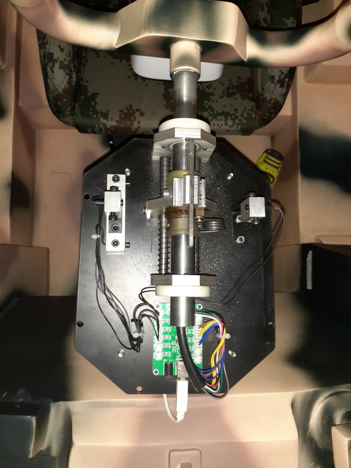

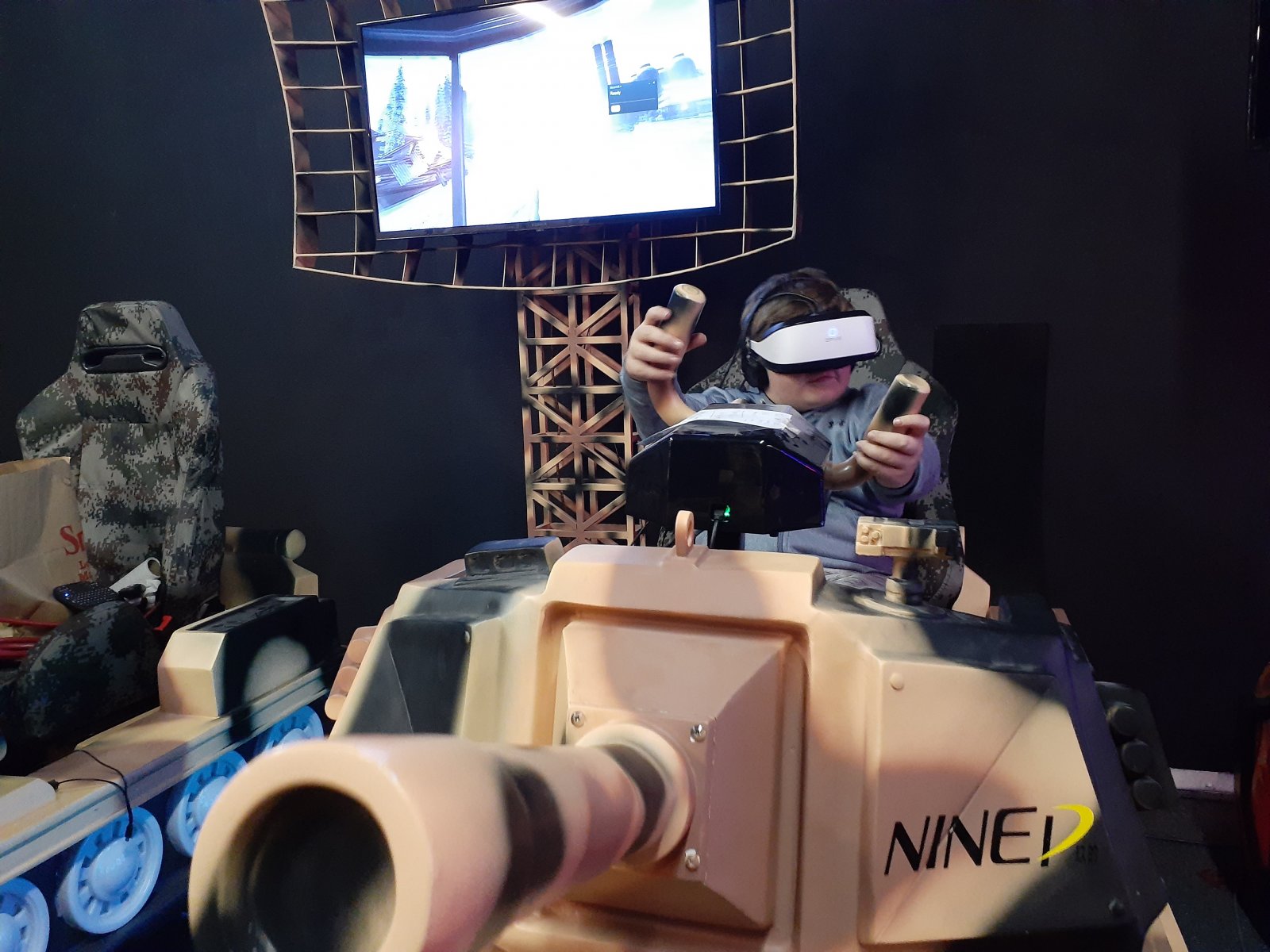

    Here is the tank. It runs off of a Unreal Engine Game right now.

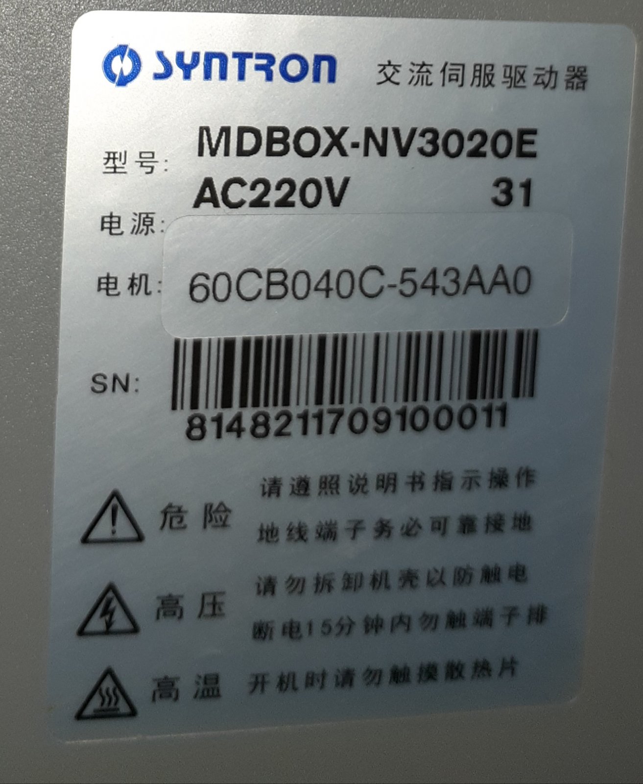

    MDBOX-NV3020E 220V
    20191226_144257.jpg 20191226_144237.jpg 20191226_144227.jpg 20191226_144257.jpg 20191226_144237.jpg 20191226_144227.jpg 20191226_141417.jpg 20191226_144257.jpg 20191226_144237.jpg 20191226_144227.jpg 20191226_141417.jpg 20191226_124817.jpg

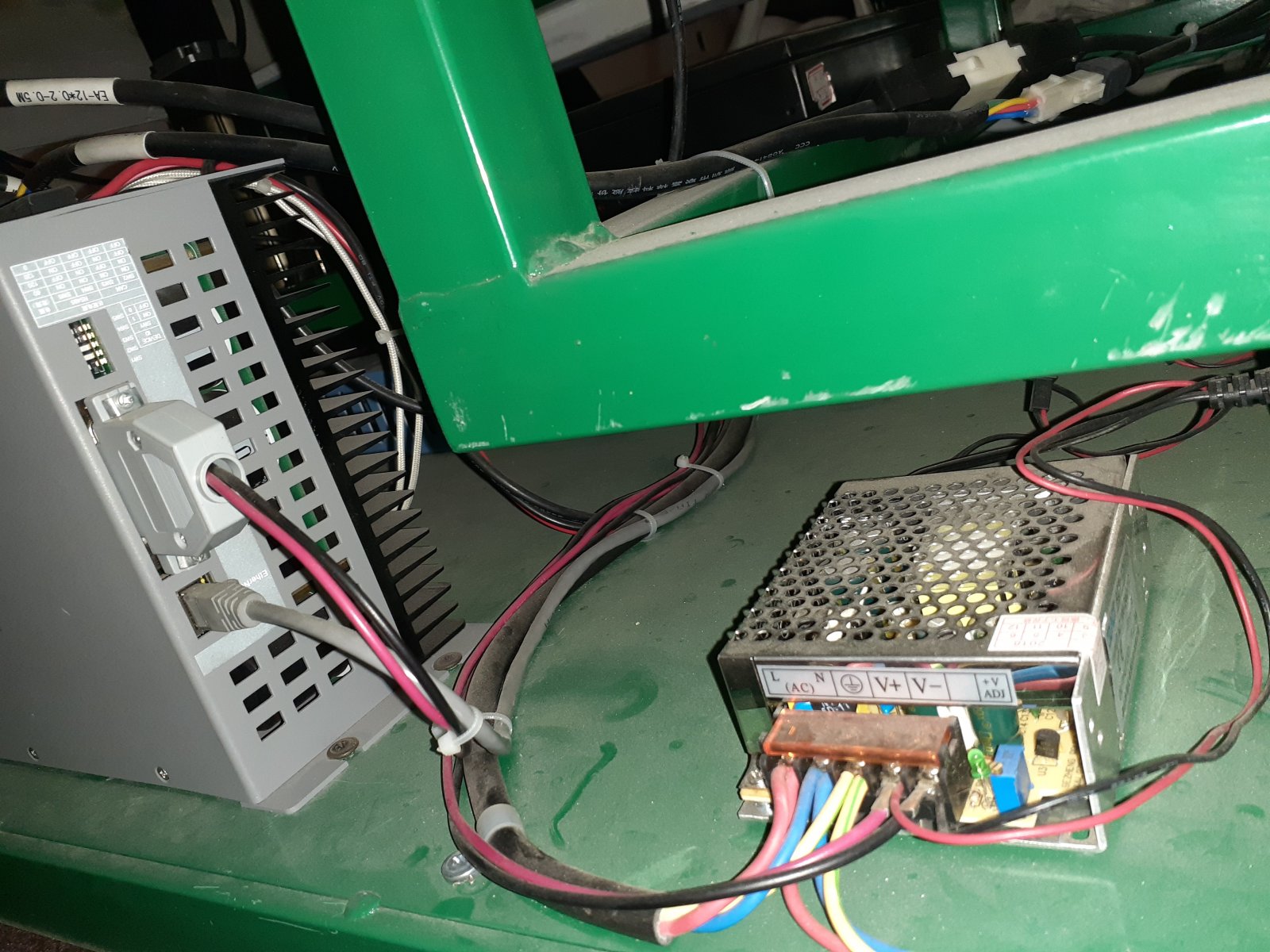

    Sorry, looks like some of the photos attached multiple times. Not gonna try to edit the original post in case this forum is like others that mess up when you try to edit photos.
  3. Virtually Here
    Virtually Here New Member
    Dec 26, 2019
    19
    169Coins
    Here is the control interface. Probably not important to the topic but figured I could add it in case somebody needs it.
    21,595
    151,233Coins
    You need a way for SimTools to communicate with the drive and @Thanos controller and advice is likely the best way to do that, as he has extensive experience in jailbreaking commercial hardware.
  5. Thanos
    Jul 6, 2017
    1,371
    Electronics Engineer
    United States
    2,854Coins
    +1,071 / 9 / -0
    Yes, just shout me an email, I have controller for MDBOX (AMC compatible) that you can use with simtools or FlyPT mover...

    So this one was sitting in the crate for a year and a half in a field. When I cracked it open there were signs of water intrusion so I brought it in and let it dry for a month or so.
    She fired up and everything seems in order...
