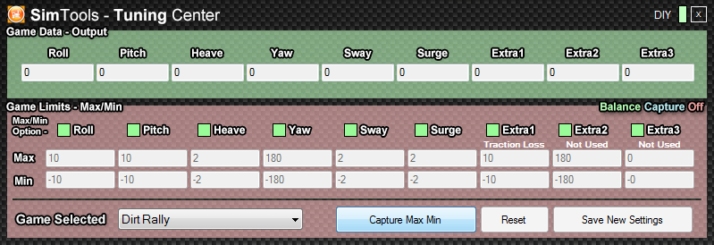

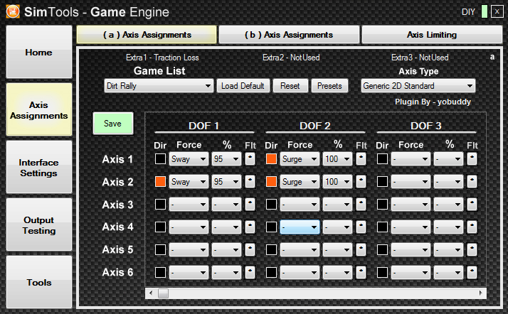

    These are my settings for Dirt rally
  4. bob williams
    bob williams OSW sfx100
    Apr 18, 2012
    117
    IT
    Ermelo, Netherlands
    87Coins
    +43 / 1 / -0
    And tuning center...

    Hello friend, thanks for the pictures but, i think that all the axxis can't up to 100 all togheter because a high values can't give a good resolution for the others. What kind of simulator have you?
  6. bob williams
    Apr 18, 2012
    117
    IT
    Ermelo, Netherlands
    87Coins
    +43 / 1 / -0
    I have a 2dof scn5 100mm. Axis limit is at 90% I believe. A value of 100 in the axis assignment. Is the 90% axis limit. As far as I know.
