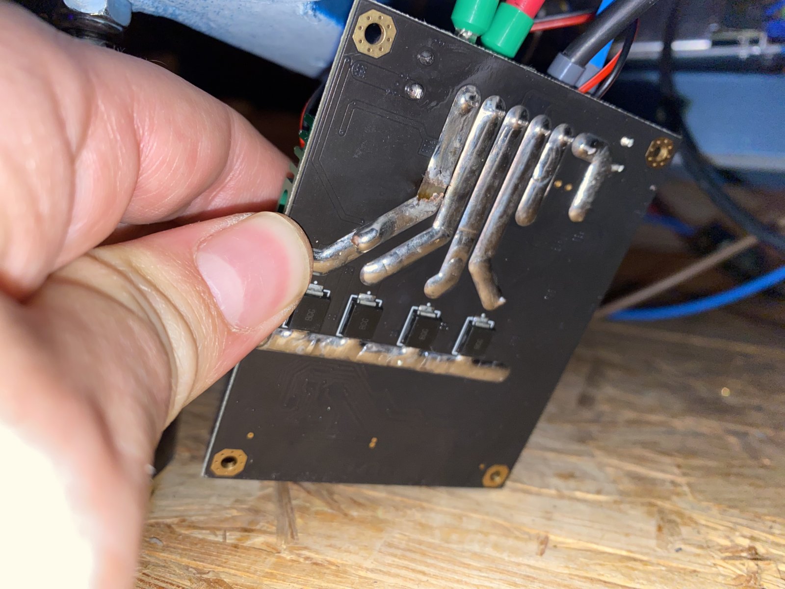

    Finally I I throw it in the trash these boards, they (the boards I received) are literally crap. I don't know how they install that little plugs, if it is impossible insert the 35A sized wires I don't mind how impossible plug 100A sized wire will be.
    My motors consume 31A (750W 24V) and the boards go so hot that the tin literally melts and the nude track go on fire. As I said, crap boards.

  14. Gadget999
    1,975
    12,053Coins
    +488 / 10 / -0
    One of my boards did this, however the fault was not the board but the pid tuning and a failed battery. How did you tune the pid ? My motor was using too much P and overshooting very fast. An alternative is to use 12v and slowly ramp the P up

    You can repair this board with solder
    Running on 12v may help you get the pid under control

    Yes, the first time the track burned I repaired it with copper, lit and soldering. The boards are still running but started to bounce and have a weird behavior (maybe caused by a bad config).
    I'll try your tips to configure that but what I can't do is running it at 12V coz the motors are 24V motors.

  19. Gadget999
    1,975
    12,053Coins
    +488 / 10 / -0
    a 24v motor will run at 12v
    one of my sims runs 24v 32 amp brushed motors - they are almost too powerful and move at very high speeds
    running them at 12v gets the motion under control
    you can see it on 12v here - at 24v it was too frightening for the driver !
  20. Gadget999
    1,975
    12,053Coins
    +488 / 10 / -0
    my guess is the board has turned on in both directions at the same time - you have probably changed direction back and forth much faster then the board can switch. I have coded a down time when the direction changes back and forth again to prevent this from happening - a bit like a debounce
