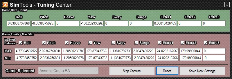

    Am trying to do a bit of experimentation with Traction Loss (Extra 1 Channel) With Assetto Crosa.
    Right now i'm just trying to get the raw data values for Extra 1 into my processing code on Arduino Nano.
    I have Sim Tools 1.3 with AC Plug-in. I've mapped Axis 1 to Extra 1 in Axis Assignments.
    With AC Running I can See Extra 1 in the SimTools Tuning Center is generating a value of approximately between -20 to +20 however it has 13 decimal places !!!!
    eg: 20.2188758850098 to -20.2188758850098
    Is there a way within Sim Tools to format the data to an 0 decimal places ?
    i don't need the decimal places ?

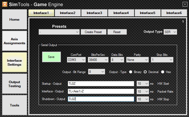

    I've got my Interface setup as follows ....
    My Arduino code is working .. i have a second serial (software) port set up on the Arduino with a debug console running on a small linux PC .... if i open the serial (USB) monitor in the IDE and manually send data to it it processes the string correctly.
    Some examples of manually sent data ....
    TL5Z = a value of 5
    TL-11Z = a value of -11
    TL19Z = a value of 19
    However if I close the serial (USB) monitor and allow the Arduino to receive data from Sim Tools all it ever sends is a value of 127
    Sent string = TL127Z
    No matter what i do it seems that the Axis 1 value never equals the Extra 1 value .. its always 127 ????
