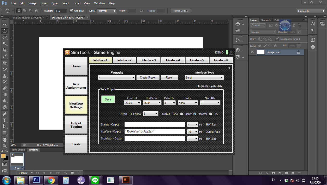

    Hello.
    I uploade RCModelSimToolsMode.ino to Arduino Uno R3 and wired the servo as yours Picture
    RC Model Test_InterfaceConfig.cfg can't drag in Preset box. It show "RC Model Test_InterfaceConfig.cfg is not a valid Simtools preset file!
    22,215
    154,759Coins
    +11,213 / 57 / -2
    Are you using SimTools 2, if so there is a change to the Interface Settings, so instead of Axis1 is is Axis1a and so on for each of the Axis.
    It would help if you post pictures of all of your settings.

    Try Decimal instead of Binary in the Interface Settings @Schopfer.

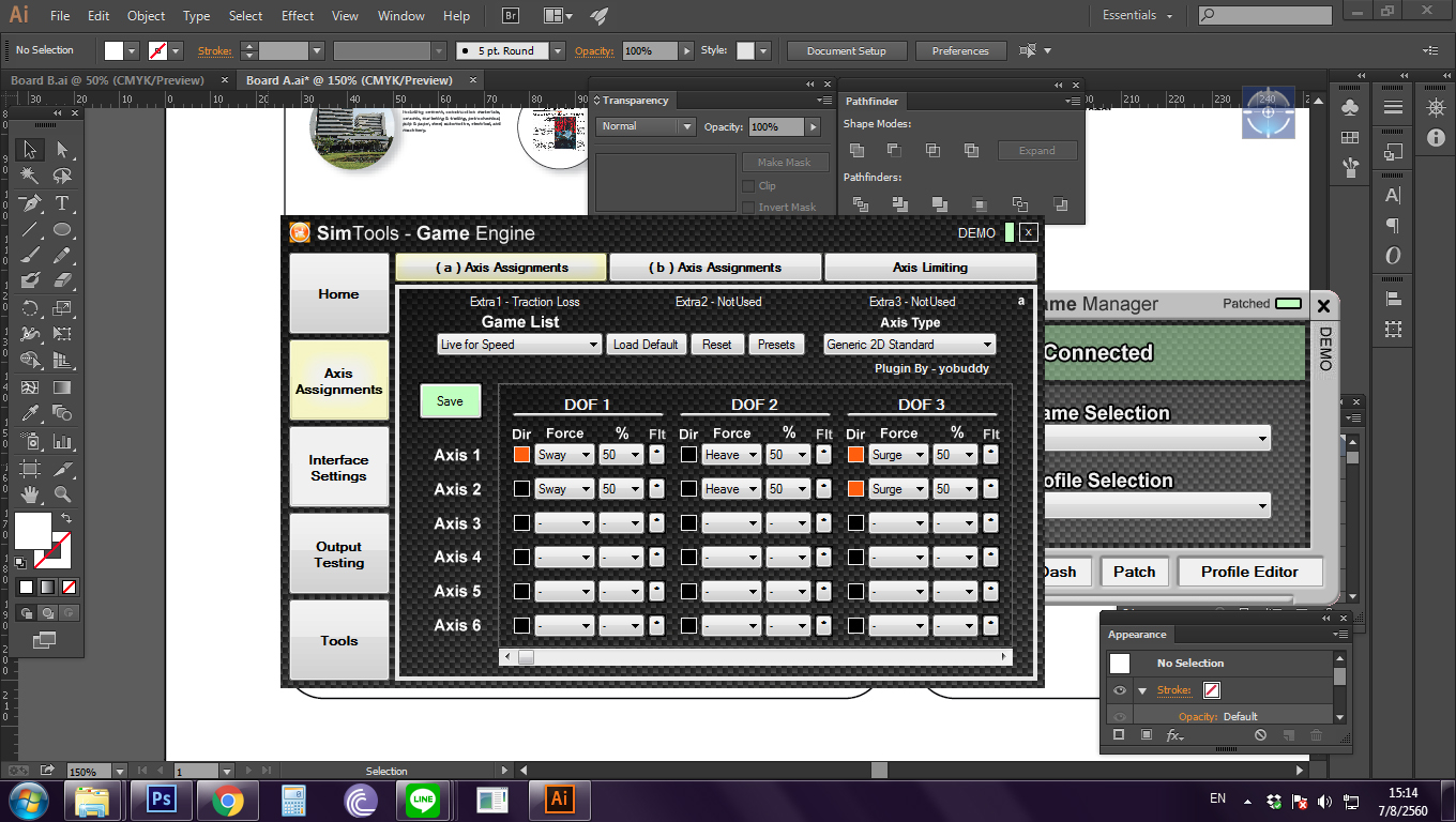

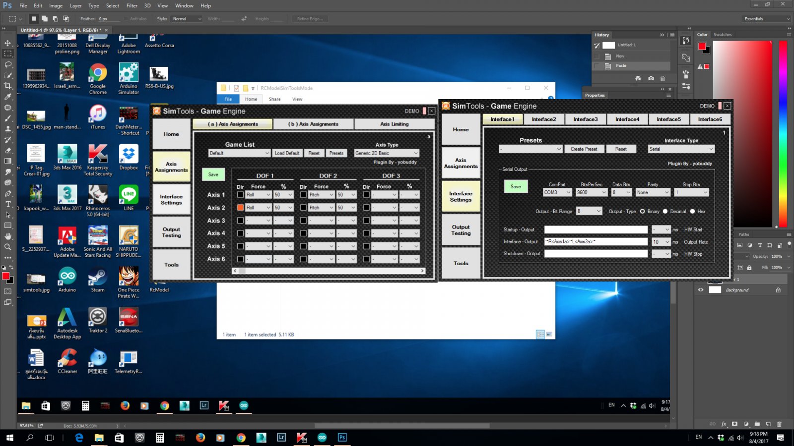

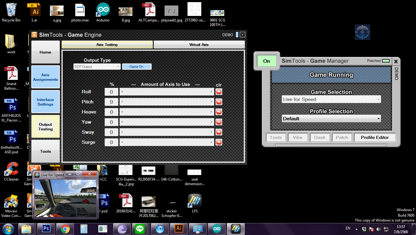

    I has a new question RC model is run in output testing mode but it not run on LFS Game.
      File size:
      627 KB
      Views:
      1,064
    22,215
    154,759Coins
    +11,213 / 57 / -2
    That could be a couple of different configuration issues.
    First, it is important the LFS is run for a lap or two in normal game mode before patching. If you did not do that then unpatch LFS, run a lap or two the re-patch.
    You also need to create and Axis Allocation, I am presuming you have done so hence can you please post picture of all of your settings.

    OK I reinstall and run 3 lap befor patching. It's work.
    Thank you.

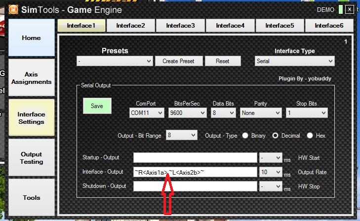

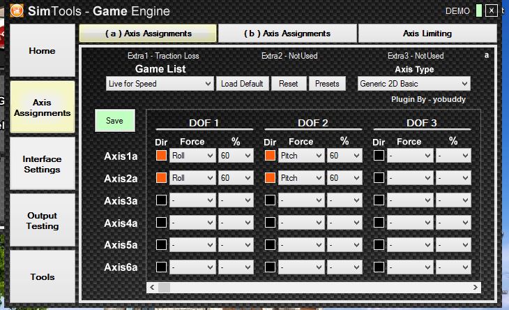

    100Coins

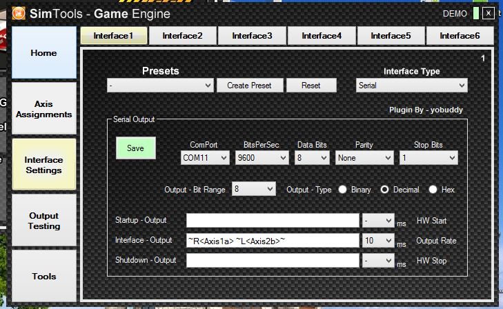

    i have configured the simtools 2 according to the settings given here ~R<Axis1a>~L<Axis2b> and Roll, Pitch to 60 but when i test the output on DOF then only one servo is making movement.

    @Taimur khan there looks to be an unwanted space in your Interface Settings:
  17. noorbeast

  19. Taimur khan
    Taimur khan New Member
    May 17, 2018
    Pakistan
    100Coins
    Thank you very much i guess the servo movement is now correct.

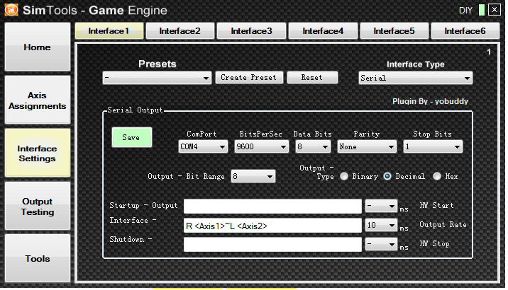

  20. lizwqd
    lizwqd New Member
    Jun 23, 2018
    Beijing
    52Coins
    我是新手,我已经购买了simtools和race07游戏插件,我使用RC_Sim_Model ino,并且正确接线,运行游戏,但我对电机没有任何反应,我不知道问题出在哪里是,请求帮助,谢谢
