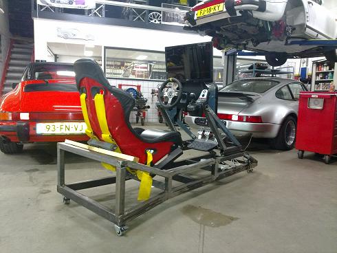

    Hi All,
    I started my Motionbase for the SCN5 actuators,
    First I started a pneumatic sim.. but I stoped with this project.. :roll: It was working fine.. but not realistic enough for my..
    I tested the sim from Nima (niels). 1 week ago... It's a very realistic feeling you have with the sim.... and i was sold :)
    Thanks Niels for your time and help!!
    I ordered 2 scn5 150mm from bernard... (SimXperience.com) Now I'am waiting :D
    I keep you posted..
    Thanks a lot for al the information on this forum!!

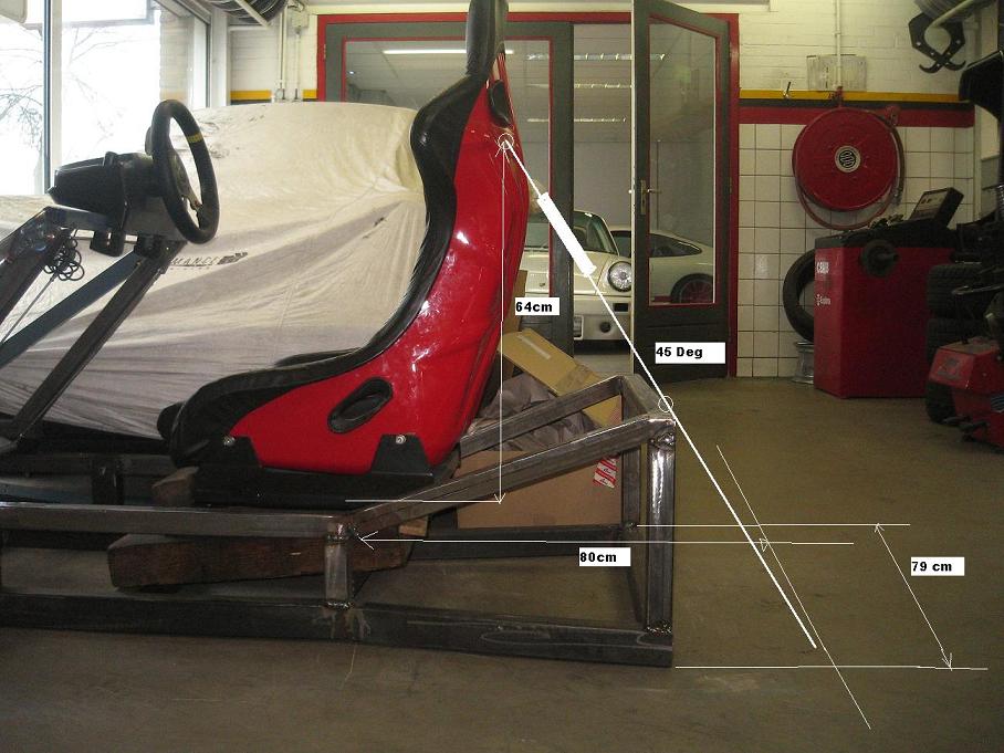

    This pic is for Niels.. he asked me on the phone how many degrees the scn5 stands..
    I have take the measurements form the drawing from the post 'building a proper....'

    hi ralph,
    you mast have 50 cm from under the seat to the top for the same seatmove
    were are have on my old sim with 100mm scn5

    Oke, also with a angle of 45 degrees and between the top unibolts 28.5 cm? (I will use the 150mm scn5!!)

    You demensions look good Ralph. I have about 58cm from the bottom of the seat to the top of the anchor point.

    this is right.between the top unibolts the best is you can use the way between
    18 cm and 30 cm.you mast make a holder for this.if you have lower size you have more way for acculation in a curve.

    I will lower the upper bar .. and make it adjustable..
    niels you are using the elastic straps.. Is that because you lower the actuator so much and on a very high angle?

    the elastic straps i have use a high angel and my weight is 110kg you have only 60 kg thats not a problem.

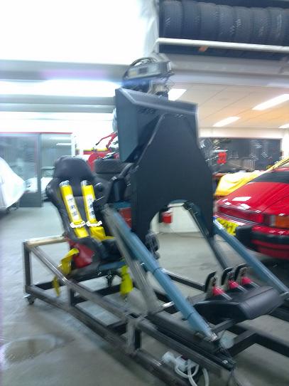

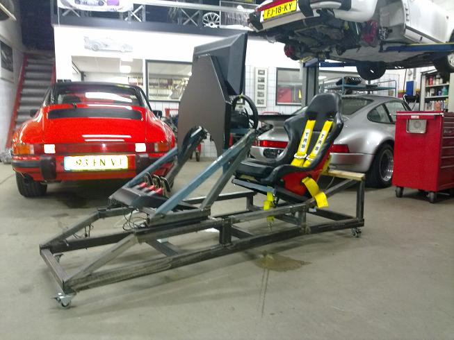

    Hi Guys..
    Here a some update pics...
    I Think this week my scn5 will delivered.. :D
    Put some 6 point seatbelt on.
    24 Full HD Screen..
    And some wheel to move the whole thing :happy:
    I think I will powdercoat the frame white and put some bordering of brushed aluminium on..
    and also a Logitech x540 surround set...
    Feel free to comment!! :cheers:

    Hi Ralph,
    • Cool design !
    • Cool seat !
    • Very cool and wide belts (originally I wanted to get the same in red) !
    But - PLEASE - hide these cars the next time you're taking photos... That's not fair ;D !
    I'm looking forward to seeing more pics :thbup: !!!

    Hi Ralph,
    Make sure you make provisions for some dampening in your design. The actuators are a lot quieter when you have dampening on them as the feel is also a lot more natural.
    ....Mike

    Thanks Mike.. I have already make the snc5 holder including the dampening..I'am able to replace them for softer or harder rubbers.. i read a lot and learning
