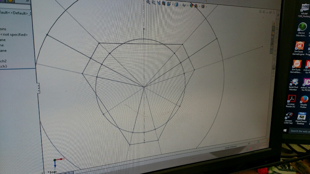

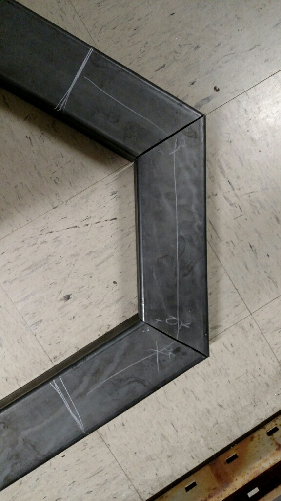

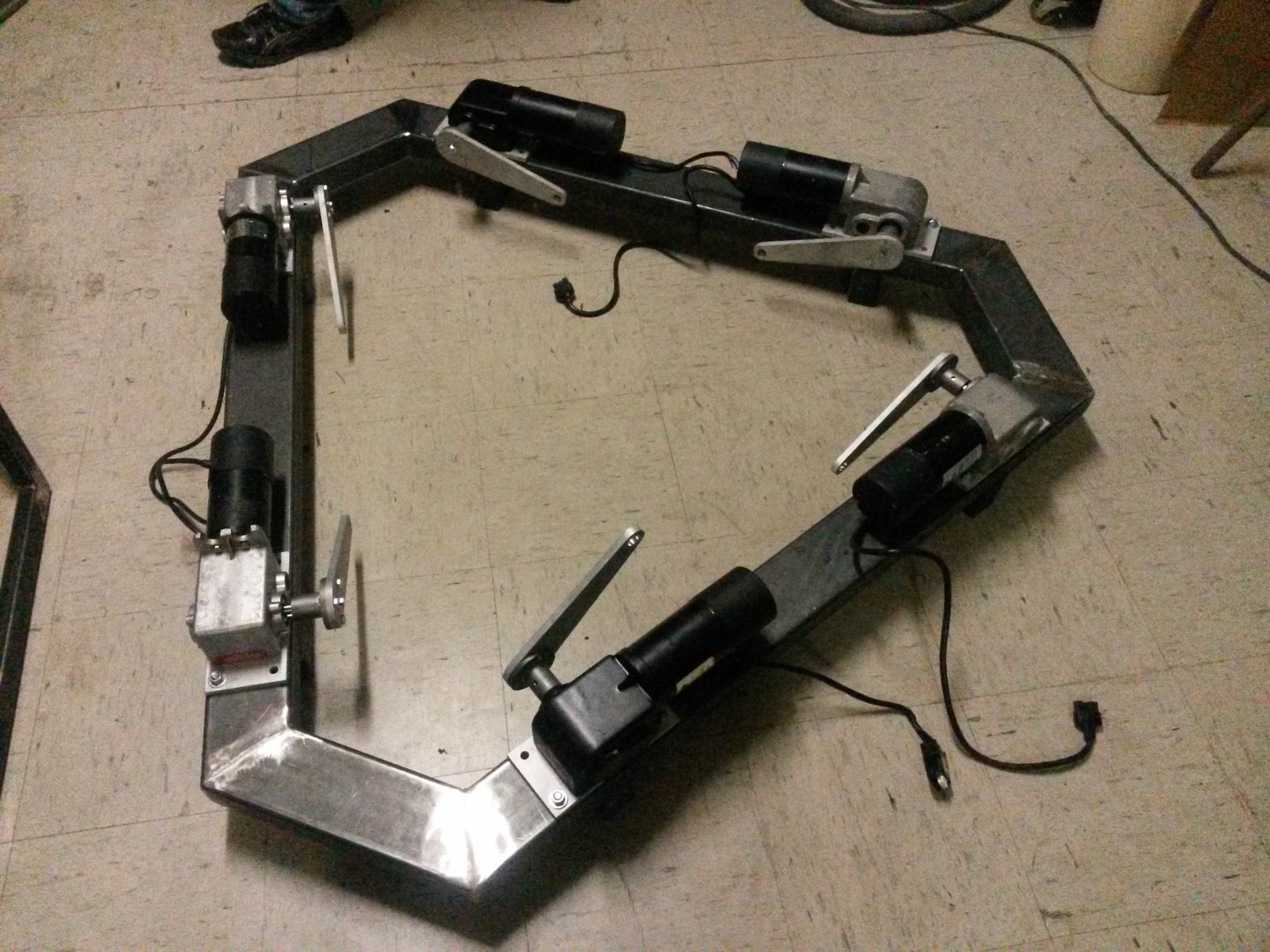

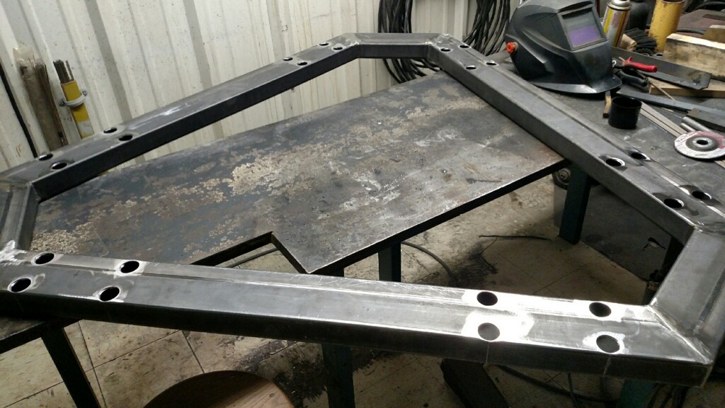

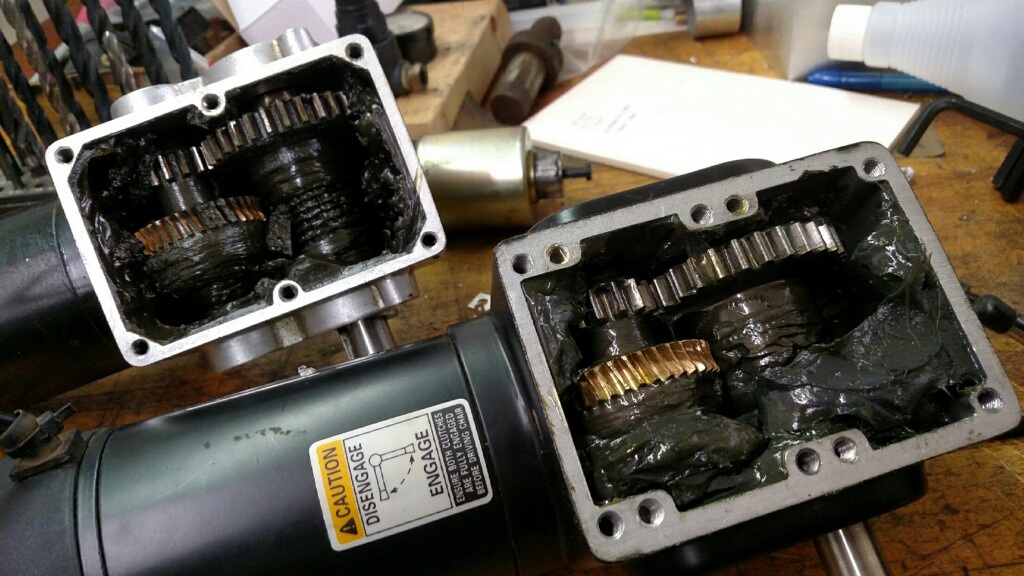

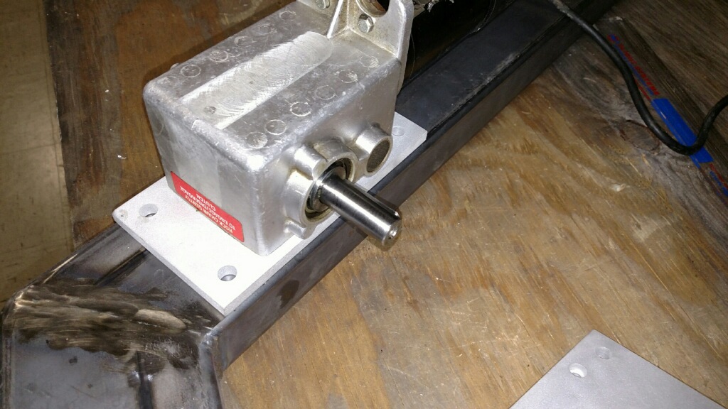

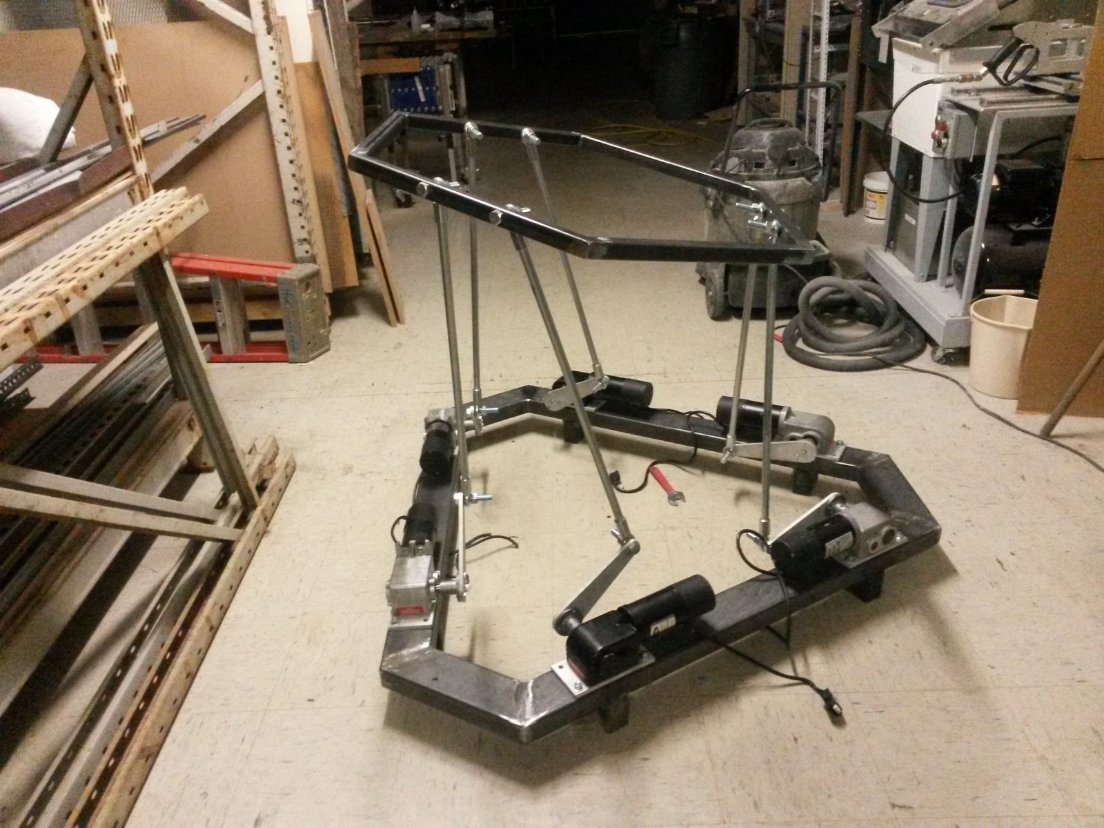

    So I did take some pictures of the build today. I'll have some pictures of the board as well once we have it connected! Motor mounts, arms, arm to motor bushings, connecting rods, bottom platform and top platform were all made from scratch.
    We have already decided on some major changes. Smaller top platform, and much shorter connecting rods. 2ft didn't seem so big on paper!
    Aligning joints before welding:
    Welded platform, drilled bottom holes for motor mounts:
    Wheelchair Motors and mounting plates
    A peek inside a 350watt people mover. All metal gears are what gives these the upper hand against wiper motors. With all of the weight being supported directly by the motors, they have to be ready to do some work.
    Planning and math stuff :)
    Motors mounted (today's work)
    Female heim joints, cut pieces of 5/8" all thread, and 1/2" conduit. This was done to save weight, but is going to be modified. If we take the connecting rods down to 1ft instead of 2ft, we should be able to get the same weight with just full all thread.
    Well, it moves....
    We are waiting on some parts still, including more cone spacers for the heim joints, and pots for the feedback (for now).
    Tom
  16. mariano68
    mariano68 Active Member
    Nov 15, 2014
    576
    builder contractor
    Argentina
    3,339Coins
    +395 / 2 / -0
    2DOF, Arduino, 4DOF
    Don't you think it's too high?
    Also the levers looks too long for 350watts motors maybe, but you would see it once in action.
  17. obobo
    obobo Active Member
    Nov 8, 2016
    248
    1,323Coins
    +77 / 1 / -0
    I thought about the same thing, I find that your rods are very long,
    For your cranks, you foresee what travel? + -15 °?
    Cranks are in what material? Aluminum or steel?
  18. SilentChill
    2,645
    20,592Coins
    +3,567 / 34 / -0
    Looking good @RaguTom lovely job :) and thanks for the pictures they do tell a thousand words ;)
    I'm not too sure about your lever length and your rod length and also the angle from the lever to the platform. Time will tell and you will know as soon as you get weight on it and motion :)
  19. RaguTom
    RaguTom Cool Guy, Chronic Long-Winded Poster Gold Contributor
    Jul 15, 2016
    54
    Electronics Engineering/Technician
    Harrisburg, PA, USA
    337Coins
    +99 / 1 / -0
    :) the rod lengths are way too long.... I'd be scared to get on that thing currently. Though if it was setup as a large scale flight simulator platform, it wouldn't matter too much. As far as the lever lengths, it will definitely be experimental. We were able to lift and support 40 pounds with a lever twice as long as that. If it is too long, we can drill holes a closer towards the shaft as necessary. From fully down to fully heaved, we have 13 inches of travel! lol!
    @obobo We allowed the cranks to physically have a 100 degree range of motion. Depending on what happens when this thing is utilized, that will be limited in software to what ever is necessary. The levers are made from 1/2" thick aluminum plate.
    @SilentChill Thanks!!! Its all an experiment for sure. I'd definitely love to hear some input on the angles. Common sense and visual appeal says the rods should go straight up to the platform, but that causes the two links to work in the same range of motion. i.e. if you sway, you cause the links on some arms to both move vertically, limiting the range. Mathematically and as shown in videos of professionally built units, the arms seem to come back on themselves at an angle. This allows one link on any arm to face one direction, and the other link on that same arm to face a different angle. With that setup, you would have a much higher range since one ball is moving vertically and the other ball rotating in it's bore, without a limit. I'd like to hear what people have to say about this. It could be all an illusion!! That being said, changing it to straight arms simply involves unbolting the top platform and rotating it one position. We figured we would eventually try both and see which works better.
