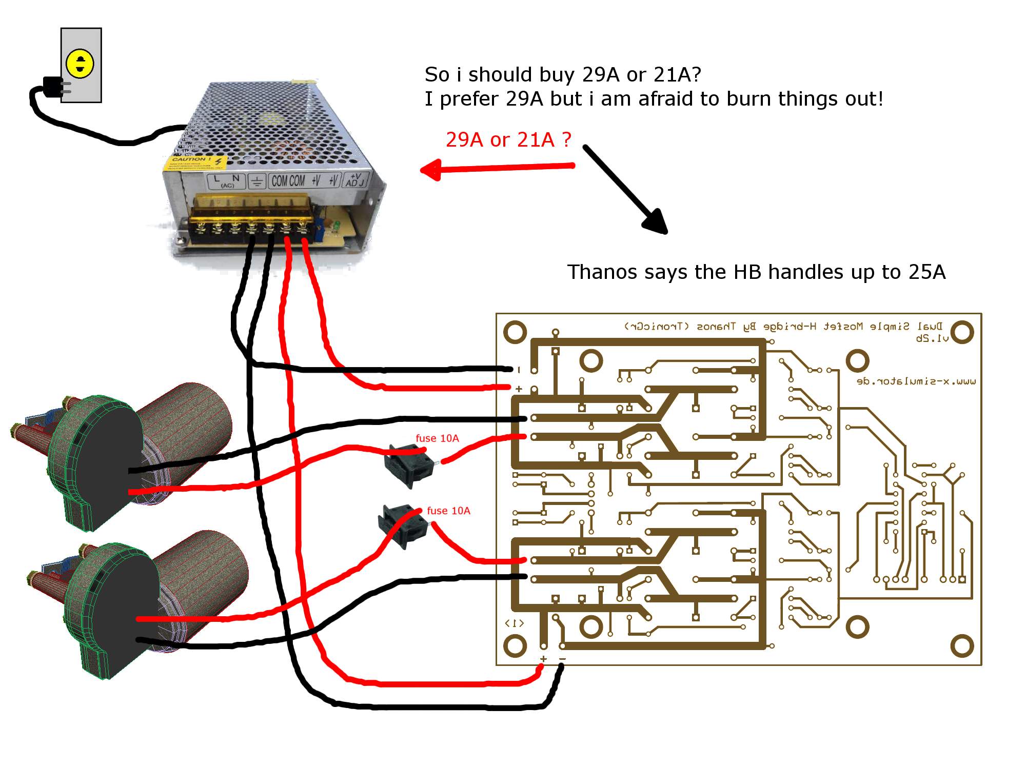

    I was reading the Tronicgr DSMhb1.2b manual and i came with a few doubts :?
    Thanos first says that DSMhb1.2b is designed to handle 12v, but can handle larger motors too(200W or 24v25A).
    Then in FAQ Thanos says that is a good idea to install 10 amp fuses per motor.
    Well, if possible, i want to give the motors all the current they can handle (up to 15A max each motor i think, maybe a little less).
    So how it will be with the 10 amp fuses (DSMhb1.2b FAQ)?
    Other question is about the power source. I would have to by two bateries with less than ten amp (lets say 7 amp)?
    So i will not be close to the 15 amp that I wanted to deliver to each wiper motors.

    About the 24V, I think that you need to use some other motor driver instead of Thanos's HB.
    Regarding PSU, the best way is to use big batteries (they can give you almost unlimited amounts of current but in this case it is wise to implement FUSES - start with 10A).
    I've seen people using all kind of PSUs, I'm using standard PC ATX PSU (actually two of them).

    About Power Supply!
    I dont want to use 24v motor, i refer to the 25 amps Thanos says that HB can handle.
    I want to deliver at least 10 amp to each motor (two 15 amp batteries) so it will burn the 10 amp fuse.
    And why you say to use other motor driver? Anyway I will have to stick (i think) with Thanos HB. I each it and it's almost done!

    Just use 10A fuses until you sort all other things, later you can put higher A fuses.
    Did you try and test your motors? They shouldn't draw more than 6-8A under load. How did you come up to 15A?
    I just wanted to say, if you are using high capacity batteries, be careful as they can supply large amounts of current.
    Opposite to car batteries, PSUs have internal protection circuits, so if motors draw too much current or block for some mechanical reason, this protection should kick in.

    So I am also looking for other kind of power source. There are a lot of specifications available to connect straight to the wall.
    29A $100,00.
    21A $64,00.
    10A $55,00.
    Which should I buy?
    Should I buy 2x 10A power sources?
    Because am wondering that if one motor is stopped maybe the power source would deliver to one motor all the 29A, and would burn it's 10A fuse. Is this correct?
    regards :thbup:

    21A... A few more amps doesn't justify the extra money for it. And most wiper motors don't draw more than 12 Amps and that only when they start from full stop! Normal operating amps are about 4 to 6 amps.

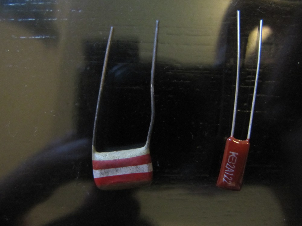

    Is something in common in this two capacitors ?
    For the AMC, can i use this ugly (bigger) capacitor instead of the small 122 ?
