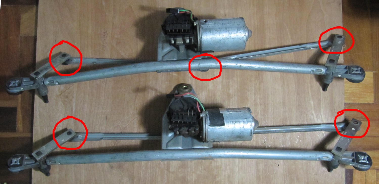

    Today i found these two motors and I bought them for about $37 each.
    I want to unmount the parts but the joints seem unseparable and i am afraid to broke them.
    Maybe it is what i have to do, break them!
    :cheers:

    I think that your engines are the same as I have, you have to remove the motor without arms
    [​IMG] [​IMG]
    Regards

    +19 / 1 / -0
    Hi Lopez,
    Yes I removed the arms and stuff.
    My wiper motors are exactly as yours but secondhand.
    :thbup:
