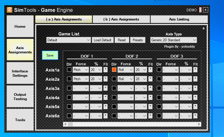

    Good day! made the settings according to your video tutorial. when I go to the Output Testbng tab and move the axes to +2, the motors turn sharply a quarter of a turn and that's it! No matter how much I pull the slider, there is no further movement. when I pull the slider to -, the motors do not move at all, they just twitch. Please tell me how to fix this

    Hello! I have a problem and I can't solve it, in smc3Utilis the motor works fine, and in SimTools only in + and then with a sharp movement, In - it doesn't move at all. Tell me where I'm doing wrong

    Can you please post pictures of all of your settings, as I can't see them clearly in the video.

    Please post pictures of all SimTools settings, as something is likely not configured properly.

    I didn't make any other settings

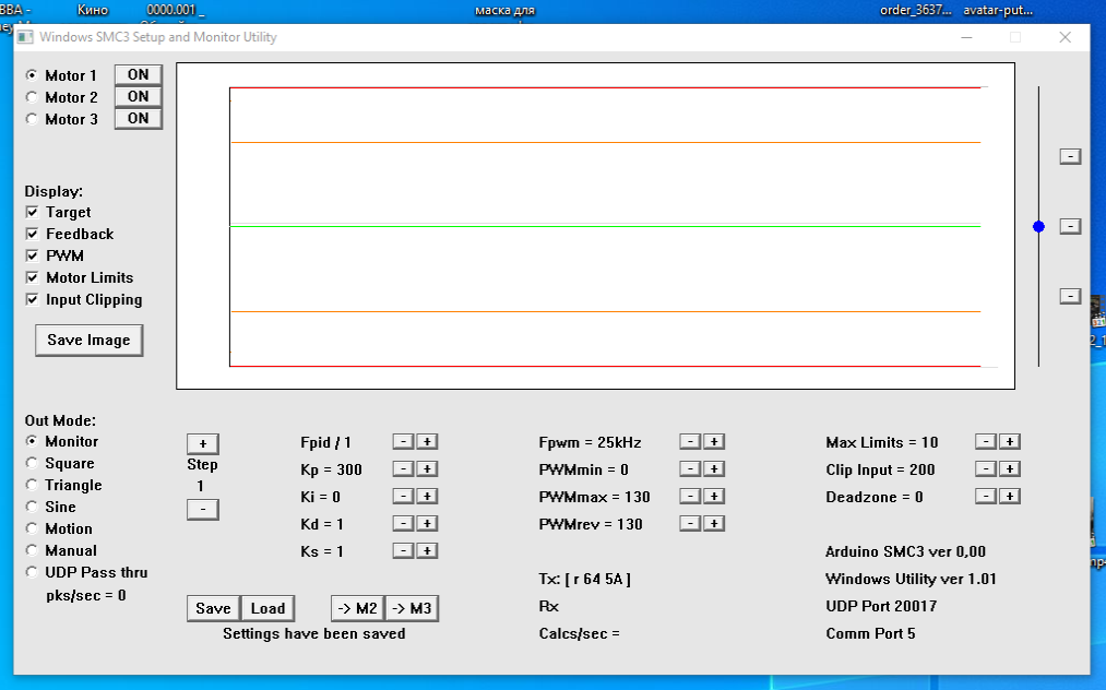

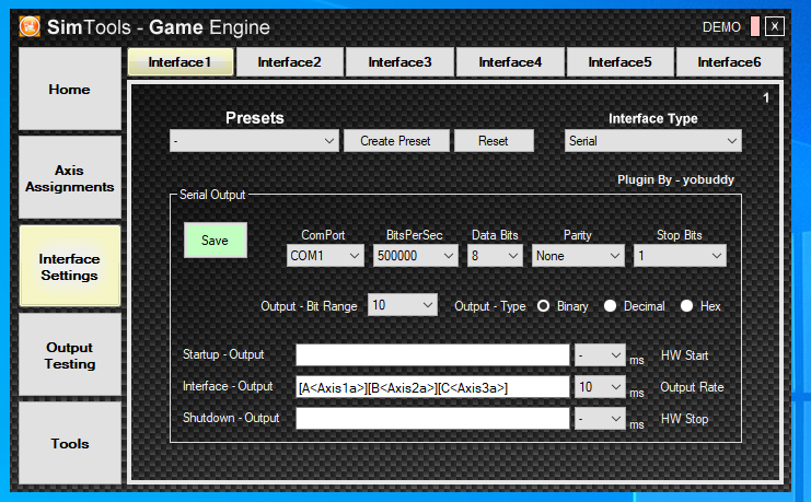

    It looks like SMC3 is set to com port 5, but SimTools is set to com port 1, they should match, so change SimTools Com to 5:

    Yes, I changed it when I rebuilt it. I have COM 5 there when COM1 motors don't work at all. I took the wrong screenshot, excuse me

    when I make settings in SMC3, are they saved to the arduino sketch? After all, to run simTools, you need to disable SMC3 because they cannot both join to the same port
  16. noorbeast
    20,555
    145,148Coins
    +10,780 / 52 / -2
    Yes the purpose of the SMC3 utility is to configure the settings, which are saved to the Arduino.
