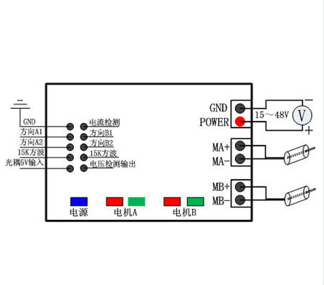

    hi bro, great build, i use 2x ibt-2 for one motor to give enough power, i ordered 1x 100a driver like you use, but i didnt found anywgere how to wire it could you help me how to wire it by diagram or some photo?
  10. Gadget999
    2,020
    12,331Coins
    +497 / 11 / -0
    you can see the wiring diagram attached
    basically 5v and gnd
    a1 / a2 - direction for M1
    b1 / b2 direction for M2
    pwm motor1
    pwm motor 2
