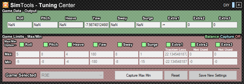

    Hello
    Today I had a race room update and since my Simulator no longer works.
    Here is what appears in the dialog window. Can you help me?
    22,185
    154,732Coins
    +11,194 / 57 / -2
    It looks like the update may have broken the plugin, you may need to wait until @value1 has some free time to have a look at it.
