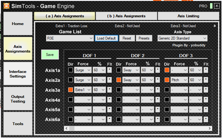

    I get strange movements out of my ProSimu T1000 3DOF with R3E. When the track is loaded and I am still in the menu it starts with movements like this:
    https://1drv.ms/v/s!AtieTsMZNoq_u8olEBdbONblUidmFQ
    When i switch into the car, just standing still its:
    https://1drv.ms/v/s!AtieTsMZNoq_u8omMAfUsh_-pOvyRw
    It feels a bit like the traction loss is reacting to roll and heave or something, but i get no proper pitch or heave when breaking or accelerating.
    My axis assignment (attached) is the standard one for the T1000 which works with pcars2 and assetto corsa. Looking forward on your thoughts!

    I can't watch the videos with my security settings, but it sounds like you need to properly refine your motion settings, in particular capturing then tweaking the Tuning Center values, see here for the steps involved: https://www.xsimulator.net/community/faq/steps-to-create-a-motion-profile.228/
    Being a commercial rig you should also post help questions in the proper commercial thread: : https://www.xsimulator.net/community/forums/simtools-pro-entertainment-version.176/

    I did the tuning and that definitively solved it. However, now I have another issue (of course :) ), which might be more plugin related: When shifting up while accelerating or shifting down under braking I get a bouncing surge interruption movement, that fades (like a ball bouncing on the floor). I have this with all cars. I also tried the same car in Assetto Corse where it feels right. It's this cut in surge when shifiting. Usually its just one interruption in the surge, but in R3E its a boucing and fading interruption.
