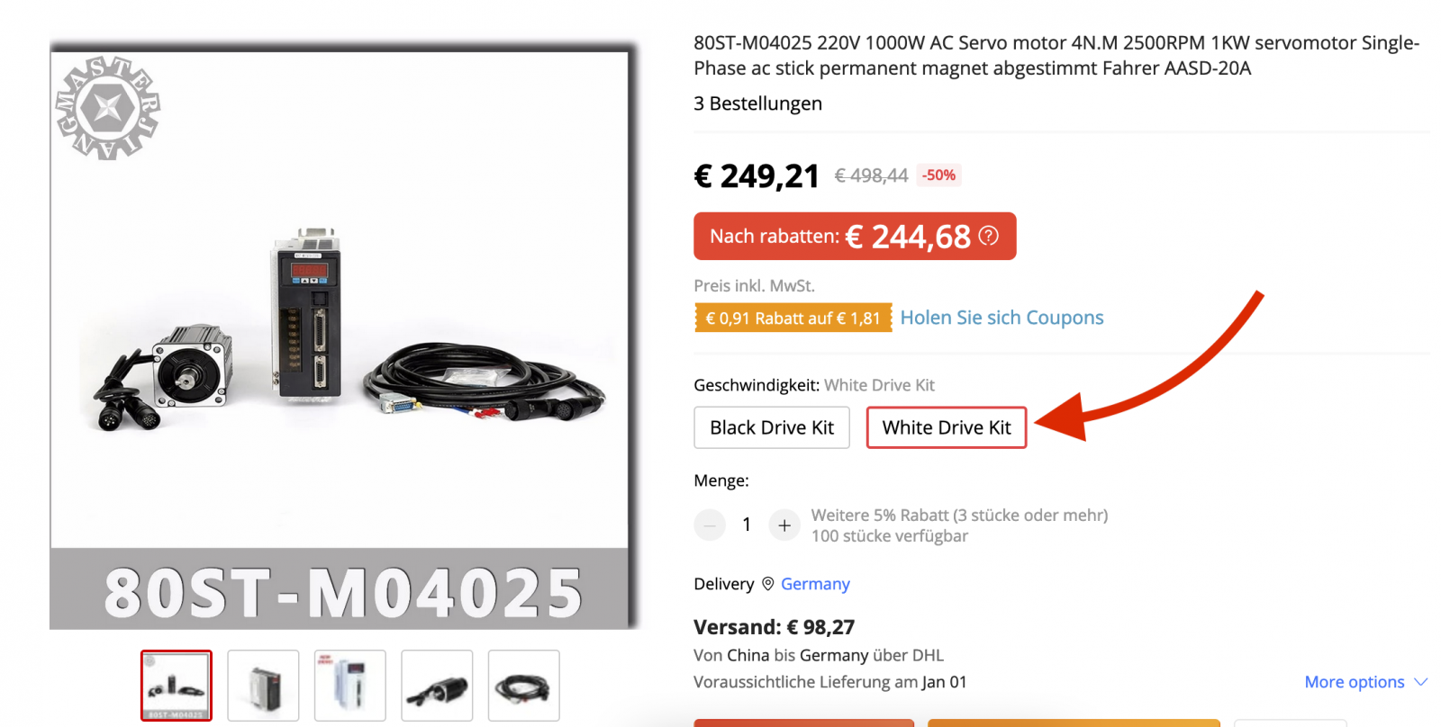

    I saw that some stores on AliExpress starting to have "Quiet Drives" as option for AASD servos. I checked a bunch, and it's not all of them, but this one for example has them:
    ...at least on their 80ST M04025 Servos. Link

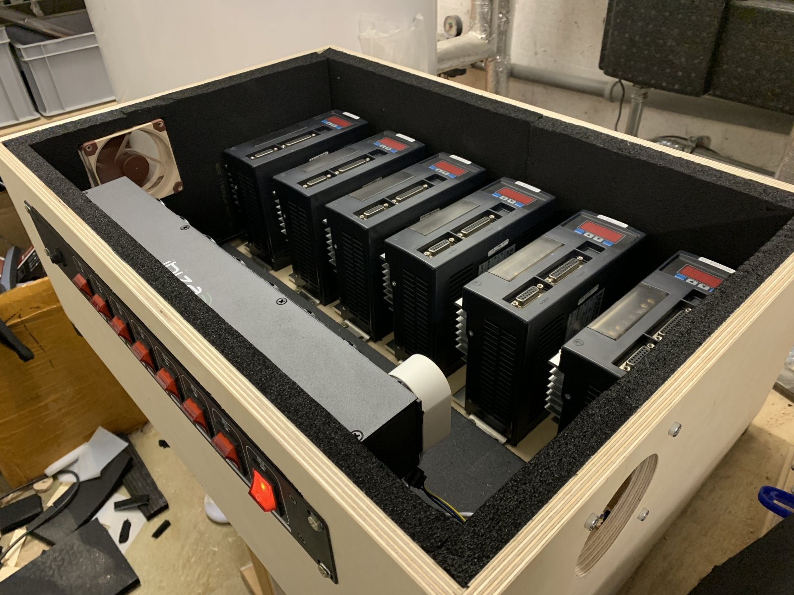

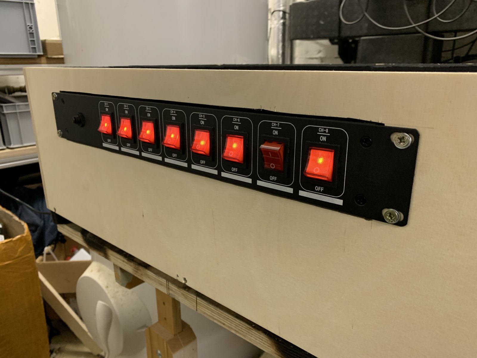

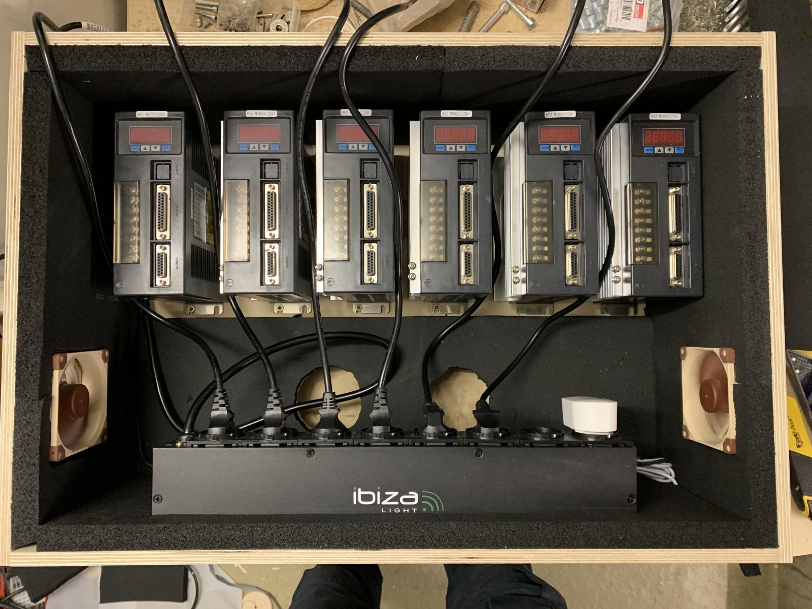

    For some reason they chose to make them in.... gupl.....white! ...but I put them in a box anyways.
    They're just a 10€ upgrade, which seems reasonable to me, given that I have spent much more on sound deadening material for my driver-box:

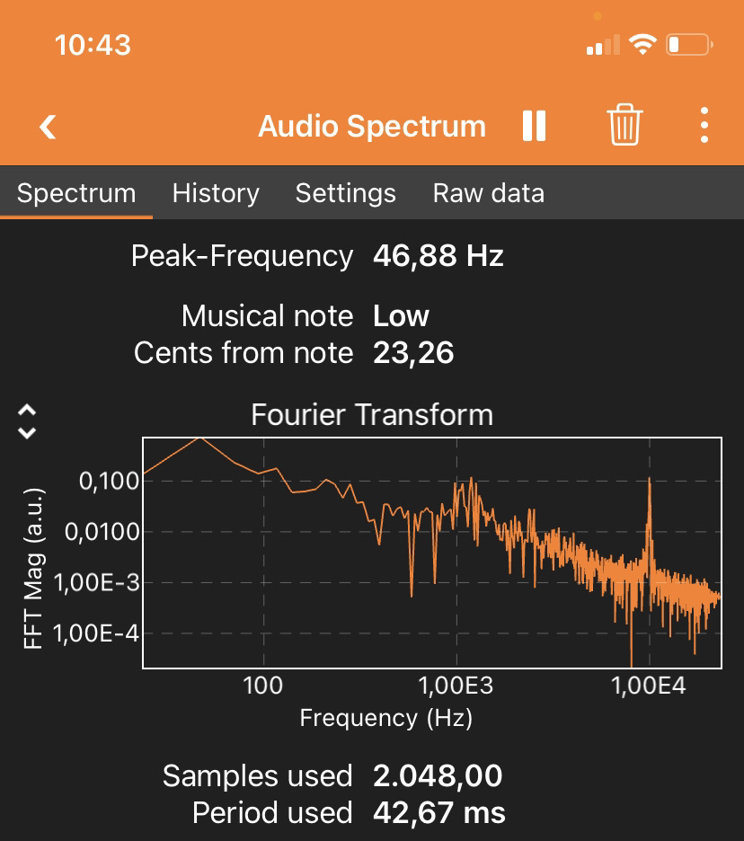

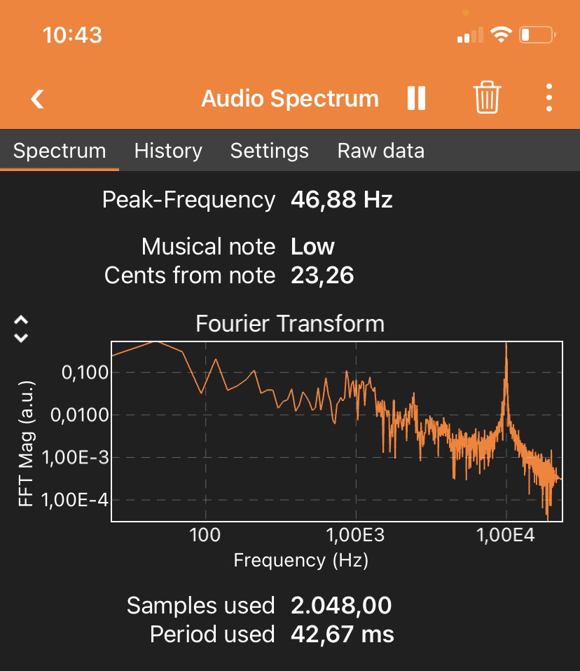

    Lid open:
    Lid closed:
    That's a reduction by an order of magnitude, but the 10KHz whining noise is still audible.
