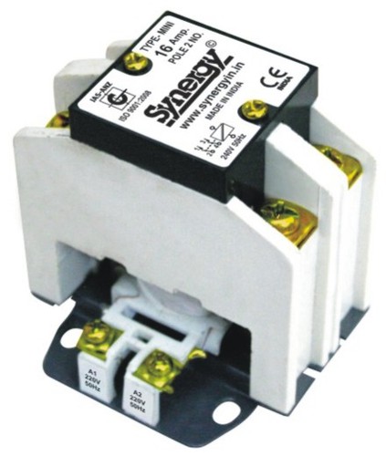

    • Emergency, Stop, Kill and Panic switches are the same just with different logo or name on it and are manually opened and closed "Human interfaced" so there must be no more than one in any machine so operation can be started/stopped at one place accurately ...
    If you intend to use one here in this simulator or any where else ... it is logically recommended to be placed to control the source of power for all MOTORS and VFD's ... and due to there low ability to handle big loads and current they can not be used alone to connect the main power ...
    That is a problem !!
    The solution is by adding an " Electrical Contactor " to them .
    Which is actually connects/disconnects the loads from the mains ... So one Emergency Switch plus one Electrical Contactor ... although it looks like a difficult/expensive thing to use which is not ... IT IS the best cheapest solution ... the next step is to know ...​

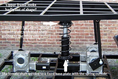

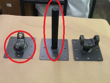

    • One thing further I want to check for ... is this male shaft should be welded to the back of this square plate and you should have the female shaft welded on the center plate instead like the Example ?

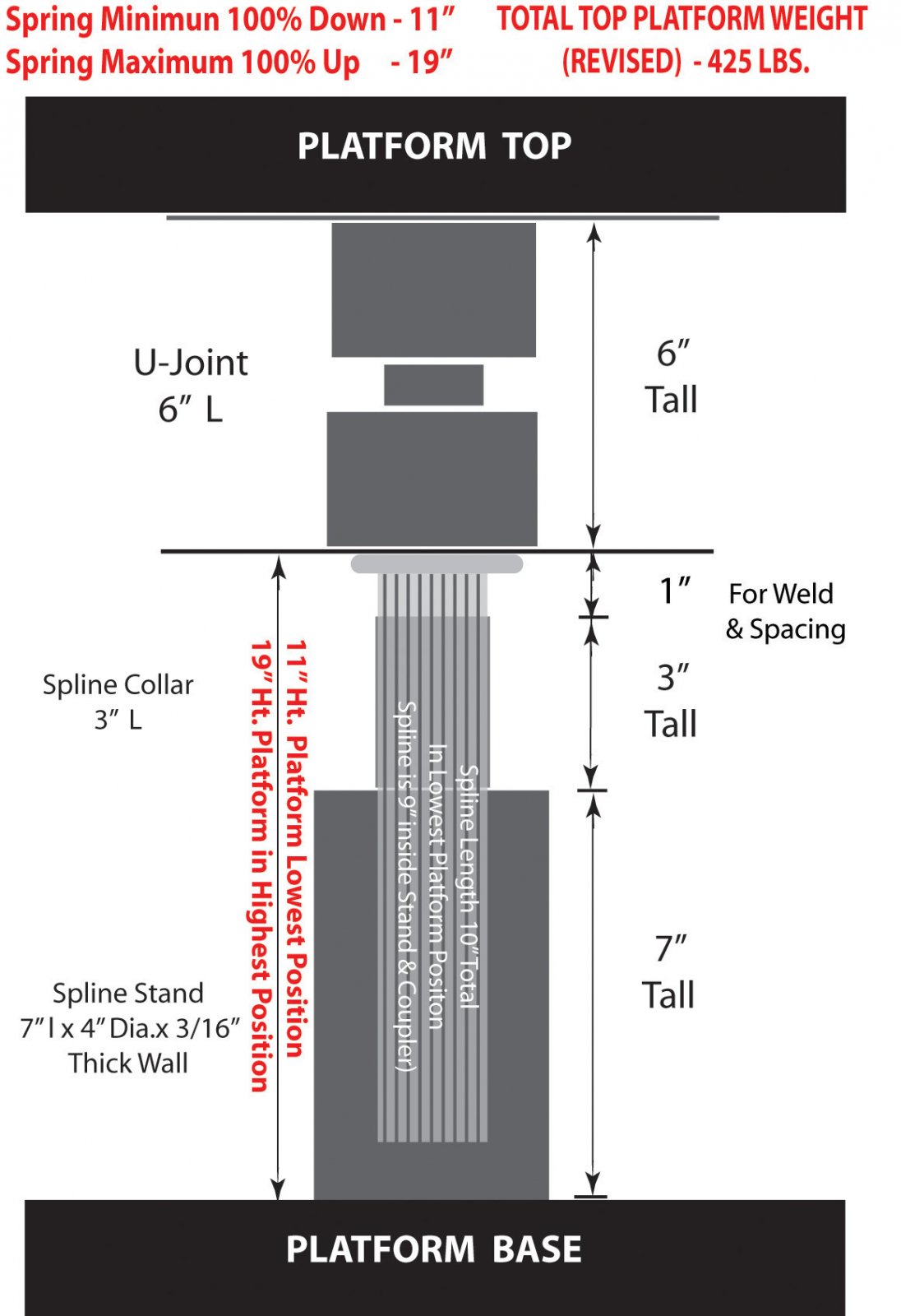

    PIPE & SPLINE - Spring Template Final 030214.jpg Hi friend Speedy,
    I will get back to answering your informative thread tonight. Still recovering from the ol' pneumonia and must go rest so I can think straight tonight.
    FYI - in US, when we refer to "rascal", it normally means it's an area or thing that gives us additional thought, or frustration etc. When "I" stated "rascal", it was referring to
    trying to figure out placement for stop switches being mounted at crank-arm....Hope this makes sense???
    Yes, the spline shaft in the photo is already welded to top plate - my spline "collar" will be welded to a 4" diameter pipe to act as a receptacle for spline shaft - it will be bolted to base frame. Compression
    spring sandwiched in between.

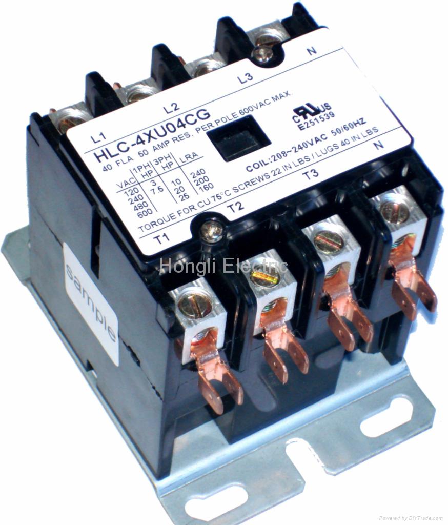

    OK - "humor" me here and tell me if I understand how to use a Kill Switch on top of platform - (at this time, I'm going to assume I am "NOT" going to use limit switches)
    1. Kill Switch on top of Platform, next to occupant.
    2. Contactor in my "electronics box" - 4 pole?? Single phase 230V - (Red/Black/White/Green)
    My "mains" power and 4 wires coming INTO electronics box, FIRST, goes to 1 side of Contactor
    The other side of Contactor - the 4 Wires go to my Bus Terminals (4 total) and from there I can wire my boards, power the VFD's, etc.
    3. Should I have an "out of control" platform, for whatever reason, I hit the "Kill Switch", it DE-energizes the Contactor, killing all power coming in - Platform stops.

    PS - I'm ordering my Custom Spring in the morning - Constant Pitch, Closed and Ground End, 1/2 to 1/3 Compression at bottom of travel. And I'll have them to Pre-Stress before shipping
    out. Total top platform weight - 425 lbs.

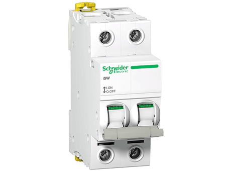

    No I'm not sleeping :grin... OK buddy "rascals" in Men language means the Fxx thing that keeps you thinking hard I got the meaning ...
    and you're definitely on track but to the other side ... not using a limit switch may cause you a full rotation for the POWERFUL crank arm without knowing what will happen then ? ... even if the Feed back hall effect pots will not be damaged ... are you sure nothing else will be in there way ? will the top platform with you sitting in it stand this rotation ?
    I don't know ... but the option is here and could be added in the future if needed .
    I still didn't come up with something that enables you to use one kill switch with 3 VFD's except for the power line which as you know will take 2seconds for a full stop ... as I still don't know till now the controllers type that you will use and the VFD types ...
    To use a kill switch for the power line of the VFD's ...
    mains power cable goes in the electronic box to this 40A main power Circuit Breaker switch ...
    then you need to hookup an extension outlet to connect computer and boards ... you don't need to shut down the computer instantly with an E-switch ...
    Then you just need a " two pole/220v coil contactor " for the 2 power lines ... connect additional two wires from the CB switch to the contactor IN side ...
    the Kill switch will be connected " in serial with the contactor side coil terminals " ... to the 220v IN contactor side coming from the main CB switch ...
    there are two types of contact points that comes with the kill switch only one should be used in connection ...
    when the button is pressed " the green colored contact point will be closed " & " the red colored contact point will be opened " ... I guess you want to press it to stop/disconnect the power then the RED contact point is what you'll use ... to cut the power from the Contactor coil then disconnects the VFD's from the main .

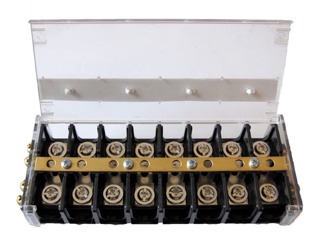

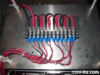

    the two lines of the OUT contactor side will go to bus terminal ... Use a terminal connector like this here for the VFD's to share the E-Stop controlled power source ... just bridge each 4 together to give you the required extension terminals needed ...

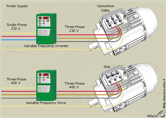

    then each VFD will provide a separate " 4 wires / 3phase cable " for each motor ... note that motors internal coils will be connected as delta ...

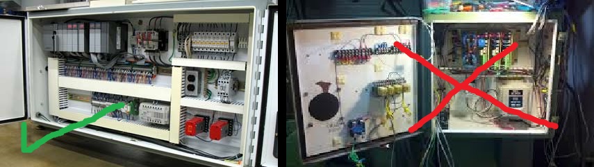

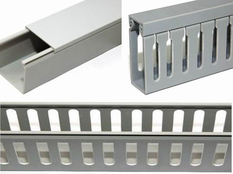

    use ducts to keep your work organized as much as possible ... design your space to leave room for ventilating the VFD's Fans as recommended in there manual ...

    see this ... miss placement of front motors / uneven arms distances ... makes an unwanted platform sway lift and right:(
