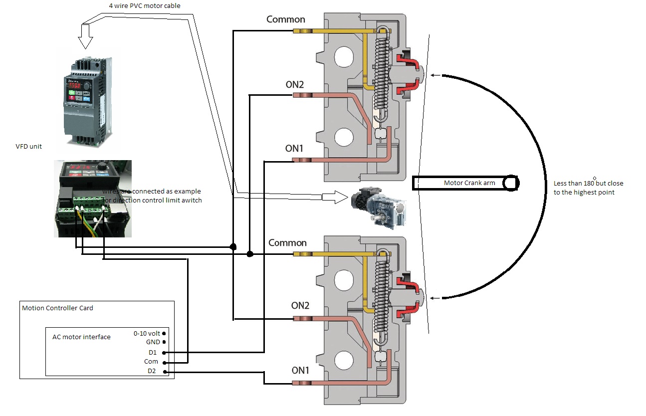

  18. speedy
    speedy Well-Known Member
    Feb 1, 2012
    1,193
    Alexandria , Egypt
    7,951Coins
    +1,288 / 10 / -0
    Long live all of you ... ;)
    I believe in that too ... I'm always asking God for his help and support ... So let me ask him for more [God help us all ] .
    back to topic ... I'm using a limit switch to put a maximum and minimum moving limits ... Since I'm using a VFD with AC motor like Tom will ... I want to add an important point :
    killing the power for the VFD will take about FULL ONE SECOND to STOP/STALL the motor ... due to the charged capacitors inside VFD ... that will not for fill an emergency stop ...
    Since I don't have an external control panel for the VFD to access the stop button ...
    I used the motor direction wires ... "2 wires "coming from the controller to make a reverse direction condition if the motor is OFF the working aria ... VFD can stop/reverse direction of motor in 0.02 second :thumbs ... that's a good thing for OFF limit emergency ... So if motor crank arm exceeds it's working area it is reversed by the VFD to motor speed and power ... I will make you a simple wiring diagram for that and post it ...
    Until we find some easy to use sketching program or any online at least 2D drawing tools ... please some one post a link here ... and to wait for a better weather ... lets take a year walking like turtles for a 10' target ...
    :popcorn

  20. speedy
    Feb 1, 2012
    1,193
    Alexandria , Egypt
    7,951Coins
    +1,288 / 10 / -0
    here with paint ...
