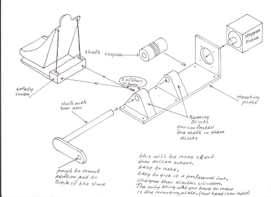

    Now my questions
    In my opinion to make a frex style simulator the best way is direct driven electronic jack style with stepper motors
    When i look at nanotec by stepper motors the st9818 series have more than doublle the force you need
    The only thing you have to do is take the wight from the motorshaft and that is easy to do with 2 bearingblocks
    put a shaft with a arm inn it line the motor up and couple them (no friction low mass slowness)this will last for ever
    I am thinking for a while now: what is wrong with it because ther is nothing wrong with the brains from the boys from this
    forum and they dont speak about it, and i can't find whats'wrong about it.
    Can some one tell me is this good or bad please a answer
    I read in this forum that if you work with steppermotors you have to program every posission will some one tell me
    how this works in big lines

    Could you make a little sketch please?
    Are you, by chance, familiar with CAD/CAE progs?
    Regards

    Hi: Cristian
    No i am not familiar with CAD/CAE progs.
    I spend some time on it, but i like to draw by hand.
    I hope you can open this, otherwise i will send it to you.
    When you see it, you now what i mean.
    I regret that your stepper project failled, but when you and the club likes this option,and start a new stepper
    project i will make and give the mounting plates.
    AD

    Well done, good idea.
    But this construction does not lock itself like wormgears or screws with low pitch.
    How much holding force (Nm) do the motors produce, which you are intended to use?
    Keep in mind that the lever increases the applied torque multiplied to the motor shaft backwards, in position holding situation, as well.
    UCP bearings would fit well to your construction I think.
    Regards
    Christian

    Hi. Cristian
    You are right the motor must stall,so do all the roller acuators when they hold.
    When i take a look at Nanotec steppermotors (st8918L4508 and st8918L6708)
    they have a holding torque from 933,4 Ncm that is more than 45kg on a 5cm arm.
    I think that's more than you need.
    Ad

    I did make a mistake the holding torque will be 19kg, with the steppermotors 8918.
  9. egoexpress
    egoexpress Active Member
    Dec 13, 2006
    3,839
    Germany - Frankfurt/M
    421Coins
    +10 / 1 / -0
    hmm, perhaps 19kg per actuator is a little weak to hold position or to prevent loosing steps (while taking place in the seat or standing up). As well in that case (19kg) additional feedback devices (Encoders etc) would have to be applied to calibrate the system.
    I wont say that I couldnt work, but seems to be too risky for me to invest money for expensive motors.
    But if someone would have a pair of matching ones, it would be worth a try.

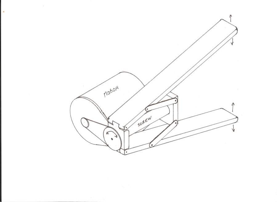

    I am working on a system to make your one cheape actuaters at home with hand tools,
    but there are some things i have solve first before i can post this.
    With this system every one can make there own, with the speed and travel and force they want, and they will lock
    of current.
    A little one you can make with 6 doorlits,and a metric screw.
    I will post a drawing later.
    regards AD

    Hi. Cristian.
    I did some thinking ,to make a roller actuator with stepper motor so cheape as possible.
    Without using machinery.
    I dit make a drawing for you,but i have made a little mistake with it.
    (The Thanos wheel on the monting plate must be fixt in line with the shaft,to avoid bending)
    You will understand when you see.
    The formula fore the motor is:F= E x M x 2 X pi : H
    F=force
    E=efficiency (From a trapped screw = 50% /rollerscrew = 90%)
    M=torque in Newton meters
    H= treath in meters
    So E=0,9 X M=0,2 x 2 x Pi=3,14159 : H=0,005 (whit shaft 16x5) F=226N =23kg lineal force
    This way you go from radial to lineal force.
    The formula fore acceleration i can,t remeber anymore.
    When you need 23kg vertical multiply M 2 times.
