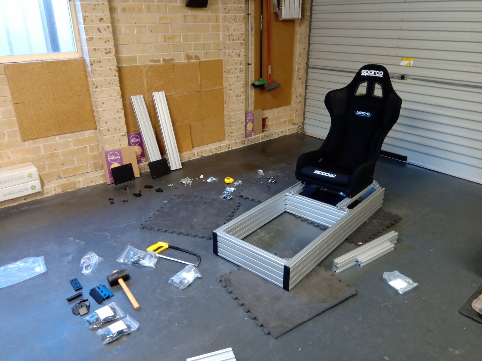

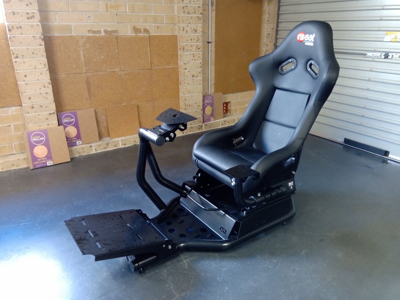

    The Simlab motion rig build begins!
    Out with the old....
    And in with the new.....

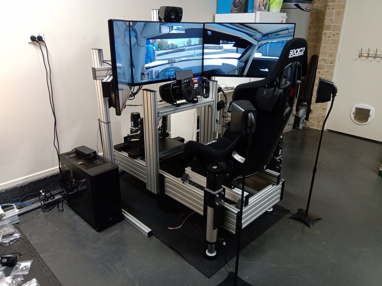

    Just a quick update that I've now got everything built and working. Just a few smaller things still to do like mounting the buttkickers, attaching seatbelt and also fitting the DD1 when it eventually arrives!
    The only major problem I had was related to EMI from the actuators. It was causing maasive problems with my pedals. The signal from the load cell brake was bouncing around all over the place (+/-20%) to the extent that it made cars impossible to drive. Eventually I discovered I had to run a ground wire from a metal bolt on the brake pedal to a ground pin on the pedal controller board. Doing that completely solved it. Sounds simple but took me days to figure out, trying all sorts of things and nothing was working!
    Haven't done too much driving yet, but initial impreaaiom is that I'm very impressed with PT actuator motion system. They are much quieter than I was expecting and also the road detail you can feel is fantastic. Also having just the 3 actuators is working out just fine and I'm glad I didn't go with 4 actuator kit.
