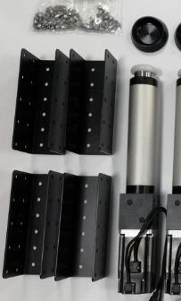

    I think the actuators come with U-shape mounts already... See:
    And here see how these mounts are used to attach the actuators:
    Ignore the base... this is for traction loss...

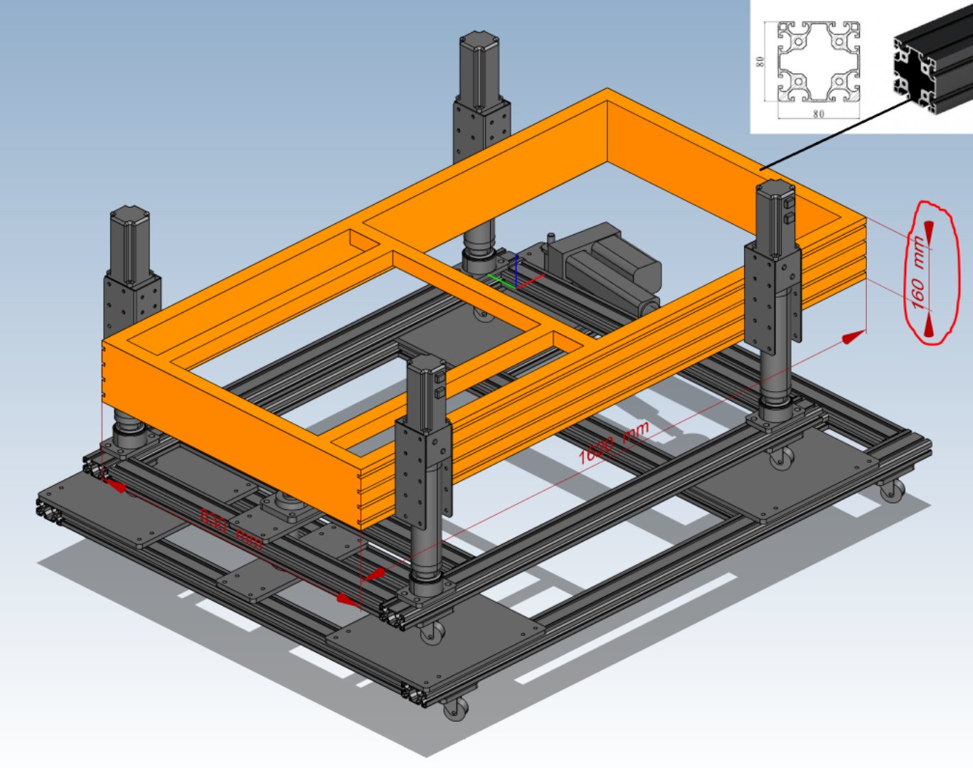

    2DOF, 3DOF
    Ideally I think 8020 160mm profile would be the best for mounting these actuators but I think 80 will also work too, found this setup online and I plan on pretty much doing the exact same thing with the GT1 evo rig.

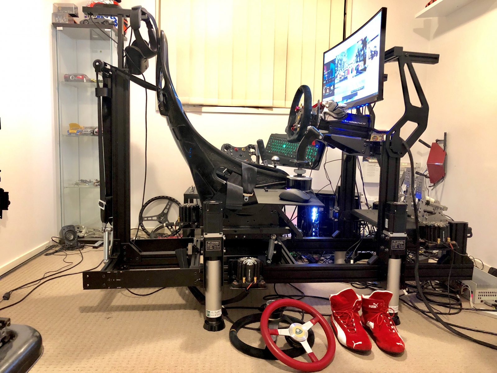

    I've been using my simlabs Evo with the monitor mount with 4 x actuators for nearly 2 months with no issues.

    Nice setup there!
    How do you find the combination of seat mover AND motion actuators? Does it make much difference vs. just having the motion actuators?
    Also the belt tension system, is that just working off the movement generated from the seat mover? Does it work well to simulate the braking forces? I'm looking to see if I can do something similar but I don't have seat mover only the motion actuators. I think for it to work I need to find a way to fix the belts to the actual floor.

    @ LukeBrown - Ive been using a seatmover for the past 6 years with a simxperience stage 3, so I really enjoyed being pushed into the steering wheel. Just the Putuo servos generating the pitch effect was not enough, I got motion sickness as my brain expected me to be pushed into the steering wheel when braking. The combination of seat mover and actuators is very good.
    Yes, the belt tension system is working off the movement generated from the seat mover. And yes it does work well to simulate the braking forces. Its also great at simulating g forces while flying in DCS.

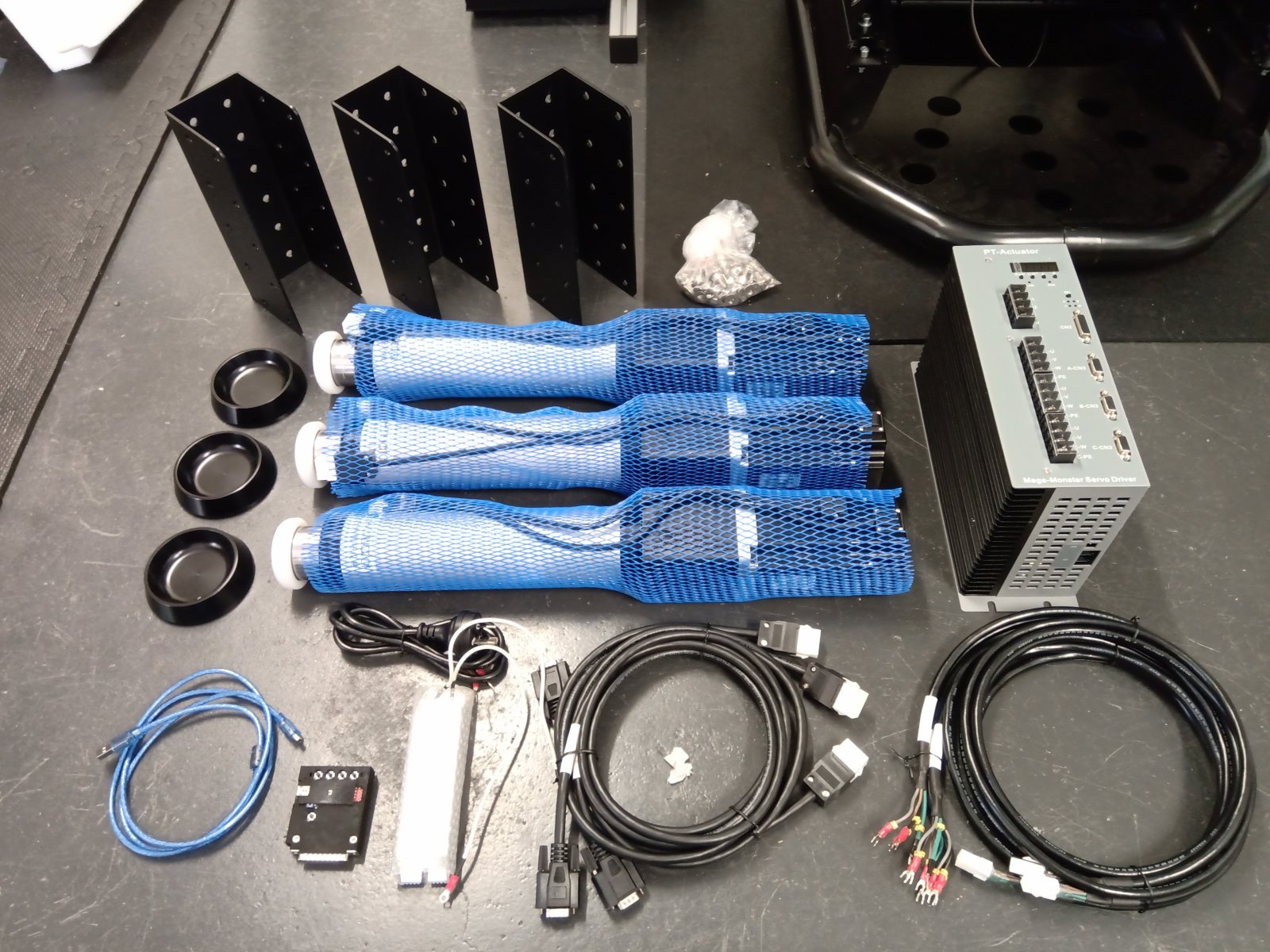

    IMG_20190728_144836.jpg It's arrived! Just a shame my SimLab chassis is still at least 3-4 weeks away.

    Video below of initial testing on a mock frame. This video just shows the standard up/down testing using the buttons on Thanos controller but I've also since tested it with Simtools and it all seems to be working correctly once I had figured out the correct axis assignments. I'm definitely impressed by the strength & speed of the actuators and also they are quieter than I had expected.
    The only thing I need to get some advice on is the grounding. I have a friend who is electrician so he will have a look at it for me later this week. It comes with an Australian 3 pin plug but the ground/earth wire is wrapped up and does not connect to anywhere on the MDBox. I think I need to connect this ground wire to an earth terminal on the MDbox and/or run an earth cable from a metal part of chassis to an earthed pole/pipe/socket somewhere in the room. If I stand on the floor and touch an actuator it's fine, but if I sit in my race seat (so my feet are off the floor and in contact with metal heel plate and pedals) and then I touch an actuator I can feel an electrical current/vibration. Not a shock as such, but enough not to be able to hold it for more than a few seconds.
