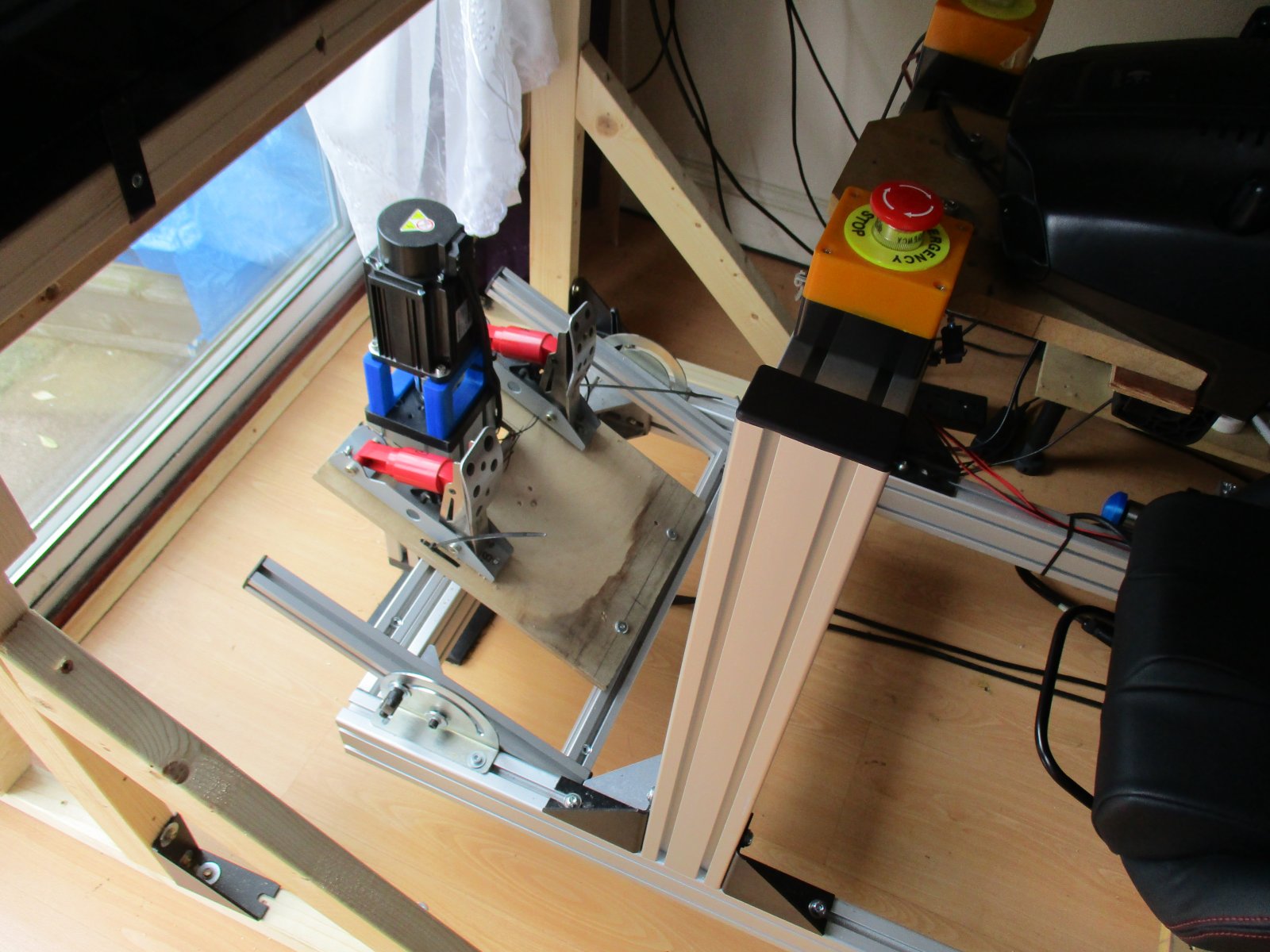

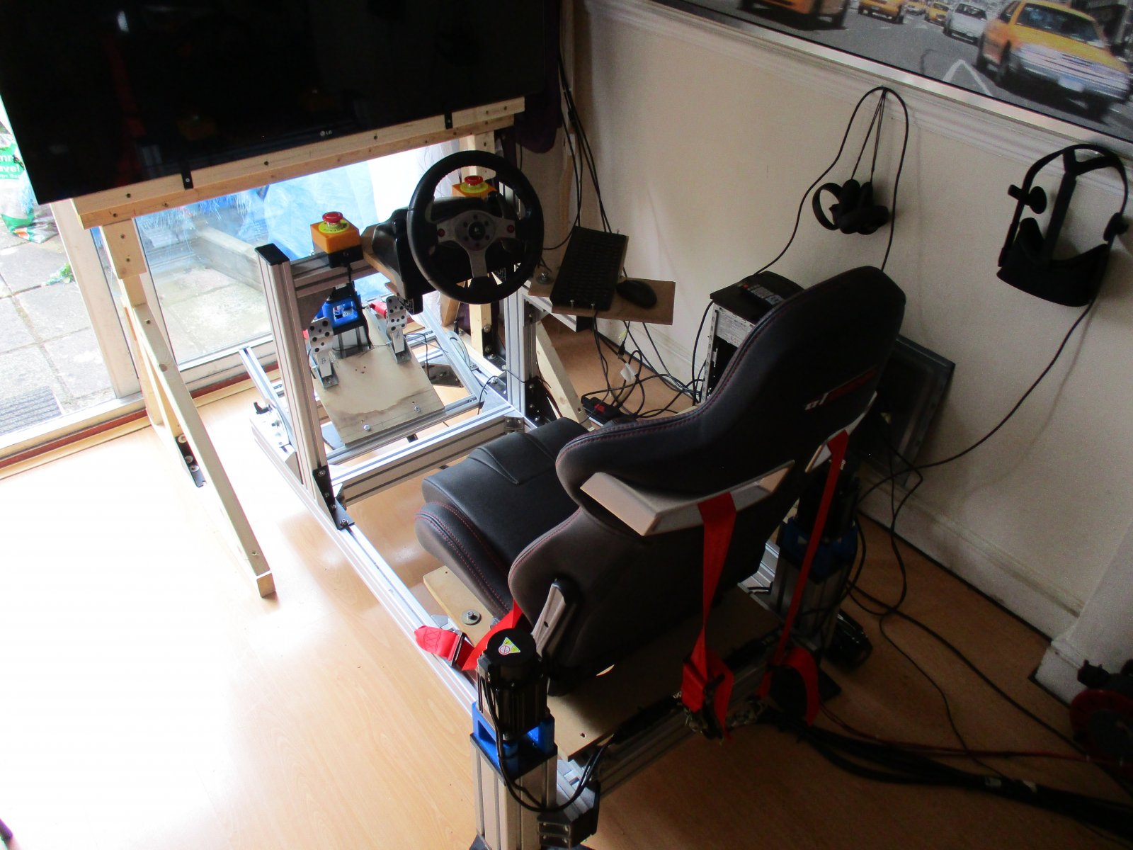

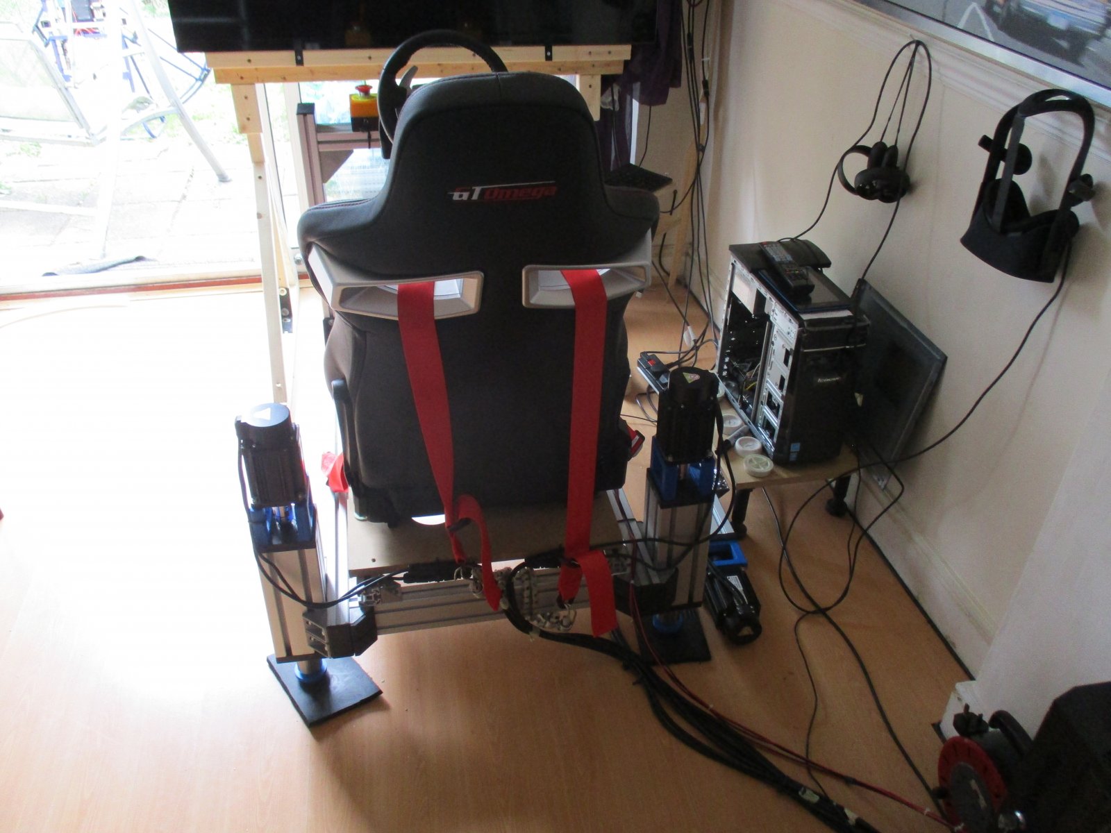

    Hi Guys Just for Info as im at early setup Reconfiguration stage , but was intregued by the line of thought ref 3 DOF vs 4DOF using MY SFX100 Style Actuators...i have now reconfigued the actuator layout form 4DOF to 3DOF ( 1 SFX100 at Front , 2 At Rear ) today will be used to sawp My FLYPT MOVER Rig to 3dof so watch this space .. wont hog your thread but thought my input might add something to the discusion ..
    So far using the Loop Tests in Mover i have dialed in the Correct Actuator assignments and everything seems Fine in terms of Movement Pitch /Roll/ Heave .. also ran PCars in auto pilot Mode and NO real concerns about mechanical operation Ref Speed and front mounted actuator Lifting ability.
    Still waiting for part For my DD FFB Build Based on @Peacemaker105 Build notes so that will be final element of Extra weight for fornt Loaded actuator.
    will post video clip of Auto Drven Race with My Lard arse in Seat to show Movement and speed , My actuator can reach 150mm total travel but dialed back to 130 for video .. Keep it coming guys this is all ggod stuff ..was going to use my Now Spare 4th actuator for Traction Los But thanks to you Guys i Now realsie Tipping is a Concern with this 3 Legged option ... We Keep learning form each otrher so this is all good stuff

    Hi @Blanes after much consideration i opted for 1 up front because of my large Rear end ( and im not talking Sim cockpit) swaping ? Movin Actauator was Not as bad due tothe flexibility of the Extrusion and fittings ( quite litraly Undo 4 Screws and Move Each actuator . Thats the Beauty of Aluminium Profile ..
    Cant drive for Toffe as thety say ( i Have aspirations though ) so for stay on the track and get some milage i generally Opt for Autopilot driver so a can check out the mechanics of the sim during Operation with Heavy Load on Board ( oh oh that'll be me then ) . Tuning whist using a Mouse when in cockpit is lets just say crazy LOL :)
    Just did Quick test video and can say at this early stage my fears as to wheter the sinlge actuator up front would be man enough were unfounded as she took a licking and just kept on Ticking ( Worked a charm and was abused but handled it well )
    The Trick will be in the Fine Tuning FlyPt Mover interface for optimum mech motion / Speed / Effects and glad to say things are looking good . Still at dialing in parameters stage but with each step im liking this 3DOF Setup for how its performs
