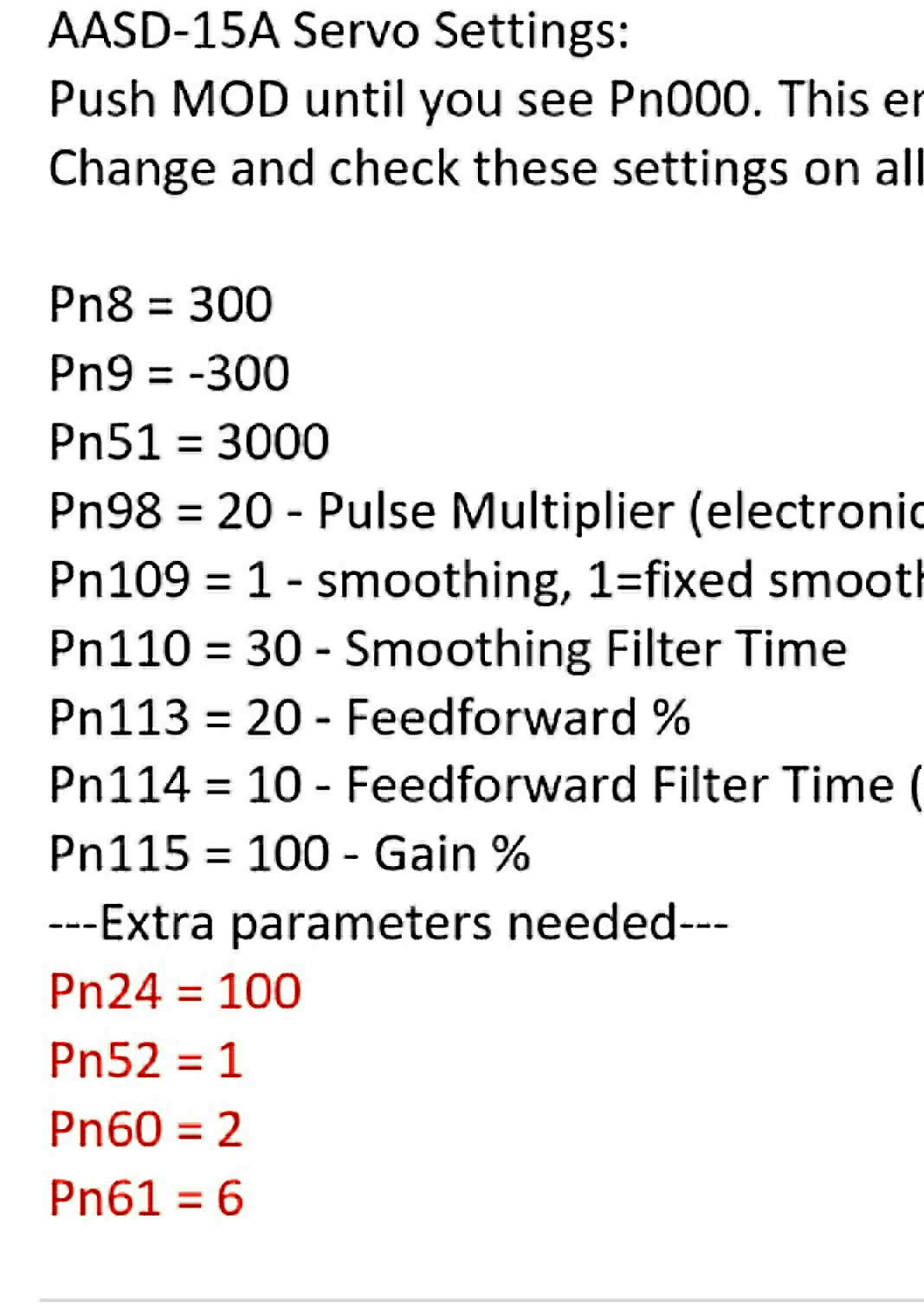

    Hi all new member here from Australia,just finally finishing up my Sim Build, and powered up yesterday the PT Actuator side of it to test,Ive gone through all the steps using Barry from Sim Racing Garage's how to on youtube plugged the Thanos controller in and the rig went into what I assume was a test mode,it all lifted the full height and the TL went to one side,but then the left rear actuator made a jolt and a AL-06 Code came up on its corresponding AASD-15A servo,found out its a overload 2 fault code, what would cause this is the servo or actuator stuffed,help.?

    Perhaps the max motor speed on your servo drives is not correct. Seen many times PT-ACTUATOR AASD-15A servos being shipped with Pn051=5000 (yes 5000 RPM).
    Just set Pn051=3000
    And perhaps do a check on the rest parameters as well:
    Thanos

    Hi Thanos thanks for your reply yes I have done these checks initially and have checked them since (all are on 3000) the problem as well,all were set to 5000 initially but I changed them to 3000 as suggested in your AMC instructions,it is strange that all the actuators will move in the function mode manually so no problem there its only once I plug the AMC controller in and it goes into test mode that it does this fault code on the left rear,maybe the Servo is faulty.?
