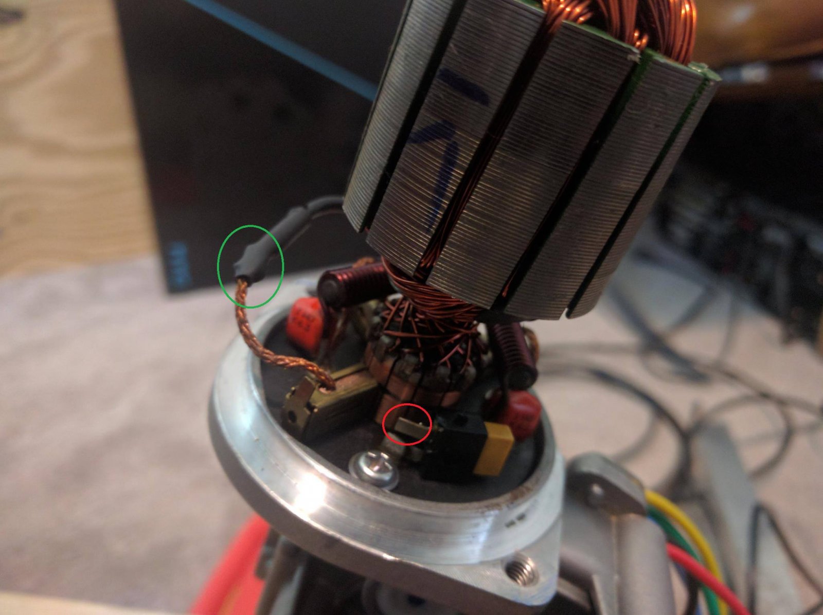

    Good point.... I might be going down a rabbit hole here, more info would probably be available if it were a common issue....
    I modified my wiper motor to ground isolate it, and in doing so bypassed a component that I read was an "overvoltage protector" (the one that has the red circle on it below). It's possible the removal of it is what is causing my issues. I haven't done this on the other motor but it was late last night when I was experiencing this problem and can't remember if I tested with it or not. I'm at work right now, I will try when I get home to see if this issue is happening on an unmodified motor. Once I have a result there, I will know which route to continue on.
