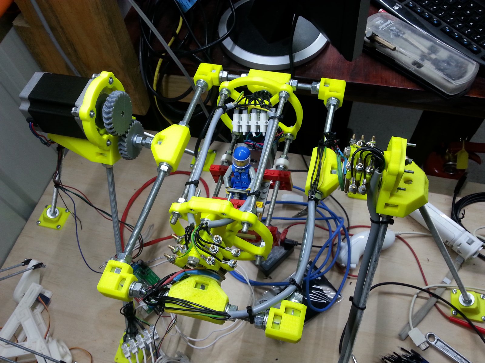

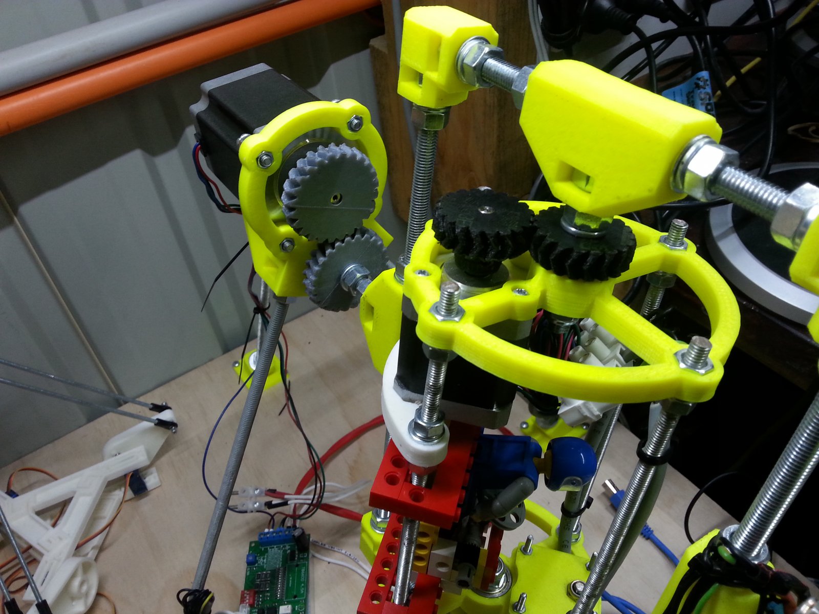

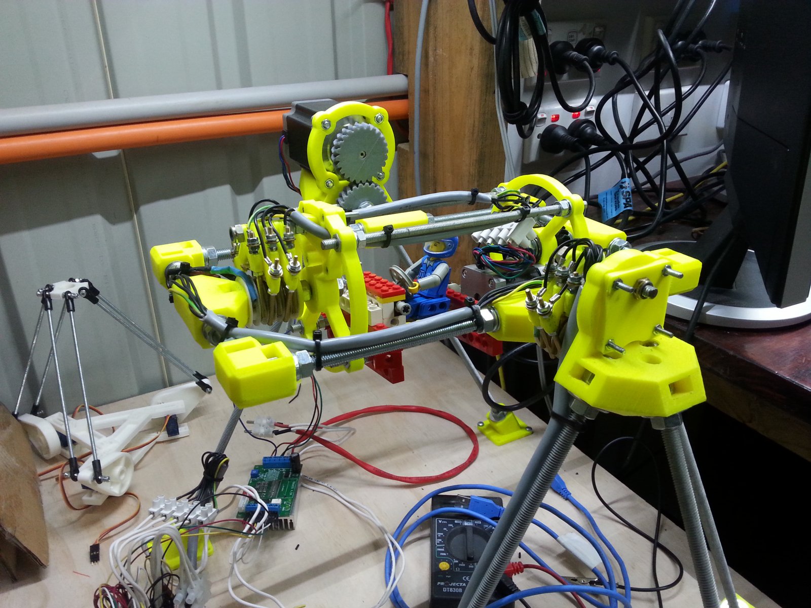

    Hi all, I hope I get this new thread thing right, I am a forum newbie. Plenty of reading but I never had anything worthwhile to add until now. I hope it works. Here is the start of my motion sim project.
    I hope to build more into it soon, but this was the first step. I would like my final version to have 5 DOF, which can be split up into 2 different rigs in one; a 3 DOF chair rig (which handles sway, heave and surge) built into a larger 2 DOF full rotational rig (pitch and roll).
    This is my first attempt at such a machine, and I know I am probably biting off more than I can chew, but I love a good challenge and I always dream big. That is why I am starting off with a small prototype first, to test design ideas and develop control logic.
    The rotational prototype I am displaying here is what I have completed so far, and the chair prototype is mostly drafted up.
    All of the non mechanical parts were designed and 3D printed in my shed. The motors are both steppers (easier for me to control and write code for) driven by 1/16th stepper drivers. The roll motor on the inside is a Nema 17 47N.cm and the pitch motor is a Nema 23 185N.cm. Both are controlled by an Arduino Uno. I tried to learn how to use the accel.stepper code, but my codefu is quite weak, so I wrote my own. It works Ok, but it could be better. No fancy PID or anything.
    At the moment the code accepts a string from the PC which indicates a desired position for each axis. The Arduino then decides which direction is the shortest (Clockwise or Counter-clockwise) and then calculates an acceleration - cruise - deceleration path to the set point.
    Power is transferred to the inner gimbal by way of hand made slip rings. These were by far the hardest part to design. If anyone is interested I can share more details/designs.
    So far to control it I have been sending strings of data by hand (via the serial monitor in the Arduino IDE) and have yet to integrate it into the awesome software you guys have made. All in good time. The video I have uploaded was done with a camera in one hand, and typing into the console with the other. Pretty crude I know but it does the job.
    So far I don't have very many specs for the full scale sim as far as hardware goes, but I'm working all that out as I go. Nothing will be purchased until I am confident that what I am getting will both work as intended and and be cost effective. Until then there is no harm in playing around. I intend to use this with all sorts of flight and space based simulators. I am not really into racing, but then again I haven't really tried too many titles.

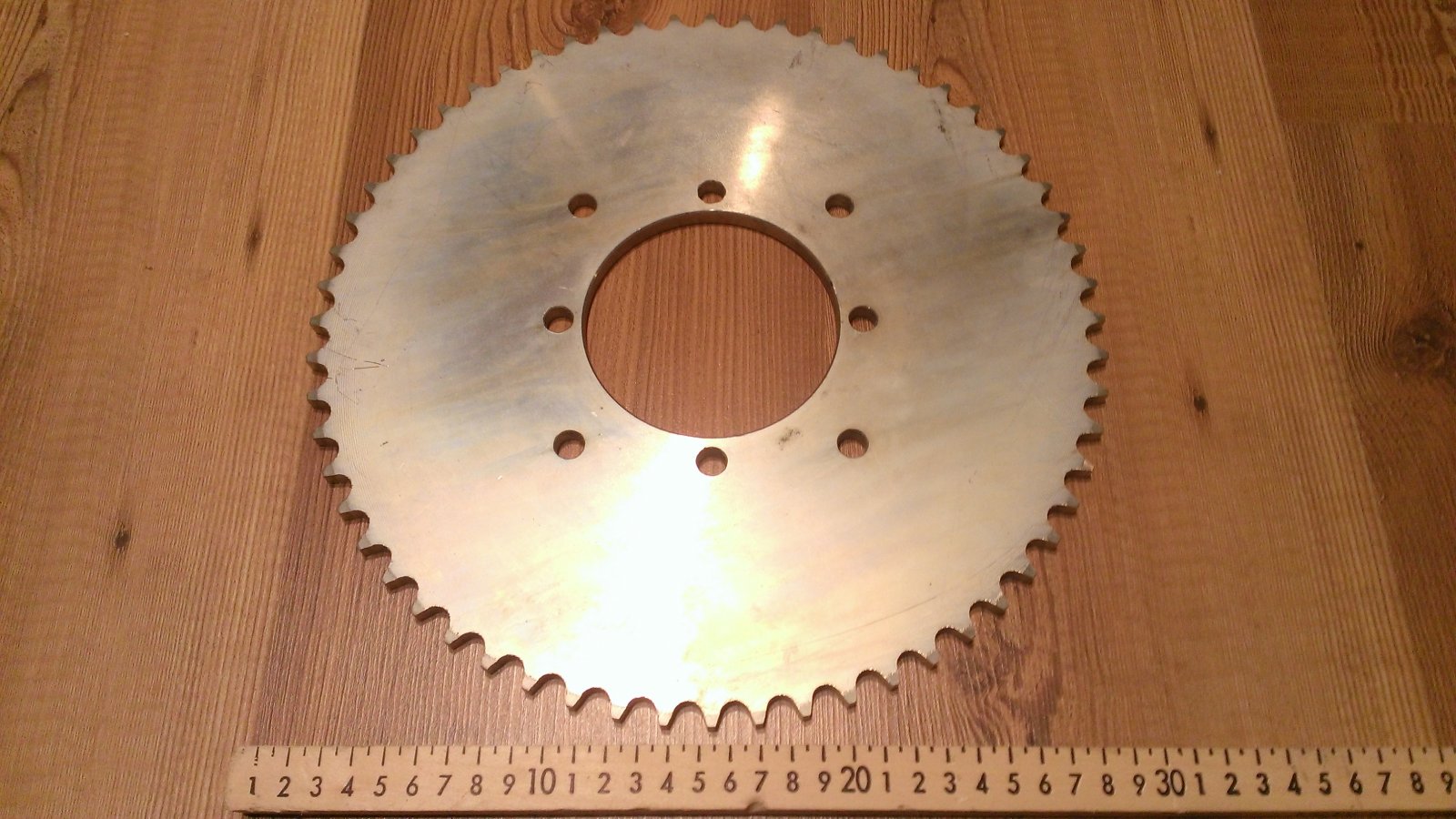

    While I may have over designed, I purchased two 24vdc motors, a 1.3hp 3600rpm motor for roll, and a ¾hp 1800rpm motor for pitch. The roll motor would be attached to a 25:1 reduction gearbox and the pitch to a 60:1. I determined that I would need around 30 rpm max for roll and 8 for pitch if I recall correctly. Therefore, for final reduction, I planed on using a chain drive between my gearboxes and a large drive sprocket, one on the roll cage, and the second on the pitch frame. The drive sprockets I purchased where 60 tooth with a 100mm hole in the center. They have 8 boltholes around the perimeter of the inner hole for attachment to the frame and the large hole thru the center allows for passage of a slip ring and axle. In fact, here is a picture of one.
    Then, I would use smaller sprockets on the gearboxes to achieve the proper final reduction for roll and pitch.

    No, I didn’t. Besides not being a welder, after much thought, I decided I must have heave also. Unfortunately, this design is not heave friendly. This is what I ended up building instead.
    However, I no longer use this simulator. It was designed for flight but I modified it to be faster for race as in the video. But for race, you really don’t need to move the monitors, so I built an even faster simulator for race that uses detached triple 61 inch screens atm. One day I may un-modify my old simulator for flight again. It still works as is but is not as smooth of movement as it once was due to faster gear ratios used for race.
    Not yet. I thought about selling some of it but I’m a pack rat and hate to give stuff up because I still could have a use for it some day.
    Well, at the time, I didn’t know anything about controlling ac motors with VFD’s and brushed dc motors are quite easy to control. And I scored a couple of new/old stock 24vdc motors as well as some gearboxes on ebay for a reasonable price too. Those large drive sprockets cost me $90 a piece though but that’s partially due to the fact they are new and made from stainless steel (original use for them was in a poultry processing machine). Also, I’m not keen on the idea of using high voltage ac for a project like this myself. We only have 230vac standard here for household use but +400? It appears you know what your doing with electricity but still, it could be deadly! You may want to consider putting your VFD’s etc. on the outside instead of the inside for safety reasons.
    I’m not an expert on chain drive systems but since the large drive sprockets I purchased were size 35 that was what I was going to use. That’s probably beefier than necessary though. The reduction ratio is easy to figure; # of teeth on large sprocket : # of teeth on small sprocket. For example, my roll motor is 3600rpm / 25:1 gearbox or 144 rpm. To reduce it to 30 rpm maximum I need a final chain drive reduction of 144 / 30 = 4.8:1. So with my 60 tooth large sprocket I would need a 60 / 4.8 = 12 or 13 tooth small sprocket to put on my gearboxes output shaft.
