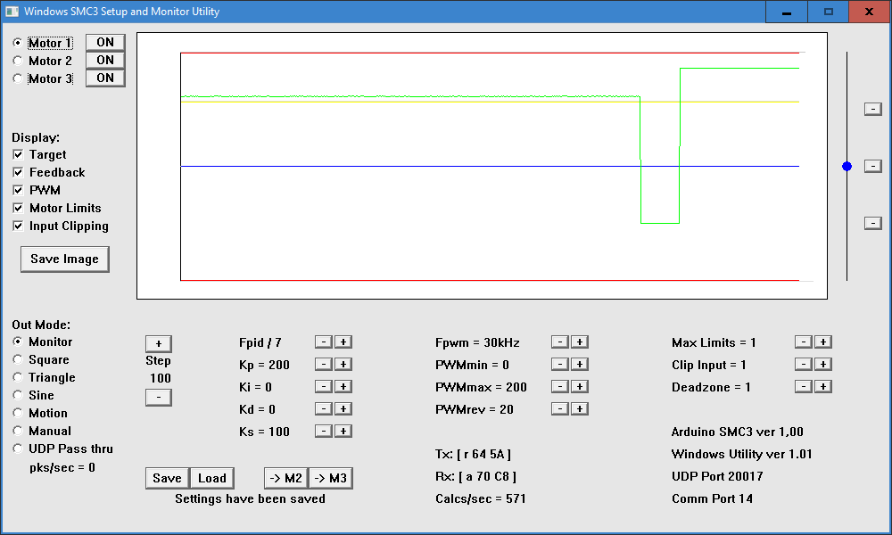

    Here are the SMC3 settings.
    The Kp value with 200 and the PWMmax with 200 are relatively low. But so it still works well.
    At higher values, unfortunately, the motors will be very warm and sometimes switch off the motor drivers.
    I am currently thinking about an active cooling of the motors to increase the Kp value and the PWMmax value.

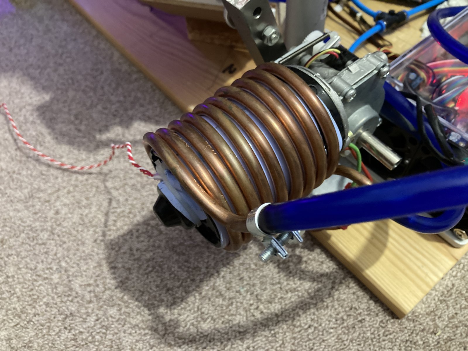

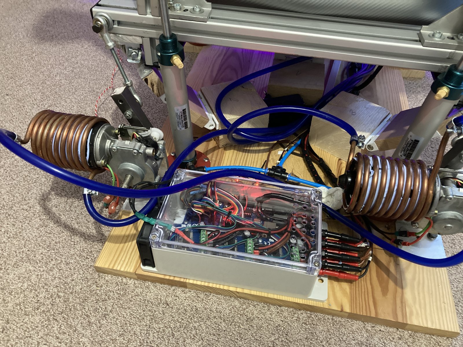

    Hi, yes it works.
    I have now been able to integrate a water cooling system.
    I have rolled copper tubes around the motors. Between the motor housing and the copper tube there is a heat conducting foil.
    The pump conveys the heated water through a radiator for cooling.
    Without cooling, the engines had heated up to over 80°C. With cooling it is now below 40°C.
