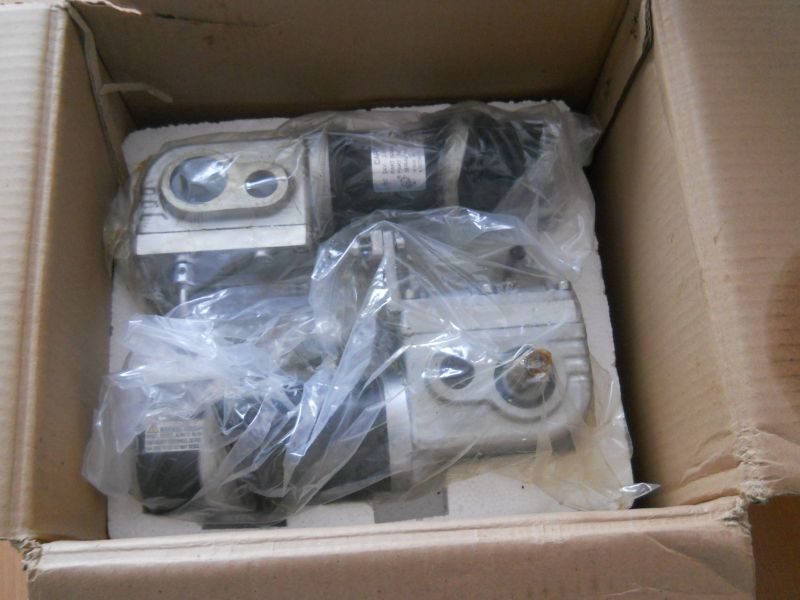

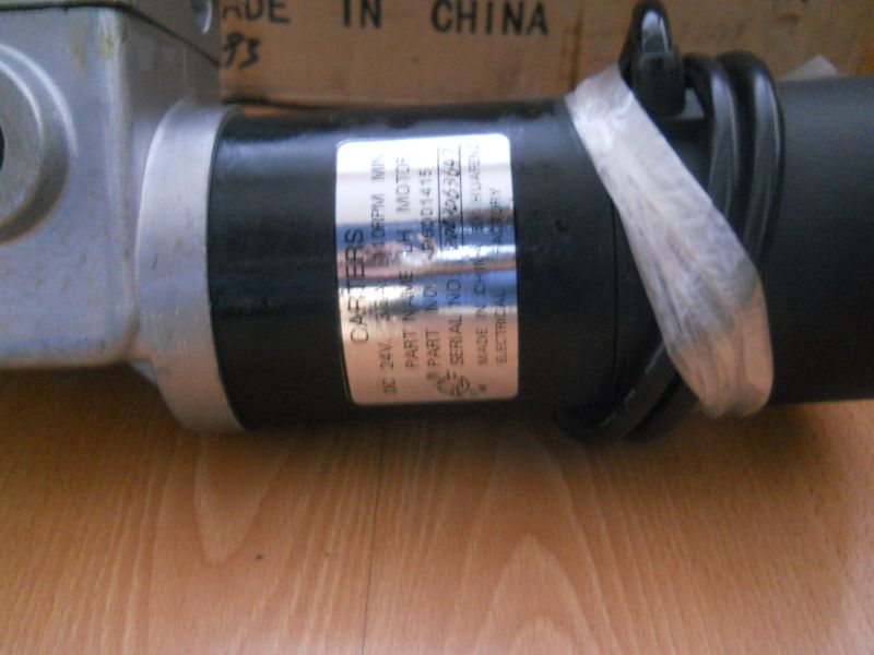

    Hi Guys EBAY is truely your Friend :) on Friday my bid was accepted for 4 brand new Invacare Wheelchair gearbox Motors and when i went to pick up the items the lady had another 2 that she was selling ( i don't think she knew what they were and how much they really sell for ) anyway my lucky day as i now have 6 brand new 24Volts Dc / 3 amp with output sped of 110RPM ,,, Now all of a sudden i have no excuse not to try to copy this Project ( i say copy because merchan-e has done the hard work and shown what can be done) , My question is for some Guidance regarding Motor Drivers , i already Have Velleman Controller Card , Arduino Uno, and Tronics AMC 1.5 & Dual H-Bridge which i built 3 or more years ago LOL. during this time i have bought Ians SP40 Controller card and 2 x MD30 Motor controller which were used on my 2dof FS Simulator and 3 Parvalux PW60 Motor/Gear Box But they only had 8 RPM output lots of torque for the 2 DOF platform but slowwww, and the latest was the Dimension Engineering Sabertooth 2X 60 Controller + Kangeroo unit ,, as you can gather i have all the gear but no idea as they say i keep shifting the goalpost as i see guys here doing great things. This time im cutting metal and drawing up CAD plans to build this 6DOF project .. But back to my Question .. Based on these Motors Which Controller Would you Guys Recommend, Devantech MD30 , or get 2 Sabertooth 2 X 25 Motor controller and 2 more Kangeroo module to go along with my 2 X 60 Version.. For Controllers would Love to Use the Simaxe module But not quite sure where its at development wise ?? i may have missed some post so please ignore my lack of knowledge in that area... Im and engineer by trade so the mechanical element does not phase me , like most builders here for the electronics side i'd like the almost ( i say Almost) plug n play aspect of the Simaxe or Ians New SP64 interface, as they a proven options, i already have the Old SP40 interface but would need to buy the new one so SIMAXE would be great as its support is here.. Thanks guys will post pictures in the next post

    +34 / 0 / -0
    Hi Guys 1st pics of my new toys 2 of 6 :) not bad for £100 uk pounds am i happy or what either way this project is officially kick started

    Hi Wannabeaflyer,
    I look forward to seeing your progress. Perhaps you could start a new build thread?
