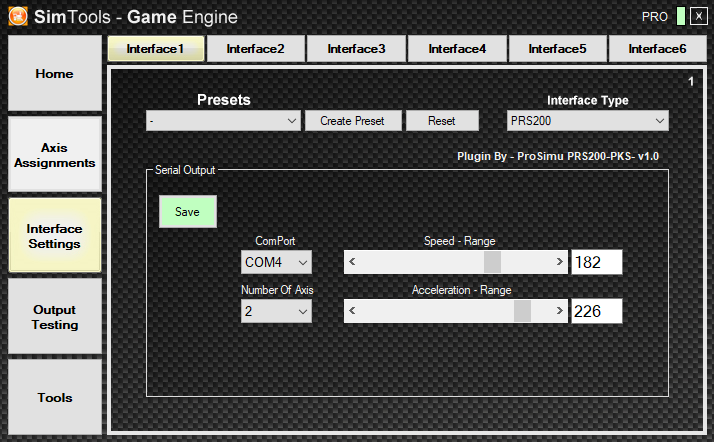

    Followup. I worked with Kevin from Prosimu and he helped me get things squared away. The feel that I'm getting now is absolutely fantastic.

    Care to share the resolution, for the benefit of others?

    Adjust the speed and acceleration in the interface settings.

    @fsutton,
    Do you have scn6's or scn5's?
    May help for people using your settings above.

    Prosimu now mix PRS200 actuators (vertical orientation) with a SCN6 RTL actuator (horizontal)
    Their setup manual lists for PRS200
    Speed - Range 160
    Acceleration - Range 160
    For SCN6
    Speed 10,000
    Acceleration 500
  14. fsutton
    fsutton Member
    Dec 9, 2010
    47
    323Coins
    +21 / 2 / -0
    This is correct. I purchased the PRS200s for the vertical and have an SCN6 (traction loss) for the horizontal. The default settings in their manual list speed of 160 and acceleration of 160 for teh. As you probably already know, these can be adjusted in the interface settings.
  15. fsutton
    fsutton Member
    Dec 9, 2010
    47
    323Coins
    +21 / 2 / -0
    The vertical actuators are much larger than an scn5 or 6. It’s called a prs200.
